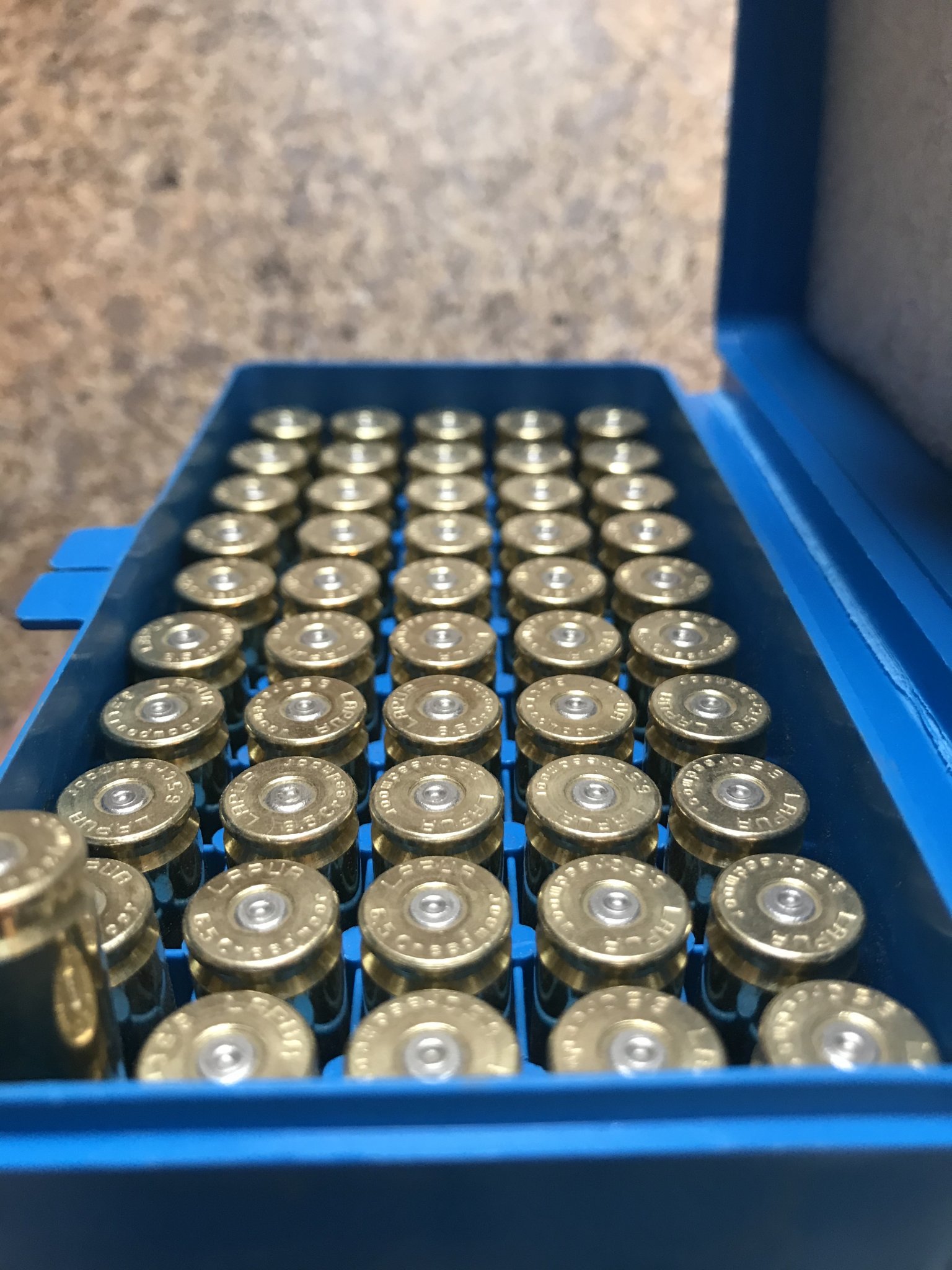

Recently had my 6.5 creed Bergara lrp rebarreled so decided to get Lapua small primer brass and I loaded them up with the lightest charge in the book to form to my chamber but now that I’m going threw them all and all have creators ( while firing wasn’t concerned about pressure cause load was very modest and never checked primers while firing . I should have thou ). I hear I should only use large rifle primer brass , is this true with Bergara actions?

Look at the edges of the primer. Is the cup still round or is it squaring off?
I don't trust craters as a sign of pressure. I've had different batches of primers show more/less at the same velocity on the same load. So long as you're not piercing them I'd just roll with it.
From what I can see of the pictures you're nowhere close to pressure. When the primers start pushing back and flattening is when you've found the upper limits.

Those moons on his brass aren't from a stiff ejector spring. It could be a burr around the hole, but thats why I asked for more info. One of them looks like it swiped some of the L off Lapua, but the picture is too blurry to get a good look.
39.5 grains of h4350 with a 130 gr nosler rdf very very modest load for a 27” Krieger barrel . Load was the lightest in the book to just fire form brass to the new chamber
At what charge weight did you reach pressure? Whats your OAL and how did you reach that number? Was the load data you found in Hornady brass? Whats the capacity difference between Hornady and Lapua? In most cartridges Lapua brass has less capacity than Hornady.

Jab-Yes having a bushing and small diameter pin installed, or the new bolt and firing pin will reduce the primer cratering.
