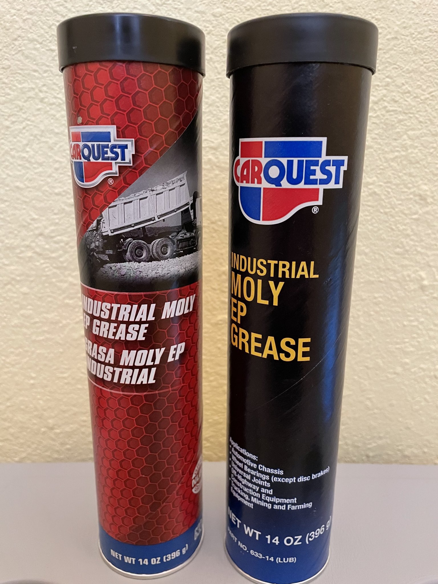

Don’t laugh, but if you mix some STP oil treatment and molybdenum disulfide grease together 50/50, then disassemble and lube all the high pressure points such as the cocking piece threads, the ramp, the lugs, etc. It’ll likely shock you with the difference it makes.

Thank you for the intel, I will for sure try that! The STP is no problem, would you happen to know in which aisle at the Walmart I might find molybdenum disulfide grease?????? :unsure::unsure::unsure::unsure::unsure::unsure: I have Lubriplate, which works great, but I would think that would turn into nightmare of a mess when a little bit of unburned powder gets mixed in?????
Available at an auto parts store.
Powder, grit, exc. doesn’t get much past the lugs of the action unless you are prone to removing the bolt regularly. Cleaning is a non-issue, a blast from the air compressor over a rag removes the most. Yamaha Combustion Chamber Cleaner will displace/remove everything for a deep clean.
