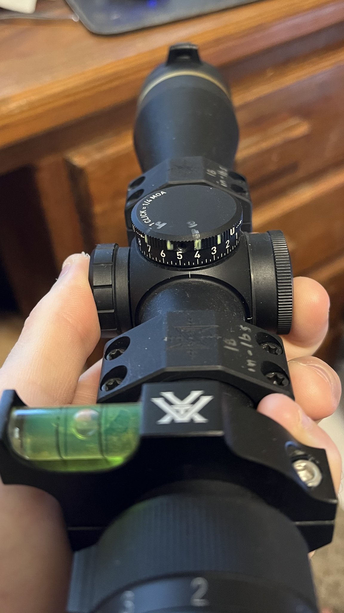

I've never run one with a load-specific CDS dial, but my hunting scope this year is one of the ones that has the CDS option. I decided to have Leupold send me a turret marked in MOA, just a standard exposed turret basically, instead of having it tied to a specific load. I think the way the CDS dial is installed by design, particularly the zero stop (which I think is optional), is pretty MacGyver but it works if you don't yard on it too hard.
The downside of tying the CDS to a particular load is that as soon as you run anything different, or take it to a location with different environmentals, the CDS starts to diverge from the true trajectory at medium and long ranges, so it definitely limits flexibility. However, I think it's fantastic for hunting, where it's one less thing to have to process/remember in the heat of the moment. So what I did this year was:
- Zero at 100yds
- Determine optimum "point-blank range" dial (I'm shooting a 6.5CM so it ended up being 250 yards, point-and-shoot out to 300 would theoretically keep me inside a deer's vitals)
- Bought a little bottle of neon yellow fingernail polish and painted lines on the turret knurling every 50 yards after 250 yards, then took a silver Sharpie and wrote "3" and "4" on top for the two lines at 300 and 400 in case I ever got super lost
I gotta say, even though I never got to shoot anything other than a coyote this year, I ALWAYS knew what to dial to shoot over to this bush or that hillside or wherever, between my rangefinder and those little lines on the turret. I think I'll be doing this every year going forward, unless I really memorize my DOPE for the load; however, I don't think that'll happen, because I'm running a Barnes LRX, and those cost twice as much as my target load with worst ballistics, so I only really shoot the load during hunting season.

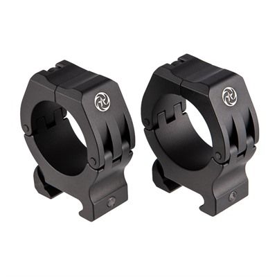

Mounts: I have a Warne Mountain Tech 20 MOA picatinny rail, and a pair of Vortex PMR rings (identical to the Seekins rings). They're either Low or Medium, I honestly can't recall, but which one you pick depends on multiple things. There's a pair of these up for sale right now (link below), although that listing is pretty old so they might be sold already. Another pair just sold this morning though, so they pop often enough.
The Seekins rings are great value, but if could justify changing over multiple scopes to myself, I'd get the ARC M10 rings. Slightly heavier (like, an ounce heavier for the pair) but they're much friendlier to the user when it comes time to mount the scope up. You can use the ARC website (link also below, scroll to the bottom to see the trick with pennies) to figure out what ring height you need if you have the rifle and scope in hand, with the pic rail already on the rifle. That ring height in inches or mm should be true for any scope manufacturer as long as they measure to the same spots, not just ARC rings.
