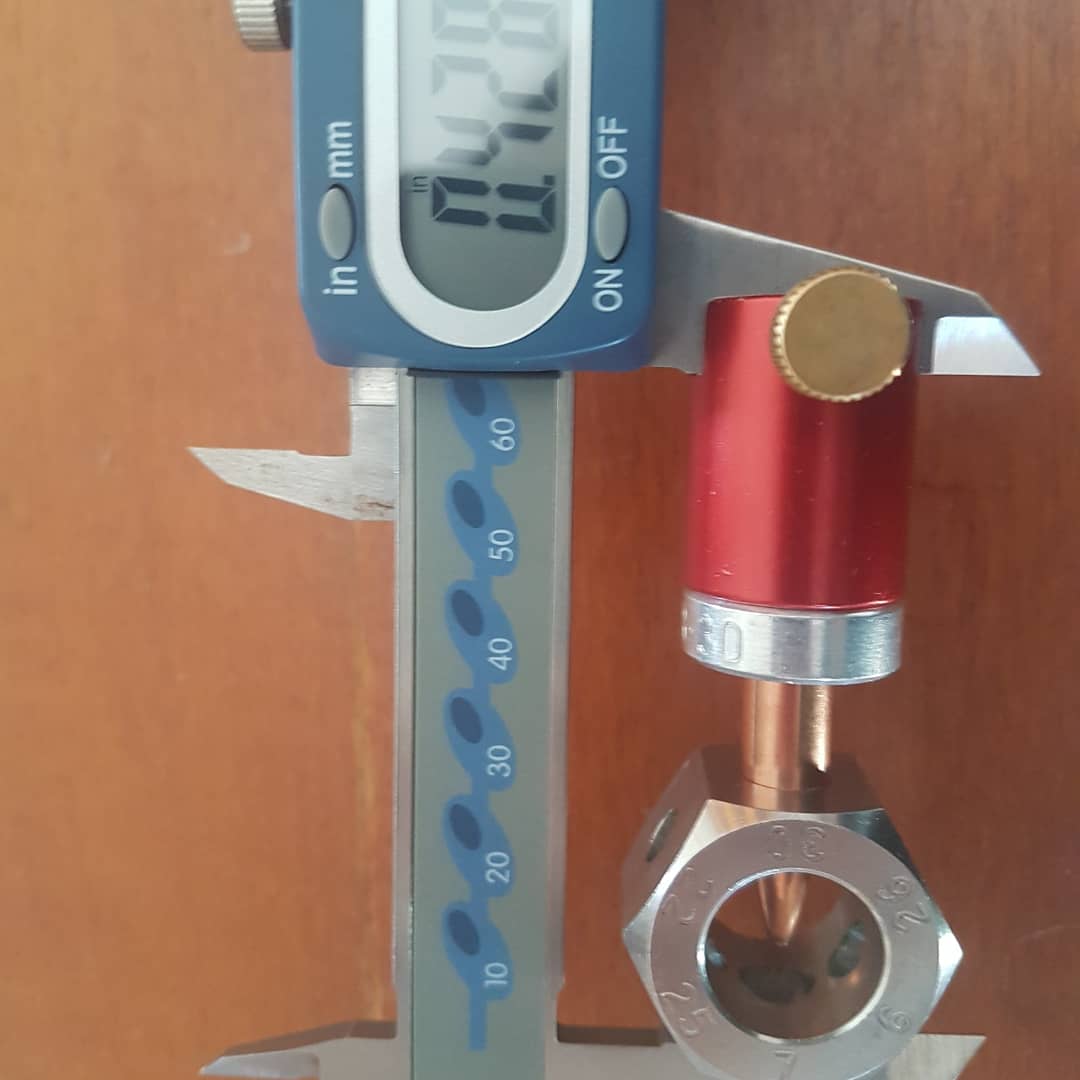

Just opened up a box of berger 6.5mm 130gn OTM's to do some load development with my 6.5x47. I decided to do a bearing surface check to see how they compare to the lapua 136 scenar's i have been using. I found in one box of 100 a 0.015 variation in bearing surface and 0.009 in another box. I thought my calipers gas crapped out so i checked some scenar's I batched out a while ago. They were spot on. Is this the normal tolerances or is something going on. The 185 juggernauts are very consistent and so are the 200 hybrids i use in my 308 norma mag.

How many did you measure, and how are you measuring them?
This has not been my experience.
Hi mate,
This is how i do it using a hornady comparator and a Sinclair nut. I measured a box of 100 and about 20 from another batch i had laying around
