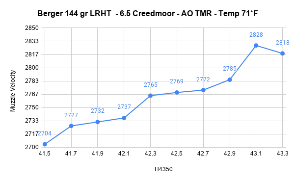

Just trying to see what anyone has been doing with these bullets out of a 6.5 Creedmoor as far as jump?
My initial velocity testing load was all done at 0.020 jump. 2.250 CBTO using Peterson Brass /w CCI450 primers. Used the "10 round load development" method (actually 30 rounds, 3 groups of 10 rounds to make sure I was consistent... pretty happy since all were similar results).
I found a good velocity node at around 42.5 gr of H4350 (ES 6 SD 2) that I'm going to play with.
Maybe try Berger's method of reloading for bullet jumping.
Tips? Thanks.

What length barrel are you running? Why did you choose to not run 42.5? 42.3 to 42.7 looks like a fat node to me?

Oops. Realized it was a typo on the original post. Yep, using 42.5. thanks for the info!

For comparison, I'm shooting a .260 Rem, and I'm also at 42.5 H4350 in Lapua brass with a CCI BR2. I am loaded quite long at 2.960" which is 0.040" off the lands. 26" Bartlein plus a TBAC 30P-1. I'm sitting at 2800 fps average with ES 17 and SD 5.3 for 10 shots. Those first 6 shots were ES 7 and SD 2.9. I just had a quick and slow one after the first 6.
The 144 doesn't mind a seating depth difference in the realm that we typically seat bullets.
