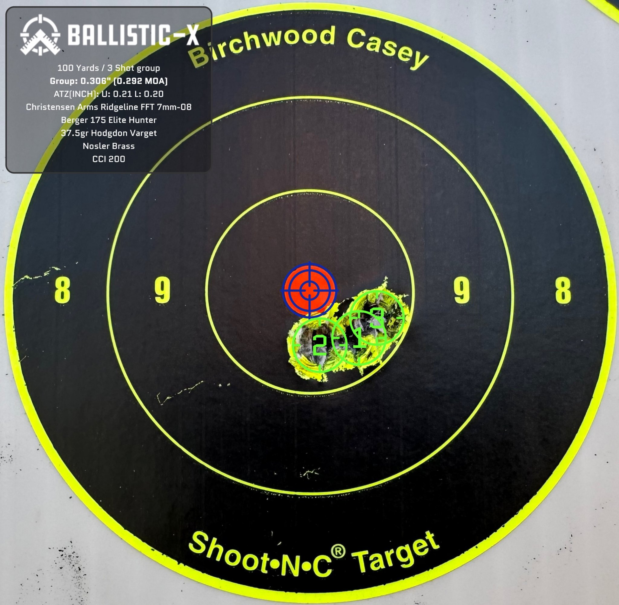

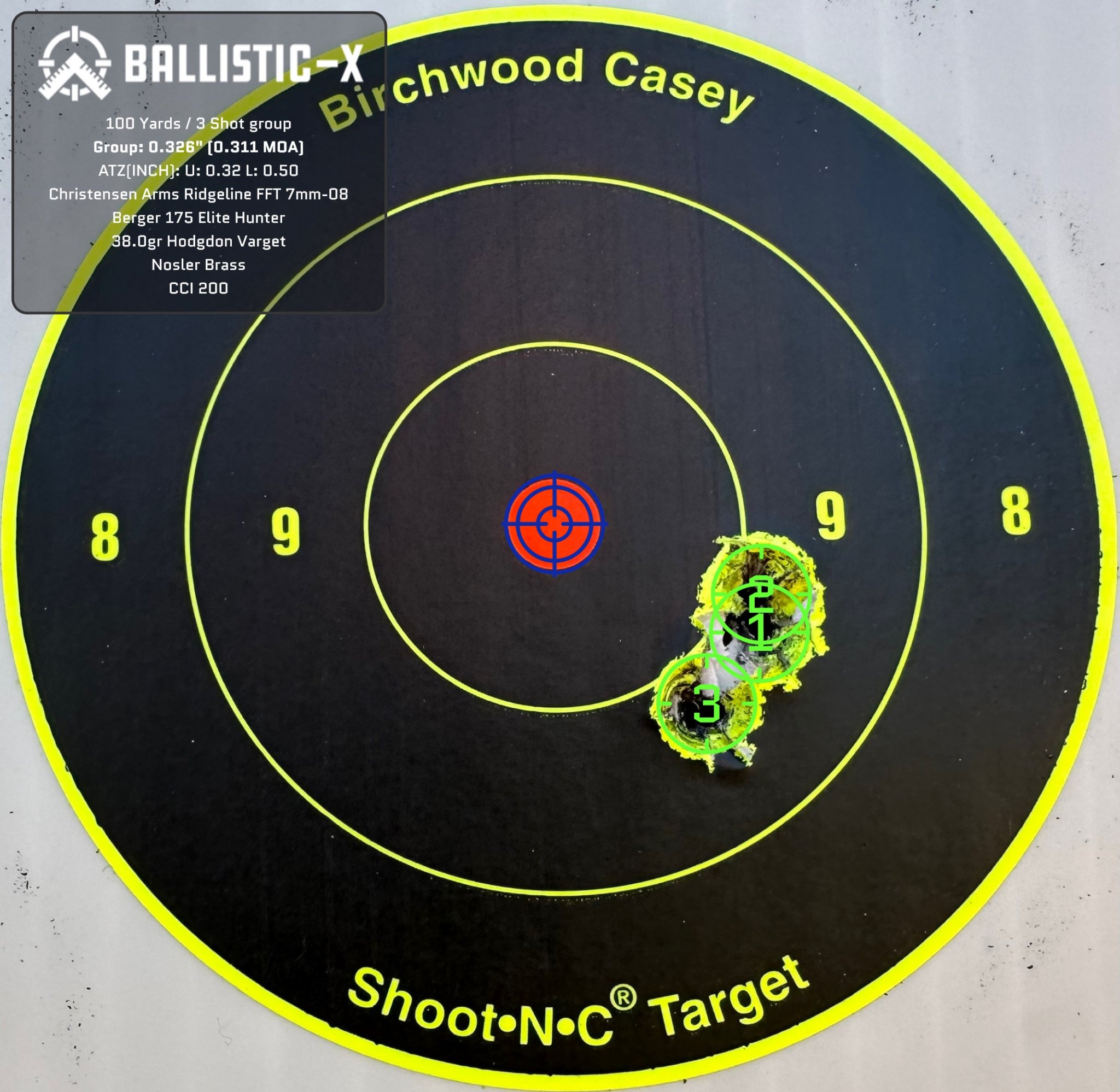

Not quite the same exact bullet, but they are both Hybrid Berger bullets, so maybe this can help? I do shoot the Berger 153.5’s in my .260 Rem, but I load them long, and single-feed them. I suppose knowing this now, I might give a try at magazine-length jump just to see? 🤷🏼
My Berger 175 Elites in my Christensen Ridgeline FFT 7mm-08 had to be seated to 0.130” of the lands. I was really skeptical at first, but then this happened in 3 separate groupings, all within 1.5 grains of ladder testing (apparently I found the perfect velocity node). Now I’m not worried about jump so much with the Hybrid Bergers like I have always been with the VLD’s that are VERY picky.

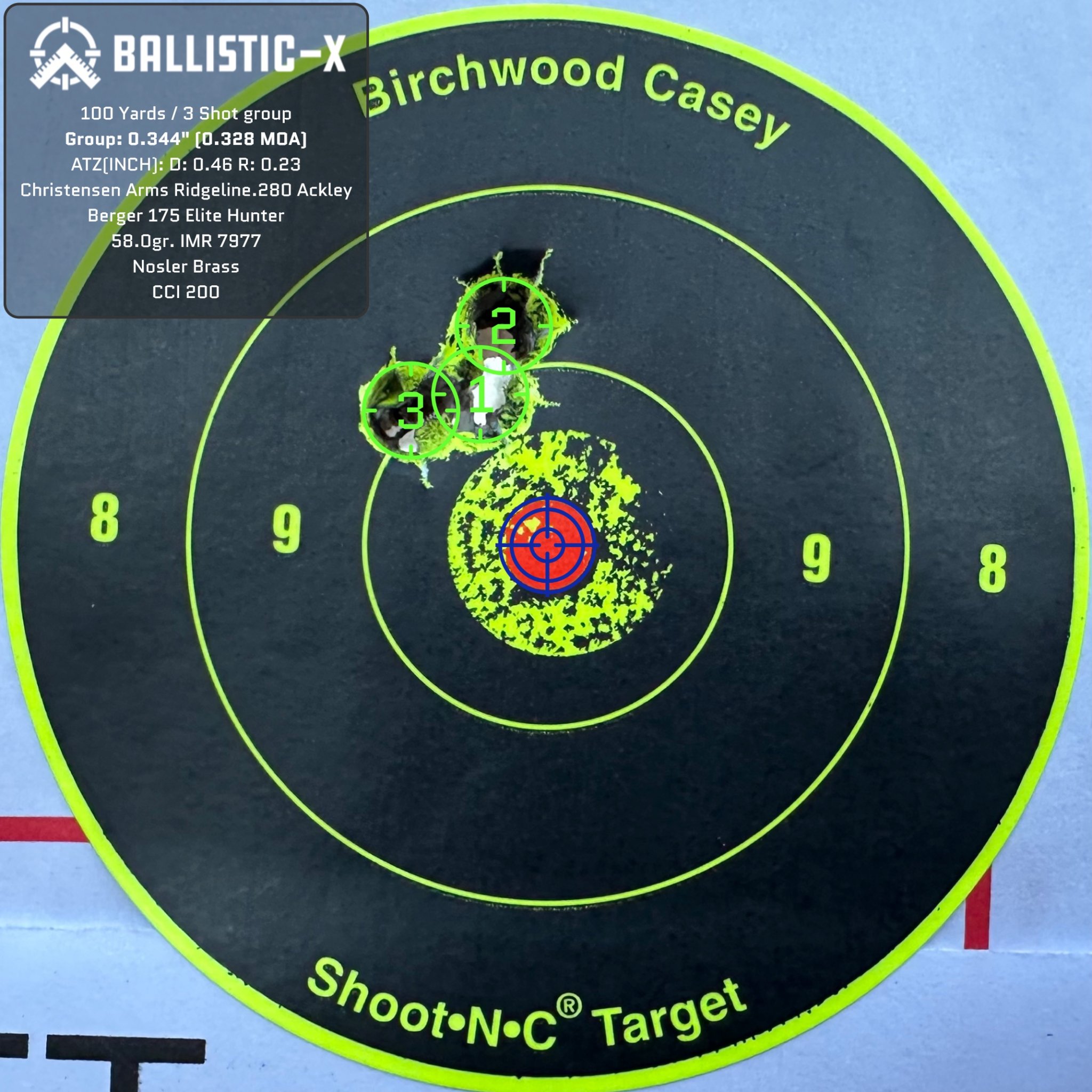

And here’s how they grouped with only 0.010” jump in my .280 Ackley Ridgeline…

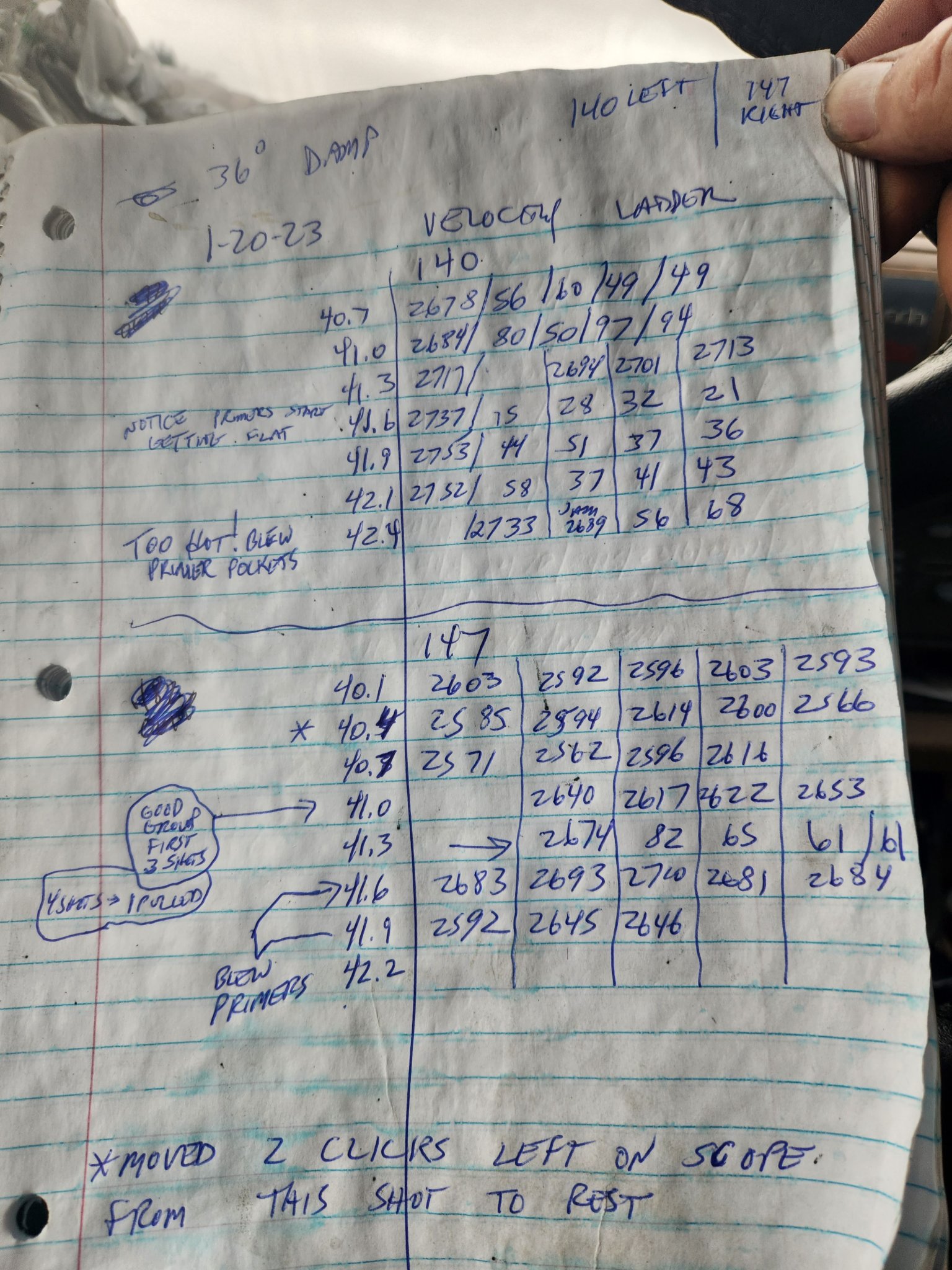

Range report for today. I'm liking velocity node on 147s at 2600 ish for .7 grains... might have to look closer. Play with length to get better accuracy
