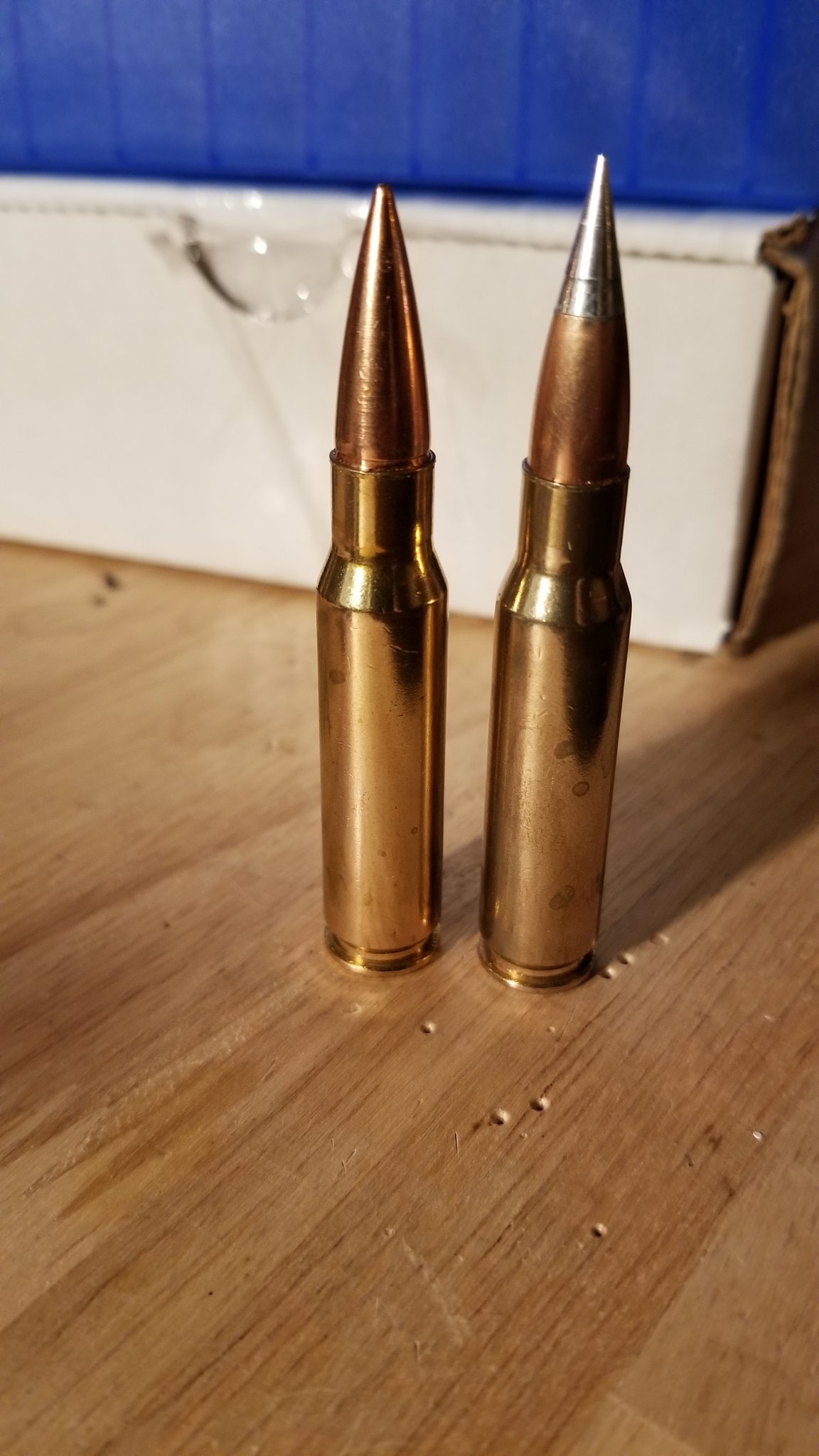

    I took the old 308 out for some ELR shooting today. We shot from 375 my warm up shot all the way out to 1626 which is a far as my scope will dial. It was a great day with the wind at 2mph at max. I am shooting an AI-AE with a 26 in 1-10 twist barrel. The round is as follows;
    Bullet 178ELD-X
    Primer CCIBR2
    Brass Blackhills match
    Powder Varget 42.3
    AVG FPS 2641
    SD 7.9
    COAL is 2.86
