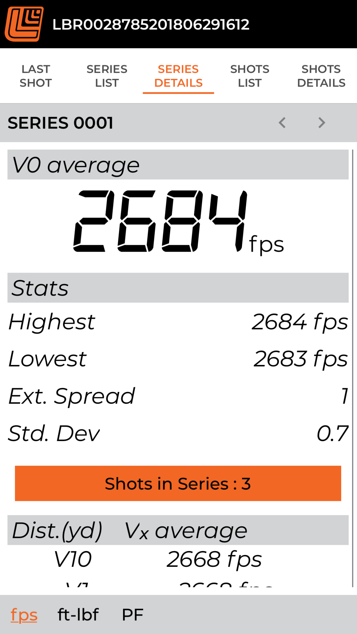

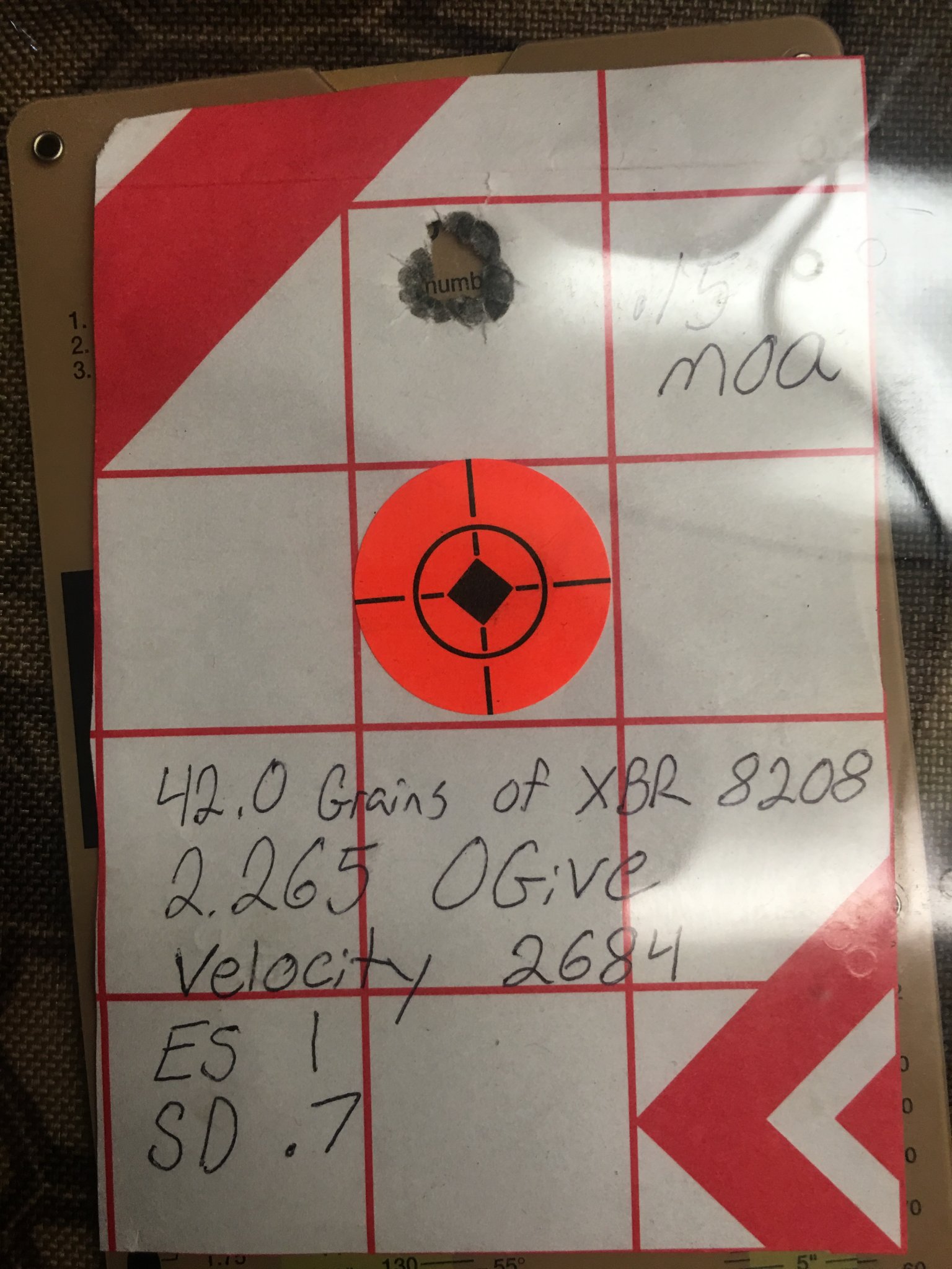

Raised my loads to 42 grains of xbr and I'm getting crazy results. Not what I was expecting in the least using this powder.

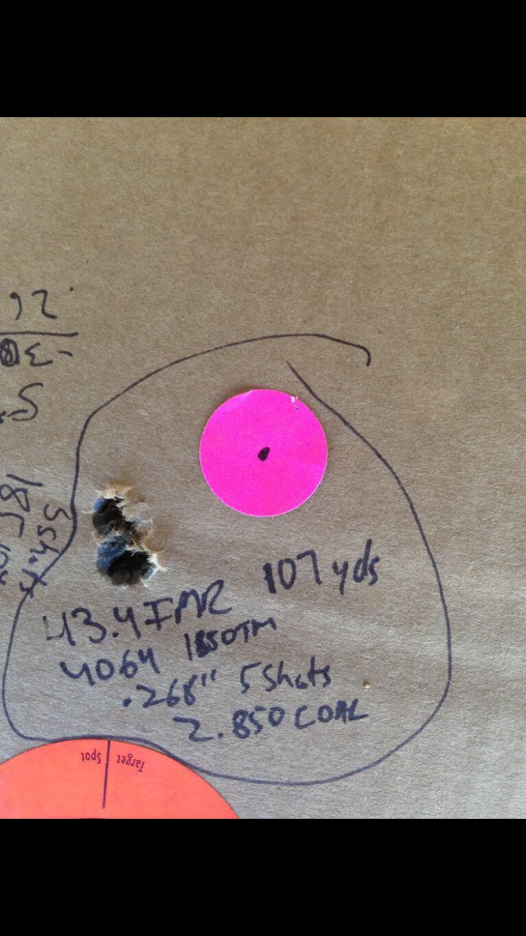

I’ve had extremely good luck with imr 4064 , 43.8 varget, and 44 H4895. Lapua brass. CCI br2 and fgm210 primers.
