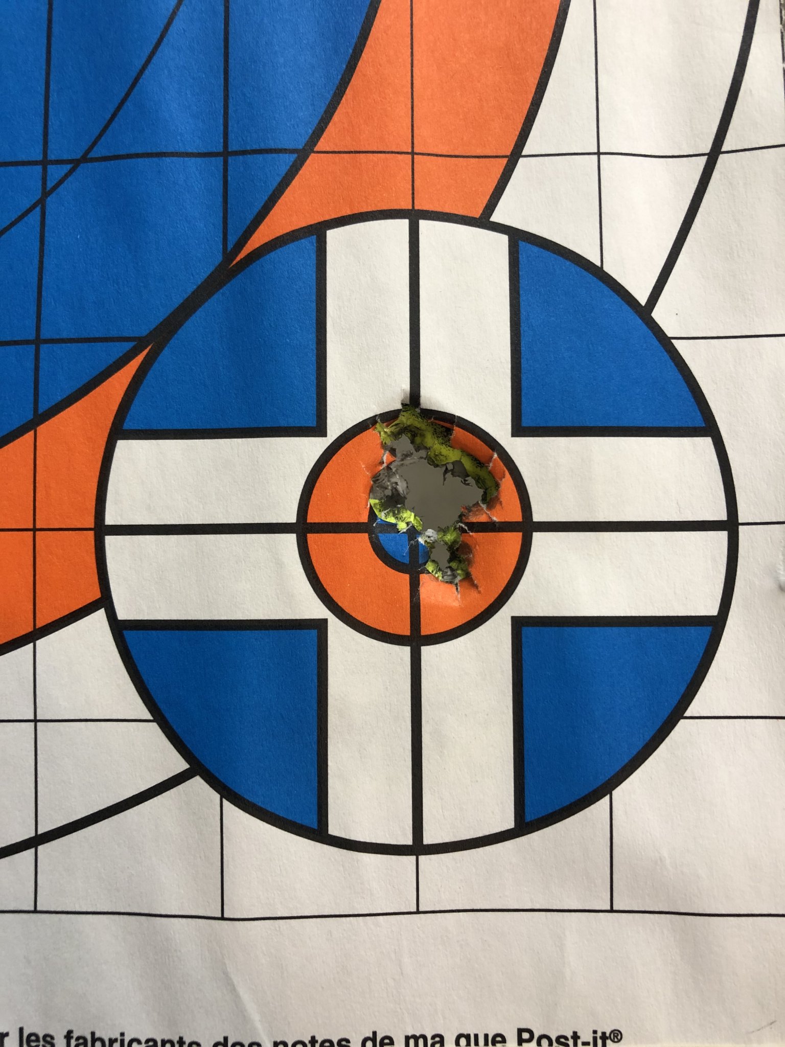

Berger 185gr Juggernauts
Win brass
Varget 44.4
OAL at 2.865 ish ( need to find notes for cbto)
CCI200
2700 out of a 24"brux suppressed (on back half of barrel life)
Shoots well out to 1k for me, not a hot load.
2 panther?
I use 43.5gr IMr 4064 and load out to 2.87. This load crunches a bit so work up. Great accurate bullet
Reactions: sinister and skyrep

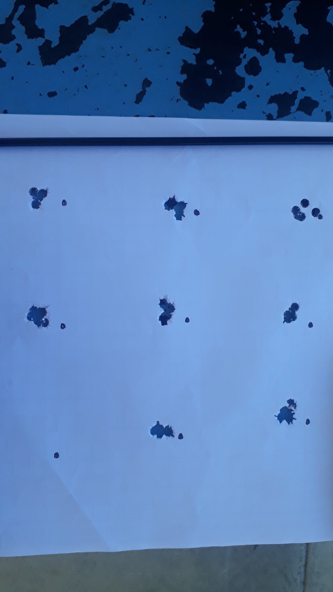

My got to for my 308...
Alpha LRP
CCI BR2
.002 neck tension
.023 Jump
43.7 Varget
2650 out of Hawk Hill 26”
Shoot to 1250 reliably

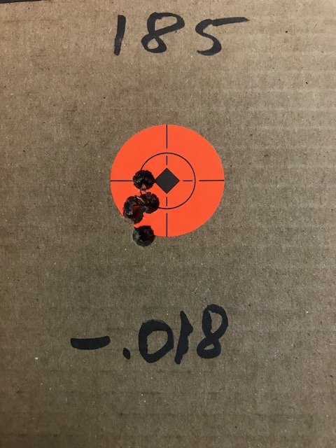

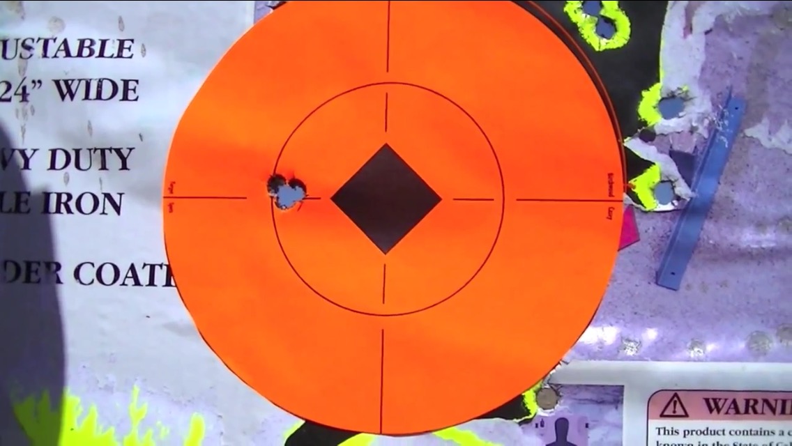

210M primers
185 Juggernauts
Lapua Brass
43.5-44 gr Varget (depends which rifle I'm shooting)
.018" jump
Shoots lights out @200 yrds-600 yrds 1/4-1/2 MOA all day
5 shots at 200yrds last weekend out of a RPR.
Load, pull the trigger and smile!

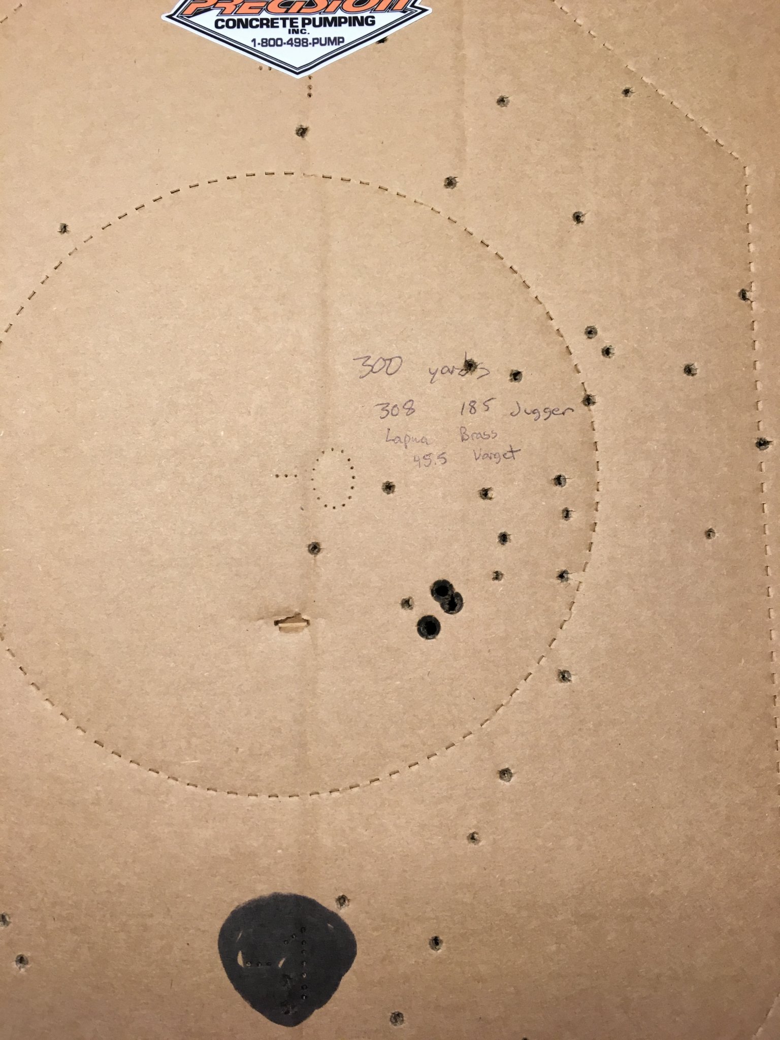

I have shot over 1k Juggers from a 308 win. 300 yards from a Surgeon Scapel Bartlein MTU 1-10! Measured .452 off a bipod and rear bag. Hammers at 1k yards...

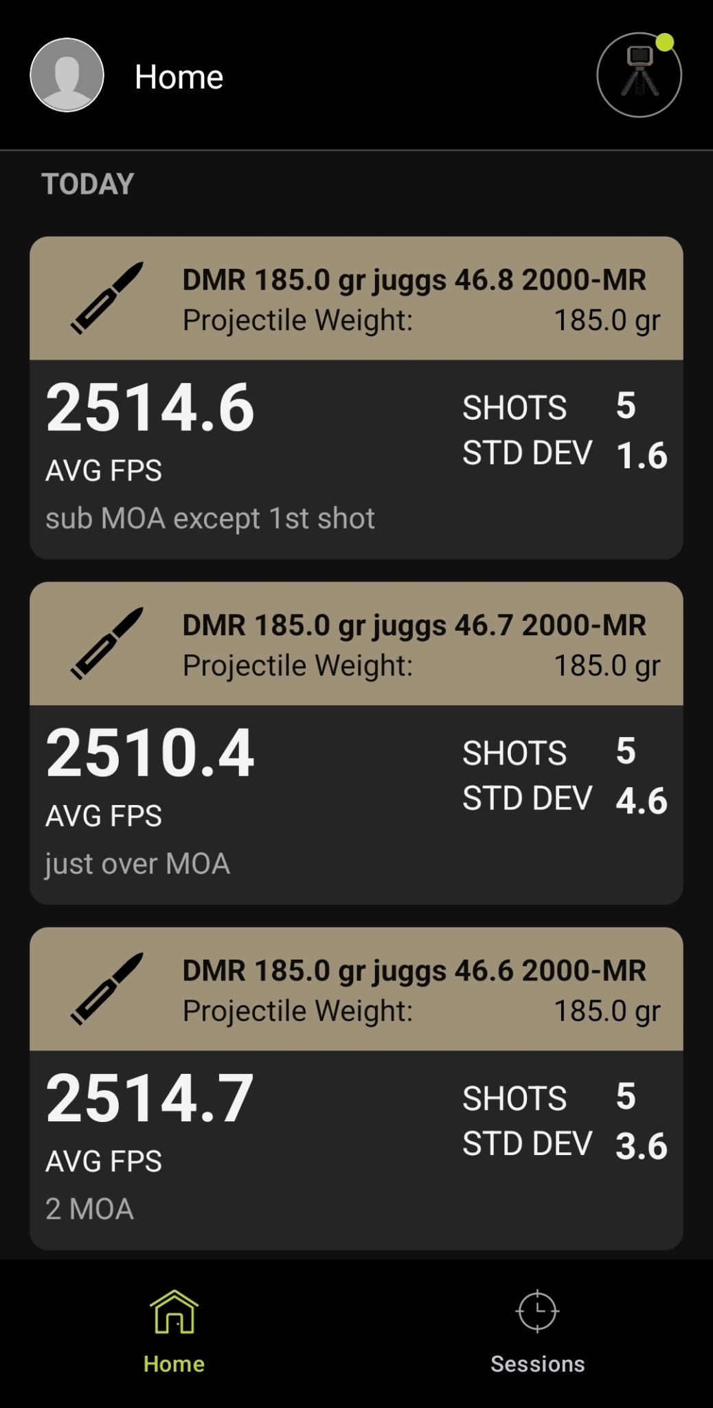

185gr Hybrids + 46.0gr of MR2000 at 2.850" in Lapua Palma 308 brass = killer load in my 308. 2860fps going into bugholes. MV SDs in 5 range.

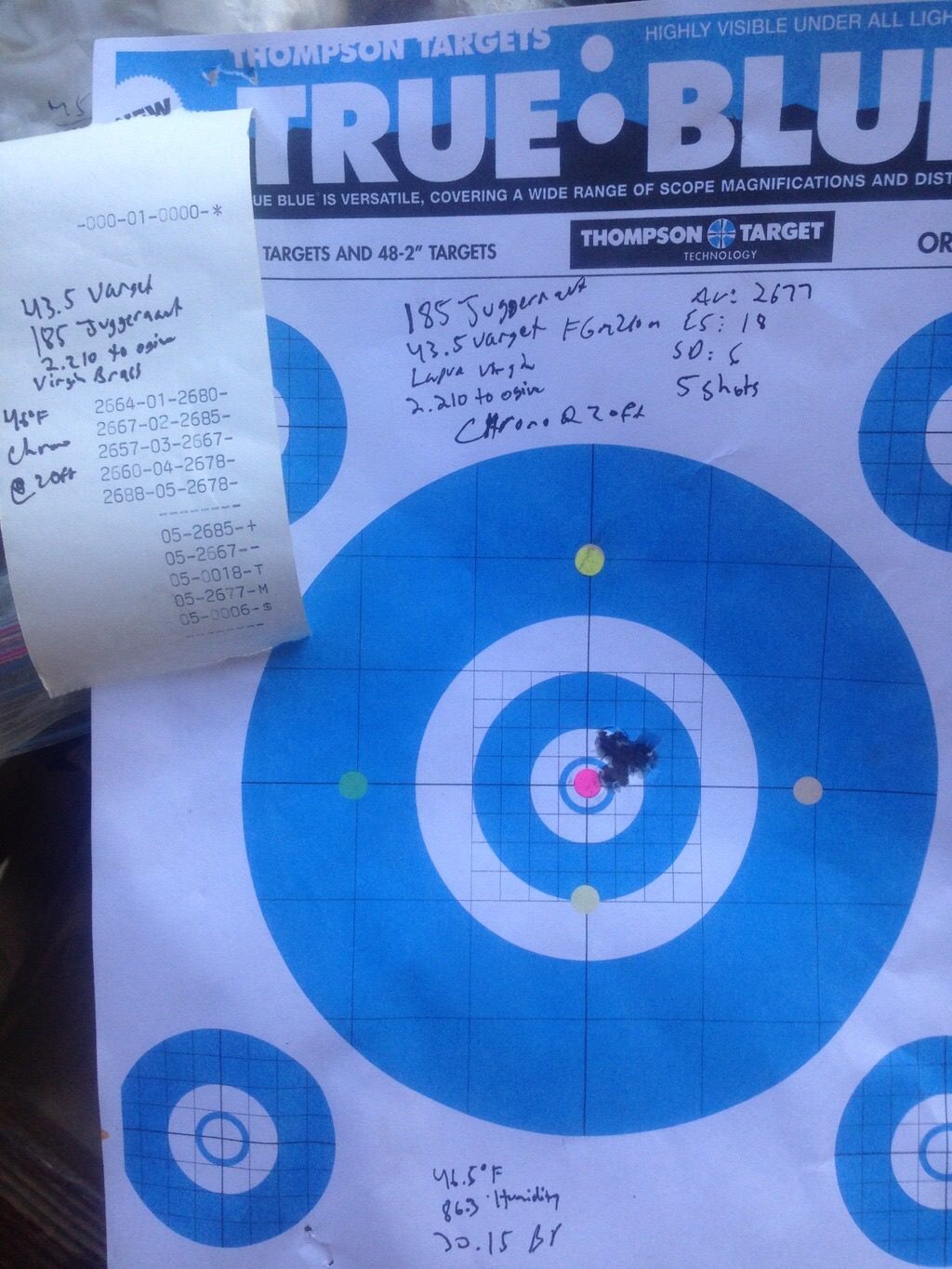

I'm loading the 185 Berger Juggernauts into Remington brass with Remington 9 1/2 primers and 41.7 grains of IMR4064, seated at 2.225" bto.
Superb accuracy and velocities of 2480fps from my 20 inch barrel, and 2600 from my 24 inch barrel.

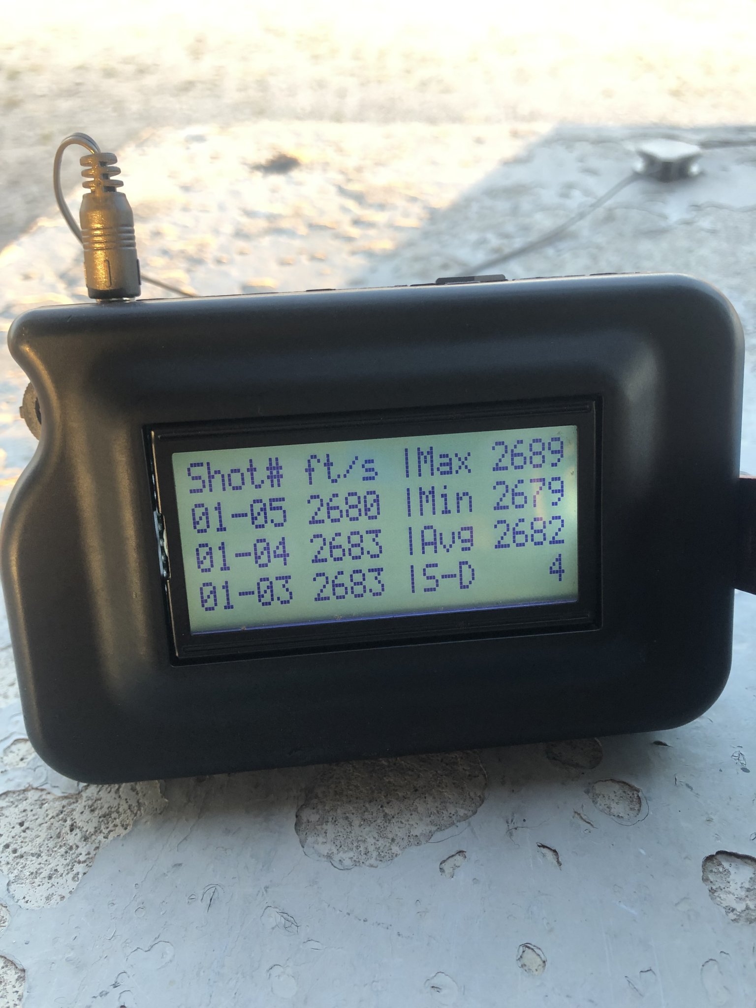

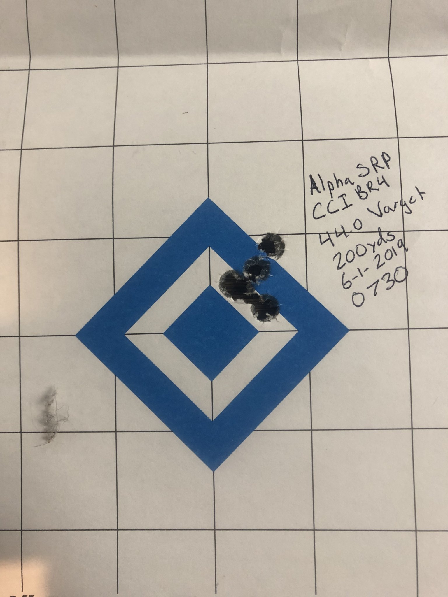

So just finished some testing and here are my results....First thanks to all the members that helped with this process it was a great success and I really appreciate all the help
24 inch Barrel 1:10 twist
COAL: 2.865
Alpha SRP
CCI BR4
Varget 44.0
Average Velocity: 2682fps
SD: 4
ES: 10

Your load is nearly identical to my .308 load. I was using 185gr Classic Hunters and Lapua brass though. Velocity was nearly identical and it routinely shot in .3s to .4s for five shots.
