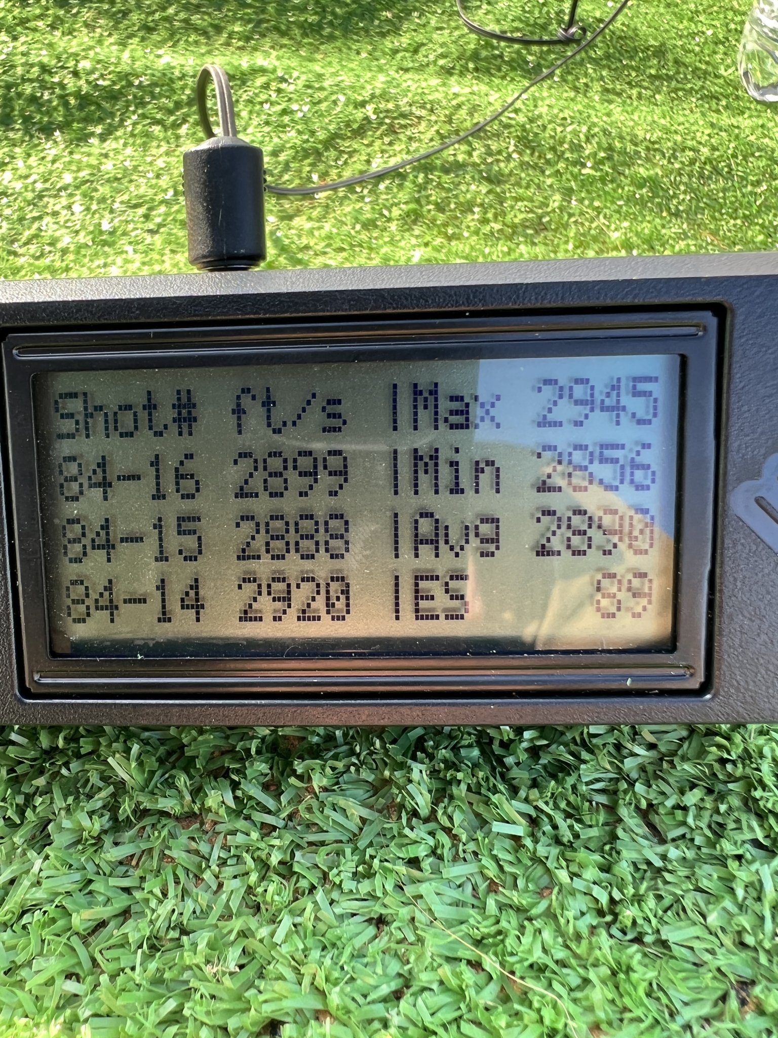

Good morning,
Yesterday was shooting a match with my 26” 223 PRS trainer with factory Berger 77 otm. This barrel has just over 400 rds on it. After break-in this barrel has been consistently at 2850 fps with this ammo. My largest extreme spread has never been over 40fps. Using a magneto v3 chronograph not attached to the barrel. Yesterday I had .5mil variation on targets. I would consistently either below or over target, trying to adjust hold on impacts that were dialed using applied ballistics kestrel. So after match I went to see what my velocities were. Here is the chrono after the match. Anyone else seen this much variation in Berger match ammo?

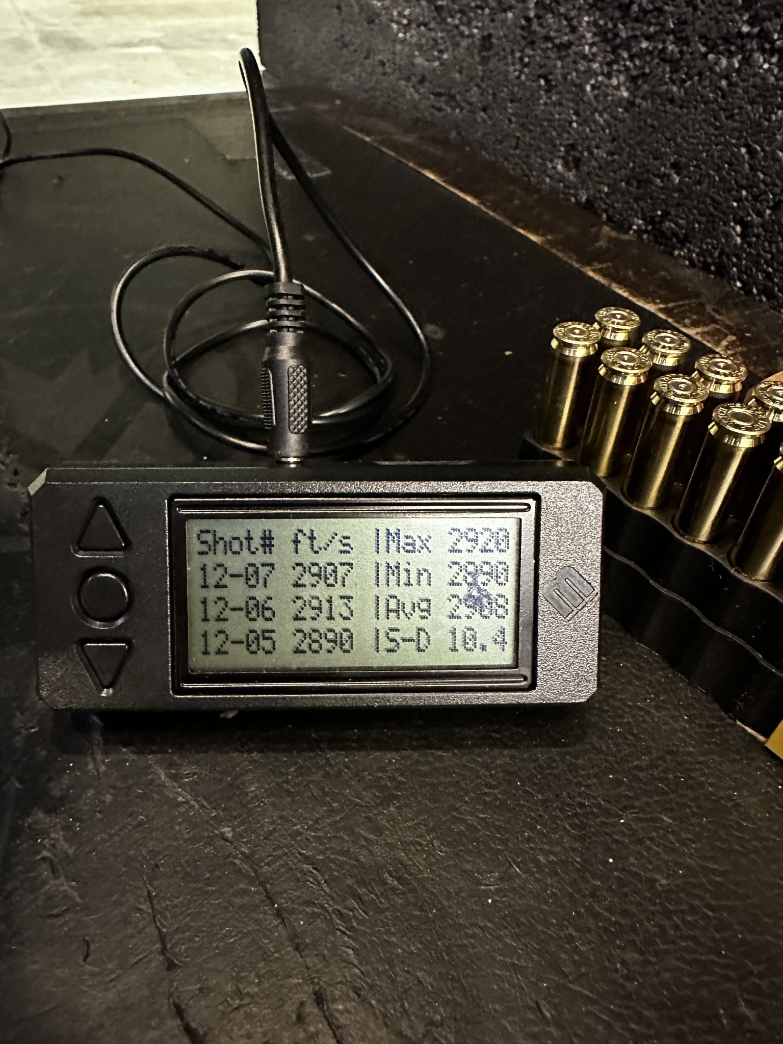

This was with Factory Berger 73gr ammo in my
223. Brand new barrel. It's 80fps than the listed speed on the box in a 22" barrel. ES was 30fps over just 7 rounds.
Not great. But good enough for factory ammo I guess.

Yesterday was shooting a match with my 26” 223 PRS trainer with factory Berger 77 otm. This barrel has just over 400 rds on it. After break-in this barrel has been consistently at 2850 fps with this ammo. My largest extreme spread has never been over 40fps. Using a magneto v3 chronograph not attached to the barrel. Yesterday I had .5mil variation on targets. I would consistently either below or over target, trying to adjust hold on impacts that were dialed using applied ballistics kestrel. So after match I went to see what my velocities were. Here is the chrono after the match. Anyone else seen this much variation in Berger match ammo? View attachment 8024226
Clean it recently? If not see if that brings you back in line. Dragging over cooked on carbon or copper won’t do your numbers any favors.
I clean after every match, should have put that in original post. Also bore scopes it yesterday and nothing notable, no carbon ring and only had 100 rounds since last cleaning on it.
