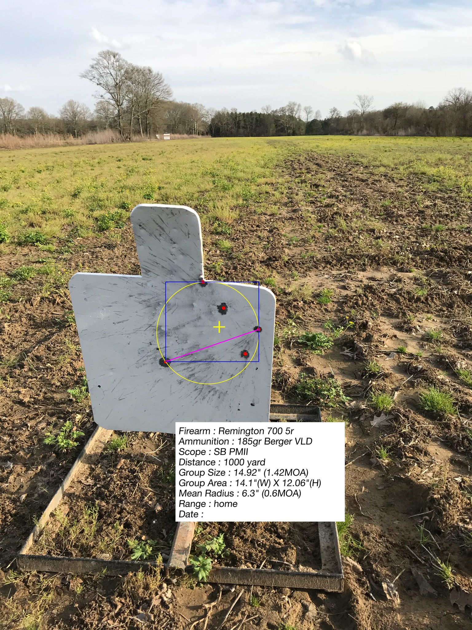

    Is anyone running these bullets ?
    On paper they look like they will hang with the 215s to 1k or so out of my 300 win mag. Only tested at the range so far, but I had no trouble getting an accurate load at 3100 fps.
    The 185gr vld hunters are great. This was at 1k today with my .308.
