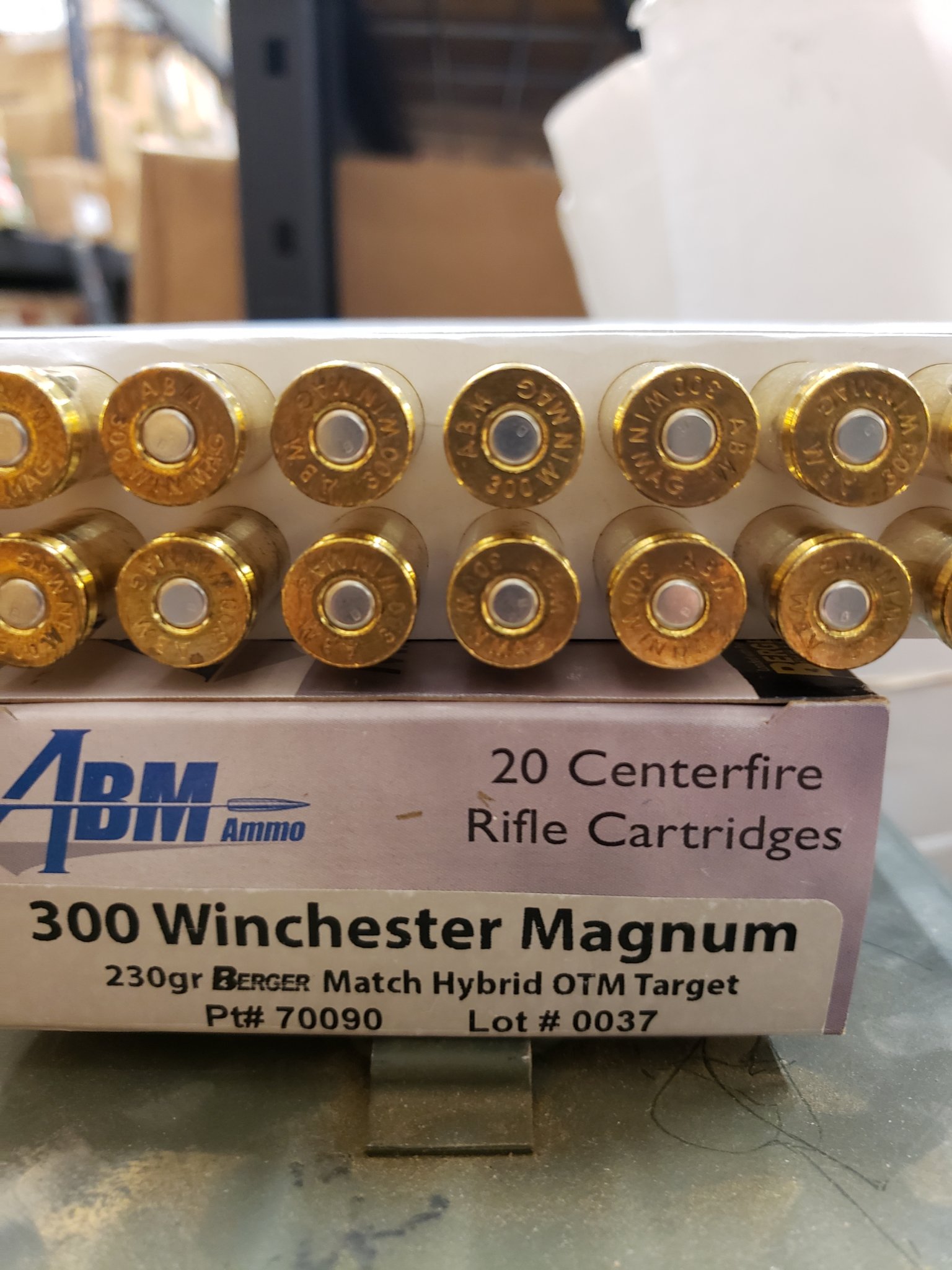

The 800 rd. of ABM 230gr 300 win mag I have. Has it's own headstamp
But it may have changed at some point in time.. may be time to compare lot numbers lol
ETA:
Or maybe they where using Norma brass labeled ABM ..

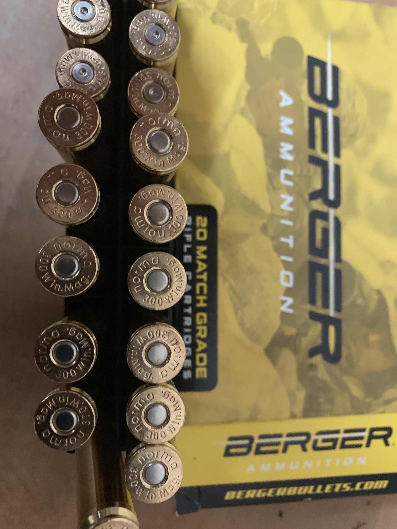

and yet, in checking 3 diff calibers:
Berger 300WM 215s - Headstamped Norma

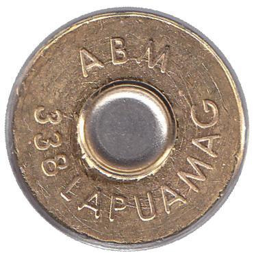

ABM 300NM 230s - Headstamped Lapua
Berger 338LM - no name, some small logo that I'm not familiar with
Yes I’m sure they have to switch brands around depending on what’s available. I think that Norma is one of the only high end brass companies that actually does the belted magnums. That’s probably why Norma is the brass of choice for berger. I do wish that Lapua and even Peterson would do 300 WinMag.
