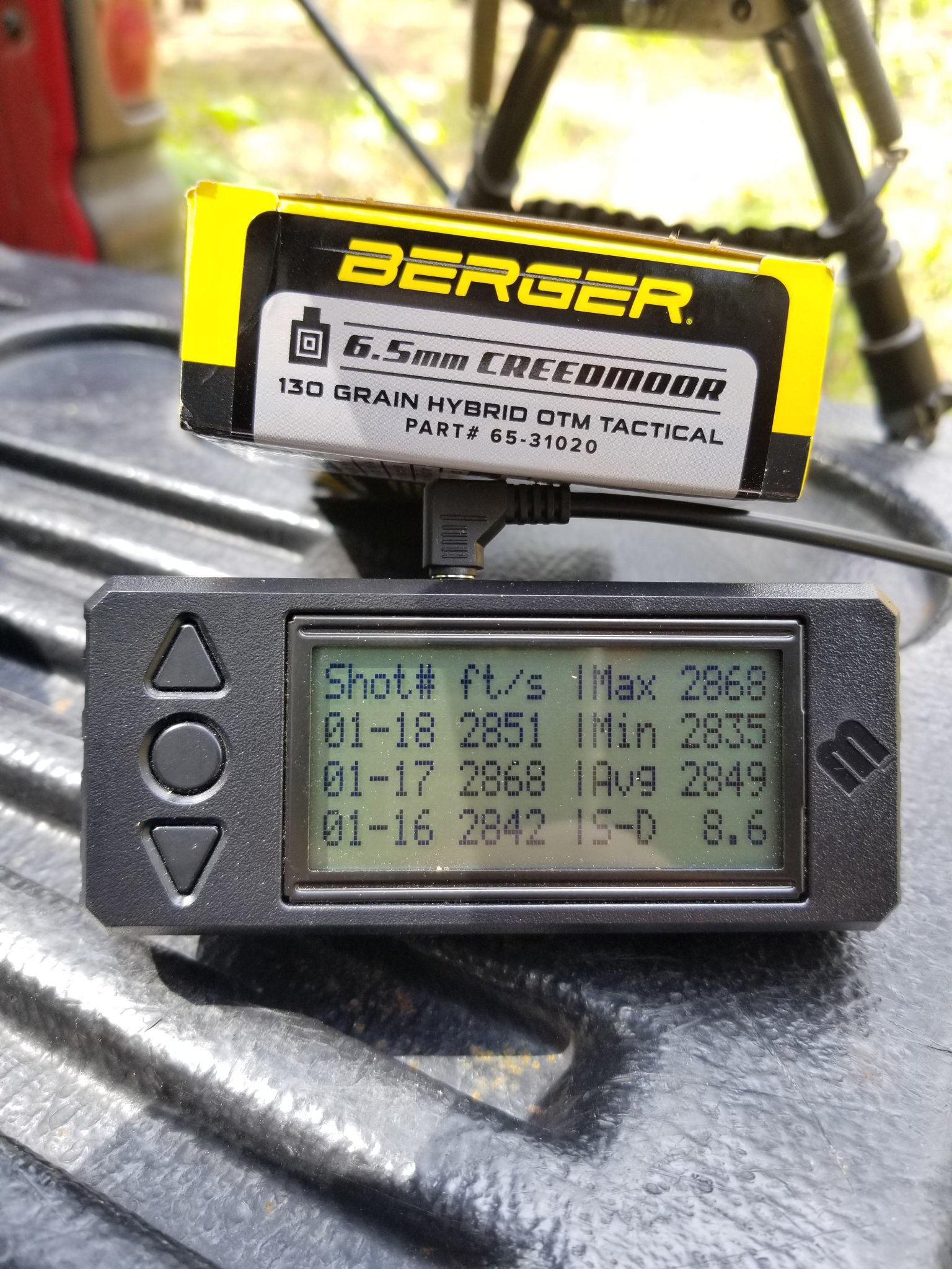

I just shot up my first case of the Berger 130 OTM AR Hybrid 6.5 Creedmoor. Avg MV of 2743 FPS out of my 20" barrel suppressed. Feeds great. No issues whatsoever. I'm consistently getting 3/4 moa groups at 100, but I suspect if I was a better shooter it would be tighter. SD was 15.5 and ES 47 over 13 rounds as measured by my Labradar. I'm actually really happy with this for factory ammo considering I'm getting Lapua brass out of the deal.

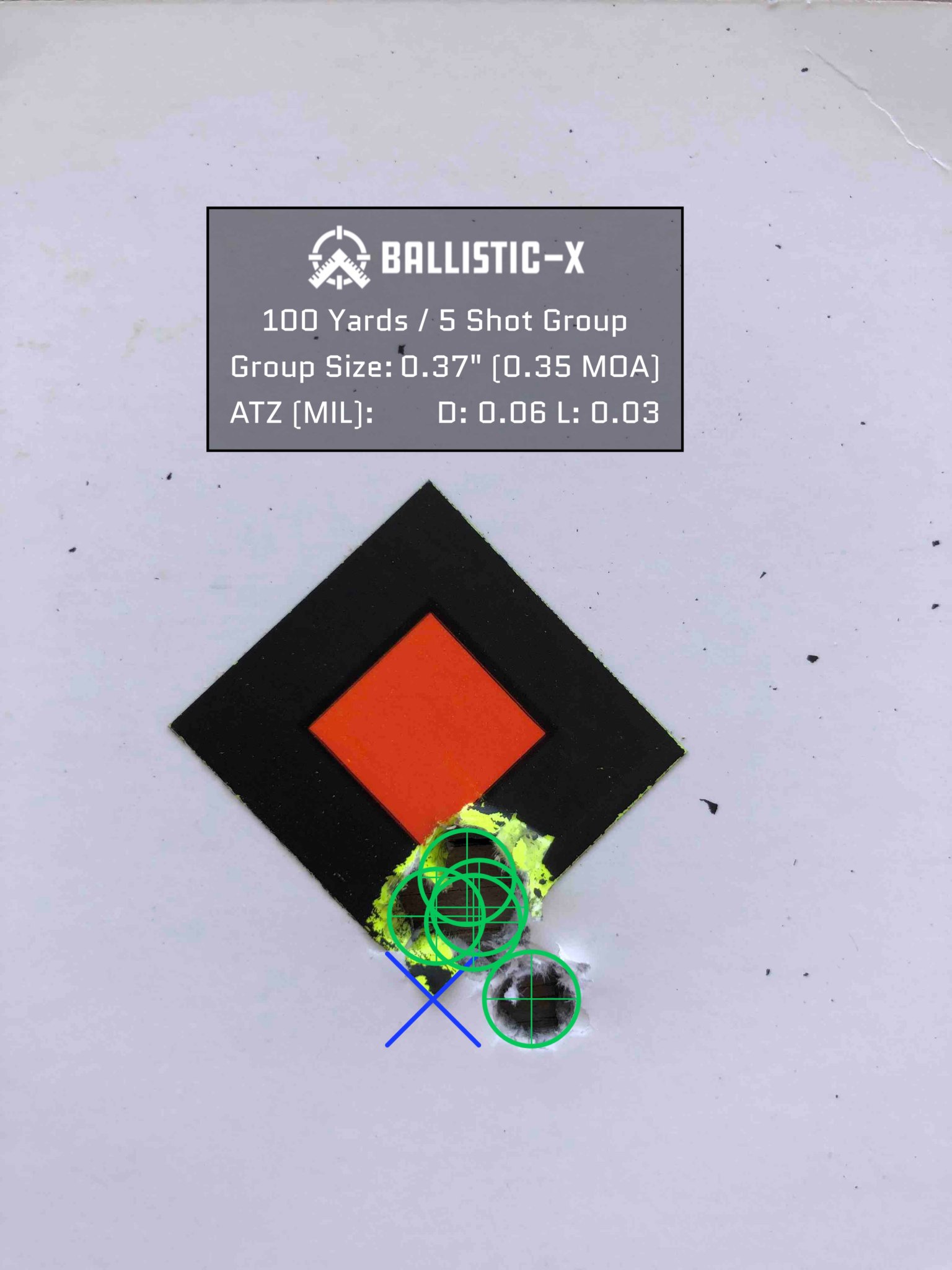

I have been through about 700 of the Berger 6.5CM 140gr VLD Hybrid Target. I just picked up another 400. SD’s have all been high single digits and ES in the 20-30 range. This offering is extremely impressive. All shot through a factory AI 6.5CM 24” barrel suppressed. Muzzle Velocity has been 2820fps

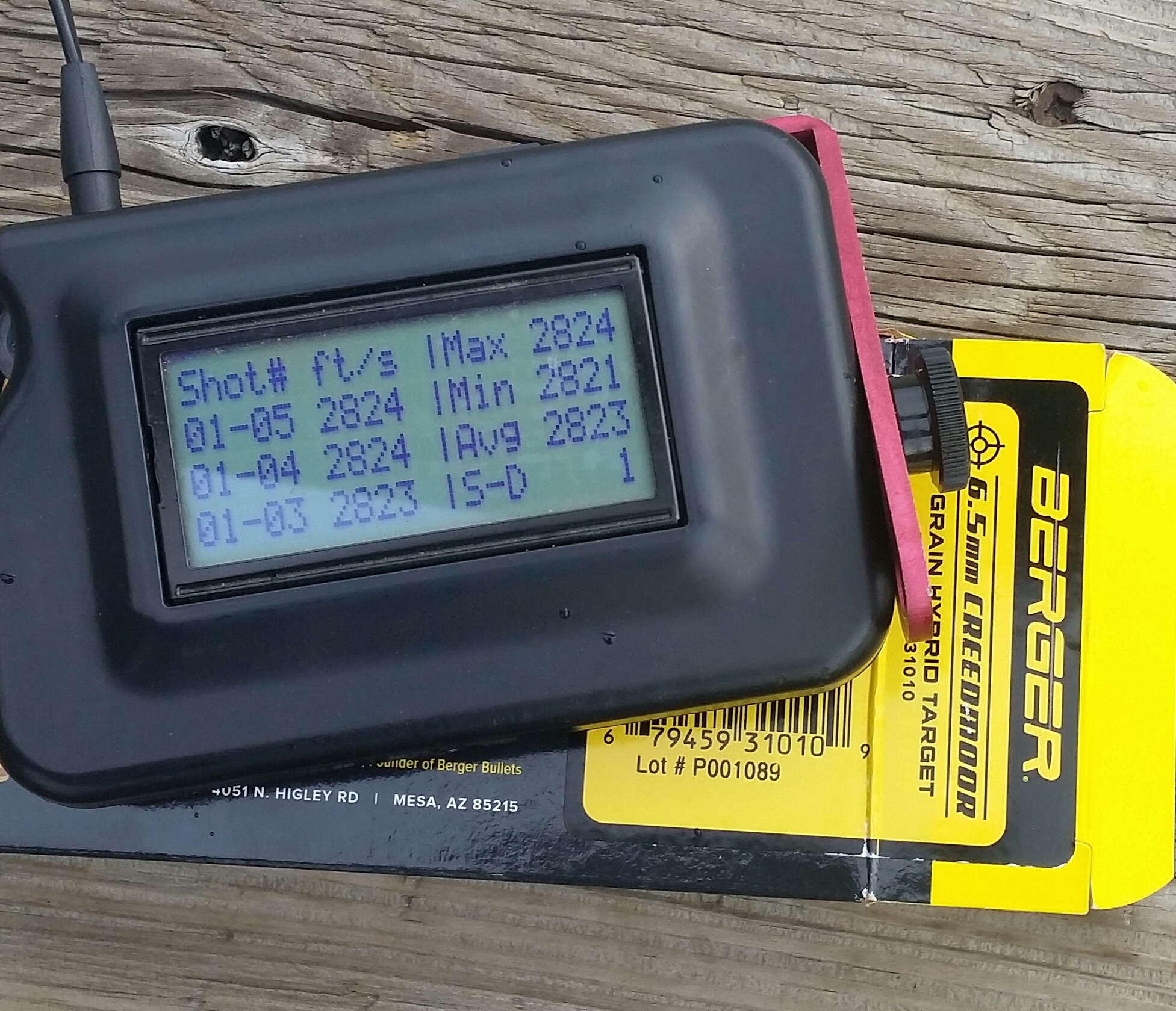

Has anyone chronographed the factory ammo? Their web site doesn’t show advertised velocity, as far as I can find. Thanks!

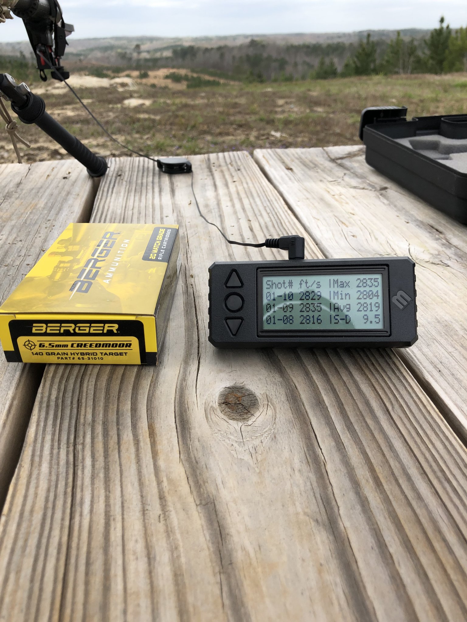

This was the 140 hybrids from a 25" Bartlein saami chamber with 1700+ rounds through the bore.

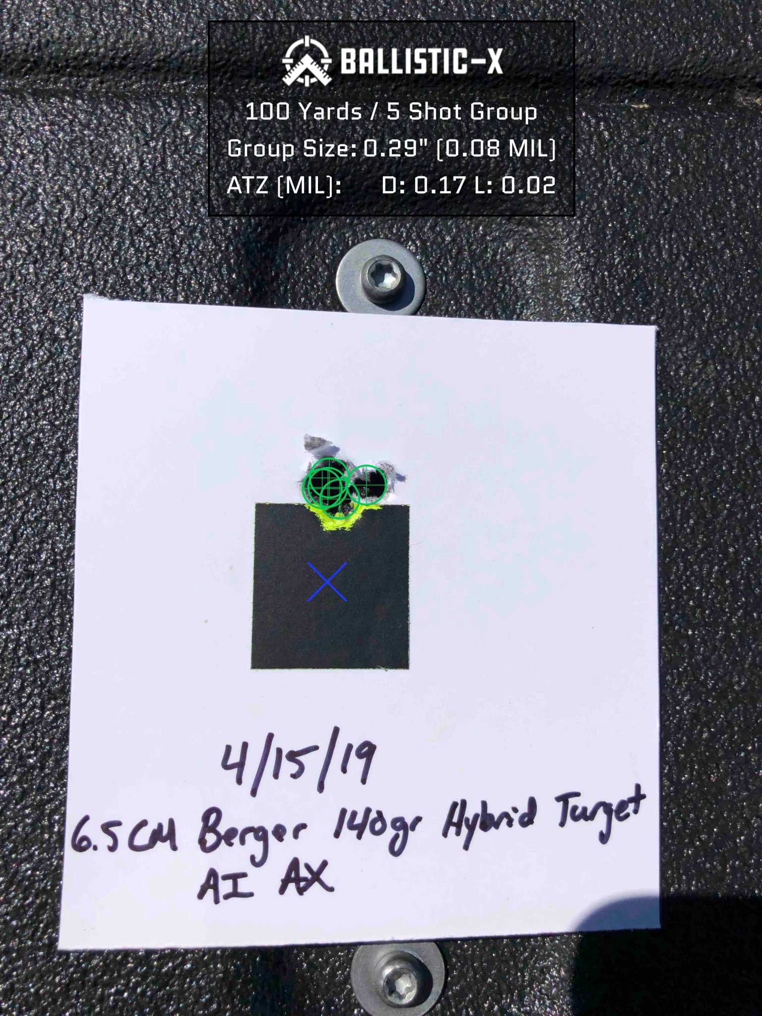

I was in the market for some new Lapua brass and since my load is with 140 Hybrids I picked up 300 rounds of this factory ammo. Chronoed 3 groups of 5 and had an average of around 2805 with an SD in the 8-9 range. This is in an Accuracy international AX with factory barrel. They ran about 40fps slower than my handloads but my zero was pretty much the same and the first 5 out of the box before I put the chrono on grouped really tight so these are looking very promising. Probably some of the best factory ammo I’ve ever shot.
Exactly the same experience I had through my AIAT and AIAX
Has anyone checked this ammo in different temps? I originally had a velocity of 2773 @ 23* then it went to 2870 @ 65*. Not sure if it was all ammo temp change or if there was some barrel speed up mixed in there.

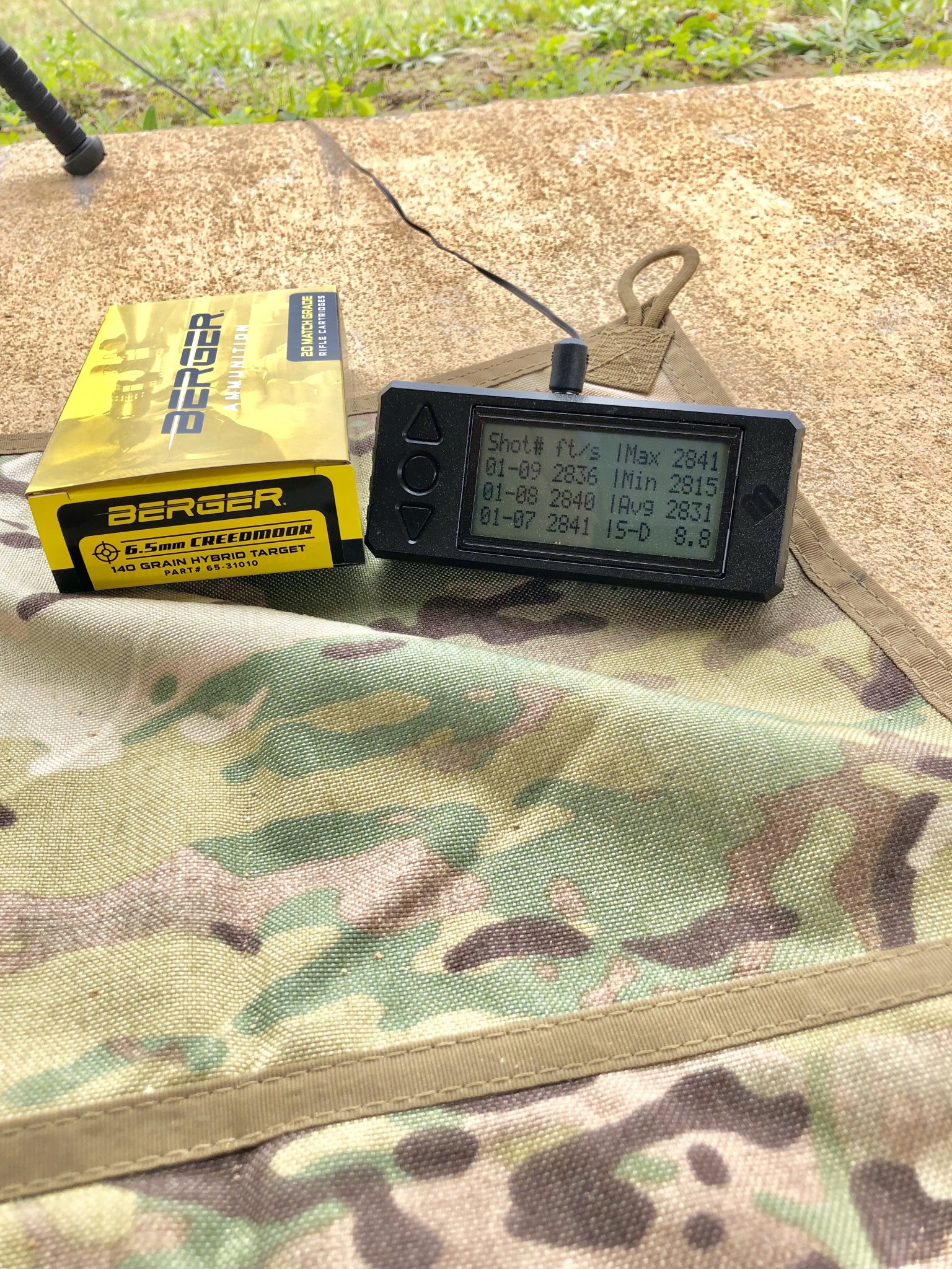

I have run the 140gr in 20deg F temperature swings and it has always been extremely close. I dont have my data book in front of me but 50deg F it was 2810fps, 70deg F 2820fps, 90deg F 2830fps. Previous post #39 shows 2820 and 2830fps.
