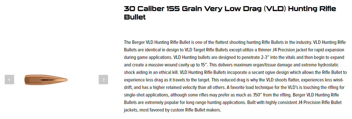

    Loaded up some Berger 155 grain VLD bullets this morning, part number 30508, and using a Hornady comparator I'm having a tough time getting an accurate and consistent ogive reading. Anyone else notice this? I think the ogive is so gradual, it doesn't get a good seat on the ogive die and I find the case is "cocked" to one side of the caliper base or the other. Never experienced this with any other bullet.
    Is there a better tool for measuring ogive on bullets that have the same sort of construction? Berger's usually pretty consistent length wise but there's always variation. Plus, with compressed loads using say Varget, I want to make sure the ogive measurements are all the same. Thanks in advance!

    Most Palma match bullets are on the order of a 9 caliber ogive or thereabouts. They don't tend to favor a magazine fed semi-auto chamber.
    They were specifically designed to get a 308 above sonic at 1000 in a Palma barrel.
    That version you picked is just that Palma bullet with a lighter jacket to call it a hunting bullet.
    All of which makes it more delicate, which doesn't favor a magazine fed semi-auto application, or being pushed down on a compression load.
