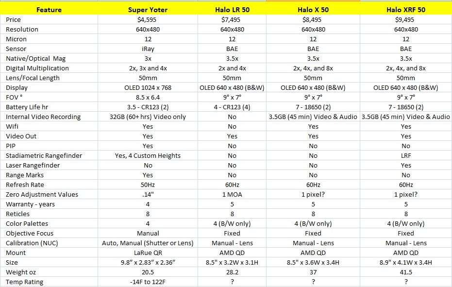

I haven't used a Trail 2, Thermion 2, or Pro version from Pulsar. I have used both Trail and Helion XQ and XPs. From the original XP and XQs, the Yoter R has a better image. Since you mentioned Trails, the Yoter is lighter, smaller, less expensive, includes a LaRue QD mount, and has a 4 year warranty. It includes the new Range Marks feature which is a great new feature that lessens the need for an LRF. On the Trail side, I would say an integrated battery, LRF, and audio recording along with video would be the main advantages.
For those wanting a wider FOV, the XP50 has a bigger FOV than the Super Yoter (SY) while the SY has a slightly bigger FOV than the XQ. I will be hunting with a Super Yoter this Fall/Winter. Since there is a limited supply of SY prototypes, an exact answer is going to be hard for someone to provide between the Super Yoter and a Trail 2.
Since the Super Yoter is only available to a limited number of testers, it will be hard to get head to head comparisons for awhile. However, I put together a chart comparing them from a specifications standpoint.
You mentioned Halo LR but I decided to include the newer X and XRF as well. For info I couldn't find, I put an ?. If anyone has the specs on zero adjustment values for the X and XRF as well as their temp rating, I can update the chart.
Be nice to add manufacturer location, company HQ and warranty repair location and mean time for repair.
Does the Yoter use rechargeable batts? Another data point to add.
Does the difference in display size add to the Super yoters picture quality ?
My Thermion XP38 has the same display size and I like how the display fill's the whole eyepiece, not like your looking at a postage stamp that's set back inside the eye piece.

Have you had the chance to get behind a nox35 yet? I know it's kind of apples and oranges but the 35 and yoter is what I would be choosing between if I go dedicated wmt. The halo weight especially the x models is a deal killer for me.
Bering thermals are assembled in CA and TX depending on model and service the same. Most major service happens in CA while firmware and some other changes happen in TX. If someone has that information for NVision, feel free to add. Mean time for repair I don't have that for either but I can tell you Bering service has been fantastic and from everything I have heard so is Nvision. Night Goggles is just adding NVision to our list of products so I don't have as much information.
The image and clarity in the lens is fantastic on the SY. I can't say if it makes a difference that it has more resolution than the sensor does.
The Yoter (and Hogsters) is rated to handle CR123s, rechargeable CR123s, and 5V 2A battery packs. Although they are rated to use rechargeable CR123, Bering does not recommend the use of rechargeable 123s due to the lack of consistency and common usage of chargers which over-charged batteries providing excessive voltage. If you add recoil to the mix, and batteries leak, catch on fire, etc inside the scope, it could be bad. I use the TRB battery pack from Night Goggles and it lasts me 12+ hours.
I thought my Thermion was heavy at 26 oz's, but the X35 I'm seriously looking into getting, weighs 37 Oz !
I like the 18650 batteries the X35 uses, but I'm also from NY and a Yankees fan from birth, so buying something made in Massachusetts is a hard pill to swallow.
If the SY used anything but 123 batteries or an external batt pak to power it, I would've been the first one on the horn with Tom ordering it.
I thought when I stopped using Pulsar, I was going to really miss their proprietary battery packs. I personally haven't. Yes it adds one wire/cord, but with a good setup, I don't even notice it. It also allows me quick access to connect to a PC to download files without having to plug and unplug the device or rely on slow wireless transfers. Check out this video at 1:14. On this video, I show how the battery is part of my scope/rail combination. This works great on an AR, but wouldn't work as well for a right-handed bolt but there are other options.

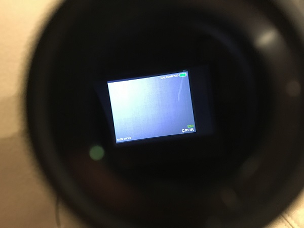

I recently watch a video of yours and you mentioned that the sun can damage the lens, what kind of damage are we talking and is it prolonged exposure or instant?
Seems easily avoidable, just cover the lens when not looking down rang!

With any thermal, you don't want to point any intense light source directly at the objective. This includes the sun, lasers, etc. There should be no damage by an instant exposure say as you sweep through an area to shoot a coyote. However, I wouldn't have the scope facing up towards the sun, or another example is watch the location in a vehicle so there isn't a direct exposure to the lens, etc. If you get high intensity light damage, you very well may have permantly damaged your thermal. If it was a quick exposure, a manual NUC should clear the screen up.

What is an example of the damage, ie spots on screen, less clarity, less thermal sensitivity… ? Just curious.
Really depends on the type of exposure. I would say more times than not it is a big spot on the screen that is darker or lighter that won't go away almost like the lens is dirty. I have attached an example of one I have seen personally. Look at the jagged line in the upper right hand corner. That would not go away no matter how many times this thermal was NUC'd.
