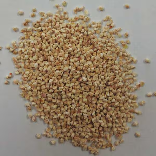

1) As several have suggested, I am trying fine media after sizing brass. I went with “fine” 24 grit from Harbor freight and it still gets stuck in my 6x47 L brass flash hole. Not many - maybe 15 out of 300, so not a real big deal, but I still have to check every one of them. Is there a better choice of media or is the Lapua flash hole just so small or is Harbor freight stuff poor quality?

Yes, HF media is low quality.
There are some brands of ground walnut media that are marketed to other purposes than cartridge cleaning that work very well and are less expensive than the ones designated for us. One was called Zilla Desert Blend, but I haven't run this in a while since my local pet supply place closed.
There are some folks who have tested leaving media in flash hole to see if this affects the performance. I know it sounds counterintuitive, but it has been tested many times and has no ill effects.
I have the same OCD about my reloads that doesn't want to see media stuck in flash holes, so I just use stuff that doesn't do it.
As far as the need to wipe it off, I am going to assume that since you have the HF grit size problem you probably also have their dust problem. When you get decent quality media, they have removed that dust to a large degree. You typically don't need to do anything after you run the brass through the media separator.
I will suggest the following to if you want to try to use this media. See if you can locate a sieve of the right mesh and screen out the oversized grains. If you take the media outside and pour it from a height where a small fan can hit the stream as you pour, you can play with flow to allow the grains to drop while the just the dust is blown away. Then take the tumbler outside to a well ventilated area where the dust don't matter and run it with the lid off for a while with the fan blowing over the top. This is what we did back in the stone age but it ain't worth my time so I just get good media.

If it helps, in the shop I used an 18/40 mesh (400/1000 in microns) set of sieves to classify the size of the tumbling media grit with walnut or corn cob. (Don't go bigger than 14 mesh if you run Lapua or small flash holes.)
Dry vibe tumbling was as much of an art as it was a science and we used it for many topics. There are folks in some operations that are so specialized that tumbling and vibe polishing is all they do. They were wizards and their black magic would amaze you.
I don't bother with this at home any more cause it is just too easy to get decent quality dry tumble media without the hassle.
If you are curious and just want to learn to do this, sometimes you can find the sieves cheaply at industrial surplus sites as us dinosaurs are going extinct.

Zoro Select 20 to 40 Grit corn cob blast media is $43 for a 50 pound bag. You'll never have to worry about clogged flash holes again.
