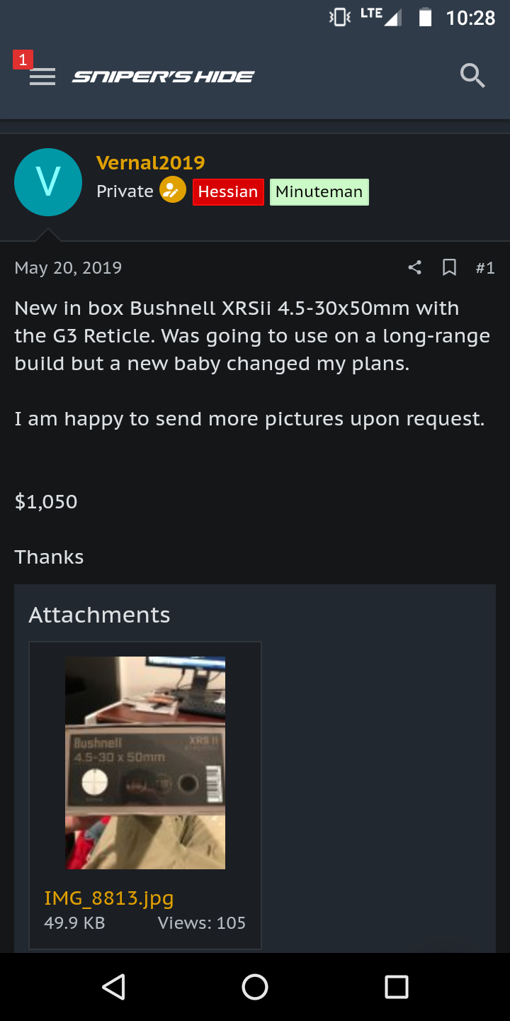

    You should highly consider finding a used Bushnell Elite Tactical scope in the PX section. I have seen the DMR 2 Pro sell in perfect condition for about what your budget is. Bushnell Elite Tactical stuff is very good.
    You'd be an idiot not to buy this.
