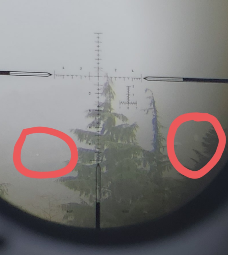

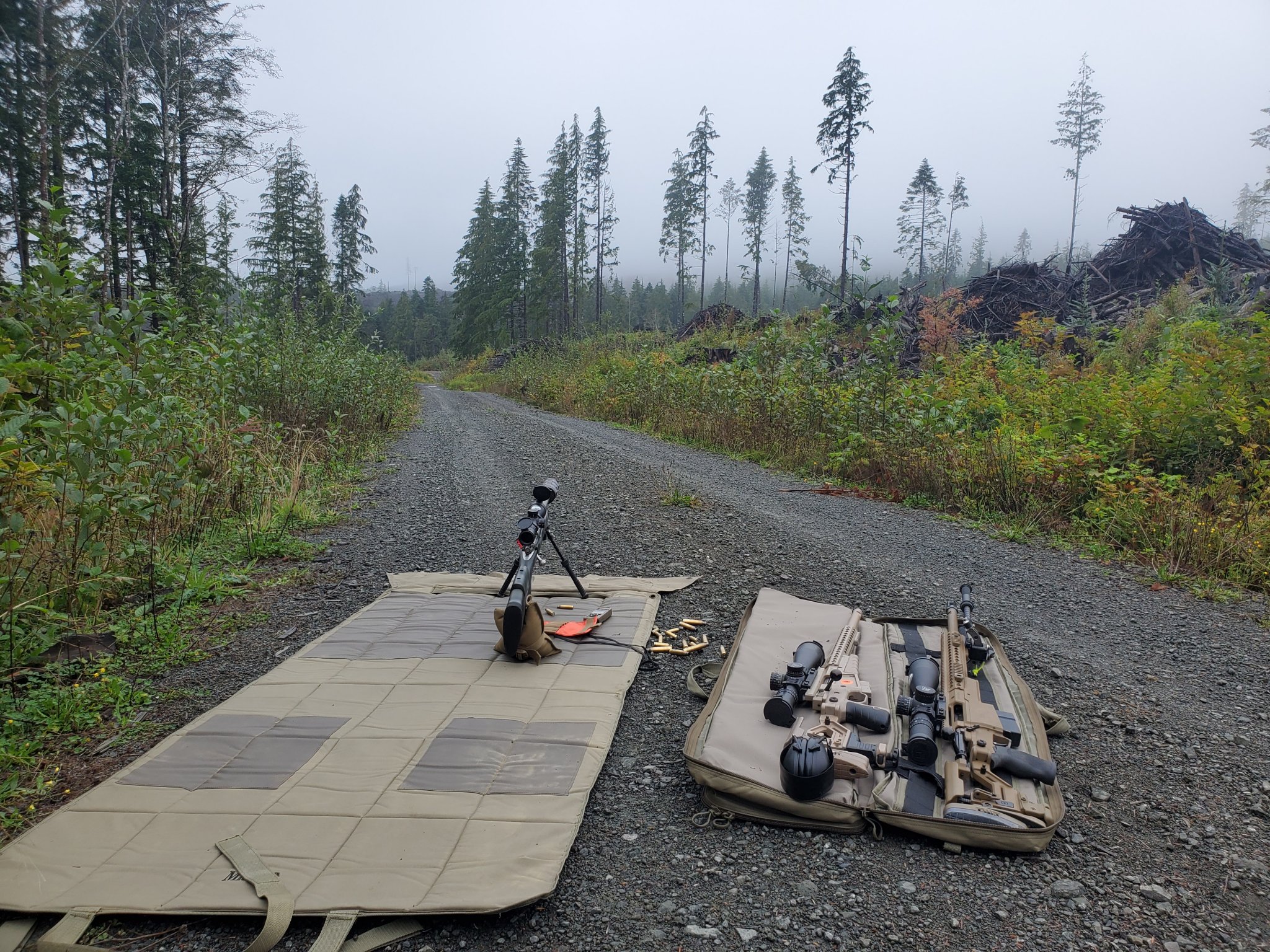

I recently picked up a Nightforce NXS 2.5-10x42 for a compact hunting rifle. So far it's been great, and I have been really happy with it. The glass is good and tracking has been 100%. Earlier this morning I was shooting at pop cans at 750 yards on a dirt berm. With only being 10x it was a challenge for me, but doable. I have shot steel at 1000yds without a problem.
I would have liked to try one of the straight tubed 34mm scopes for a more compact scope, but I didn't have enough to buy a second scope if it didn't work out.
Absolutely horrible conditions for taking pics thru the scope, but had no problem seeing thru the light fog and hitting the 1moa steel at 1000yds. If I couldn't make out the target with the NXS, I also couldn't make it out with my ATACR's. So better glass didn't help in my situation.
The 10" plate is on the left the ipsc is on the right.

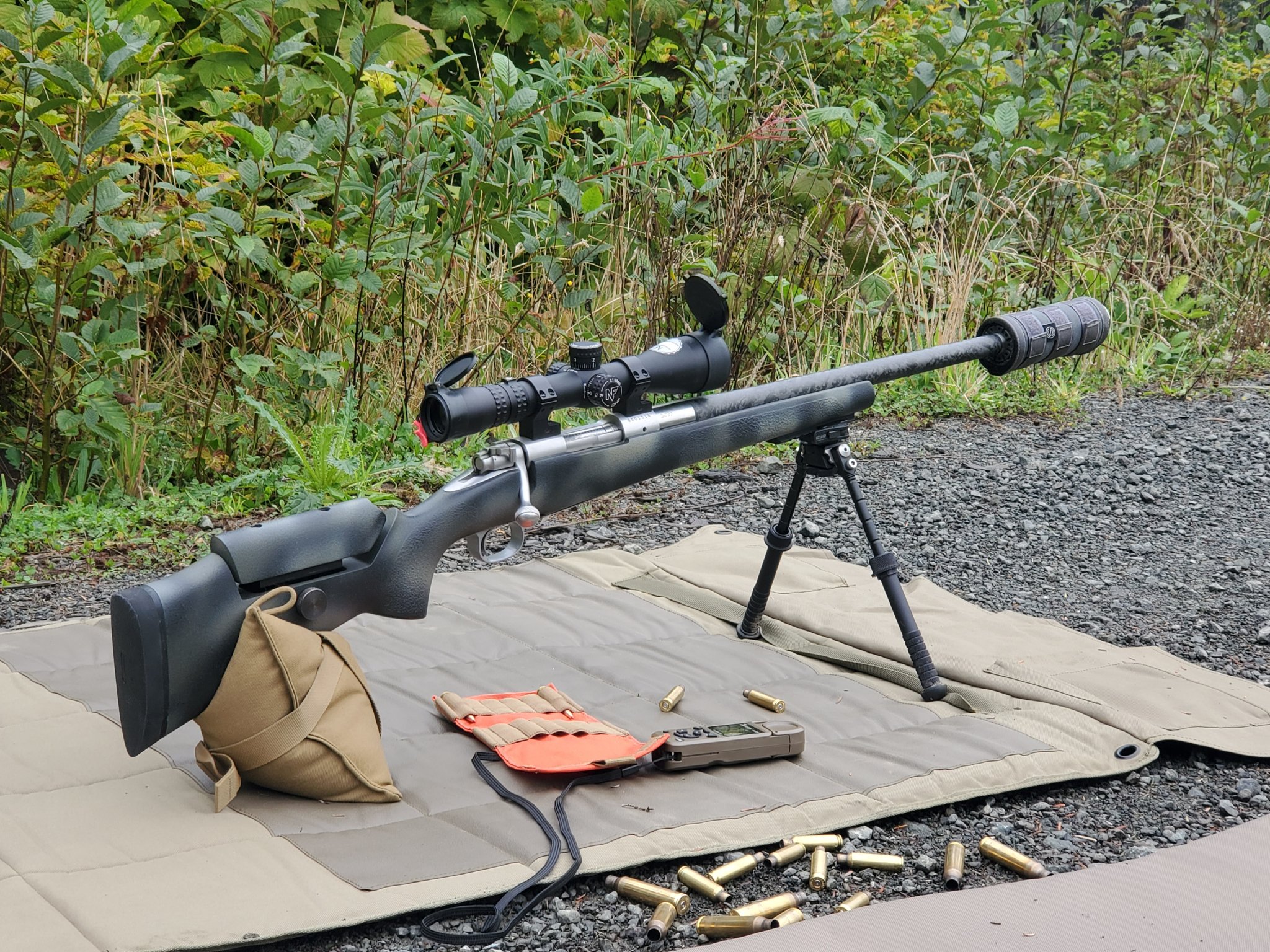

View attachment 7703542View attachment 7703543View attachment 7703544
Sweet looking rig.
Stainless model 70 action? And who did the barrel work?
