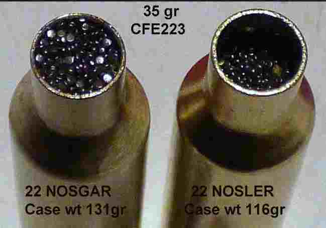

While 7mmFanboy is correct about the 22 nosler I would do a little research on the 22 Nosgar as long as you handload. The Nosgar uses a 22 nosler barrel with a 6.8spc bolt. Cases are a simple neck down from 6mm Hagar brass with 22 Nosler dies. Brass is from hornady but handles the pressure way better and yields better velocity.
I am a fan of proof barrels if money isn’t an issue otherwise I have always liked Blackhole (Columbia River Arms)
I was thinking of the exact same build for a thermal setup. Super flat shooter with less rangefinding issues at night. If i build one I would go with a proof carbon to mitigate weight. If its a predator gun the barrel should last a long time. 22 Nosler is a great choice if you don`t reload due to commercial availability and parts in common with the standard 223. The other choice could be a 224 Valkyrie but that requires a slower twist barrel and a bigger boltface for optimal performance with light bullets. I've seen some nice varmint setups for 22 nosler.
Stay away from the 22 Nosler.
People will dog you out about it :)
They will show you 55gr/3650fps from a 5.56. or a .223AI.
Bent rims are a function of gas volume and dwell (in a gas gun).
I don't bend rims in any of mine (3).
Pick your twist for the weight bullet you want.
X-caliber (wait for a sale) then wait for the barrel.
Pick you contour, twist, length.
The current lot of Hagar brass was bought up by CreedmoorSports.
Next year Hornady might make some more.
They have sorted out all the bad stuff they received and will also toss in a couple extra when you buy the 500 cases just in case.
The last 300 cases from the previous lot were bought up by me :)
The Hagar case is a lot heavier than the Nosler brass.
Case weights shown include a reversed spent primer in each.

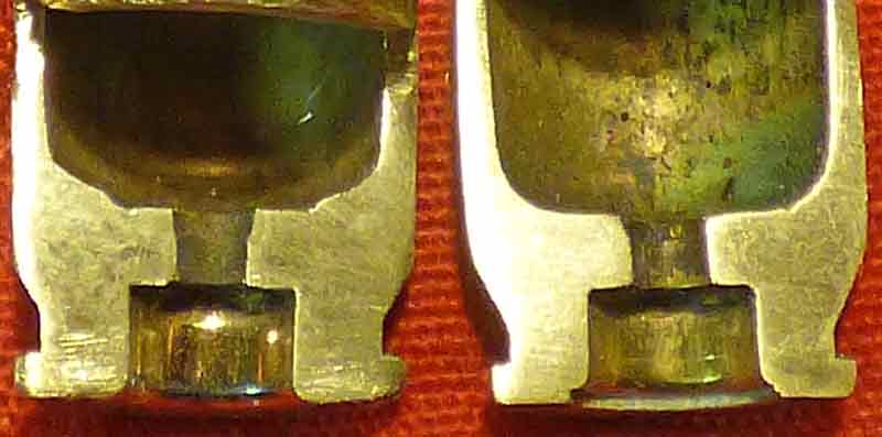

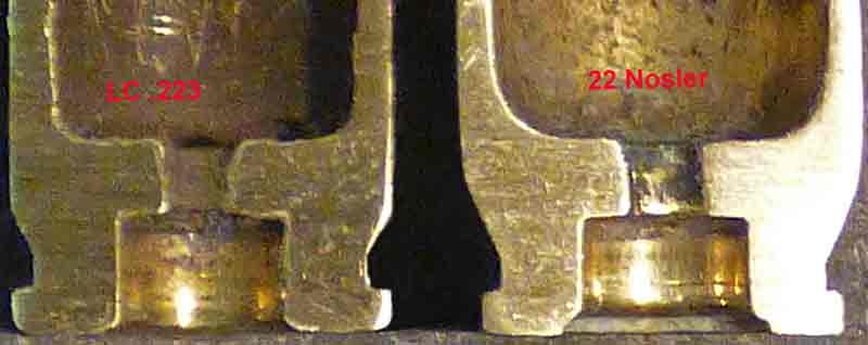

Here's the web of a LC .223, 22N and the 22 Nosgar. Notice the WEAK rims.
Hagar Vs 22N
