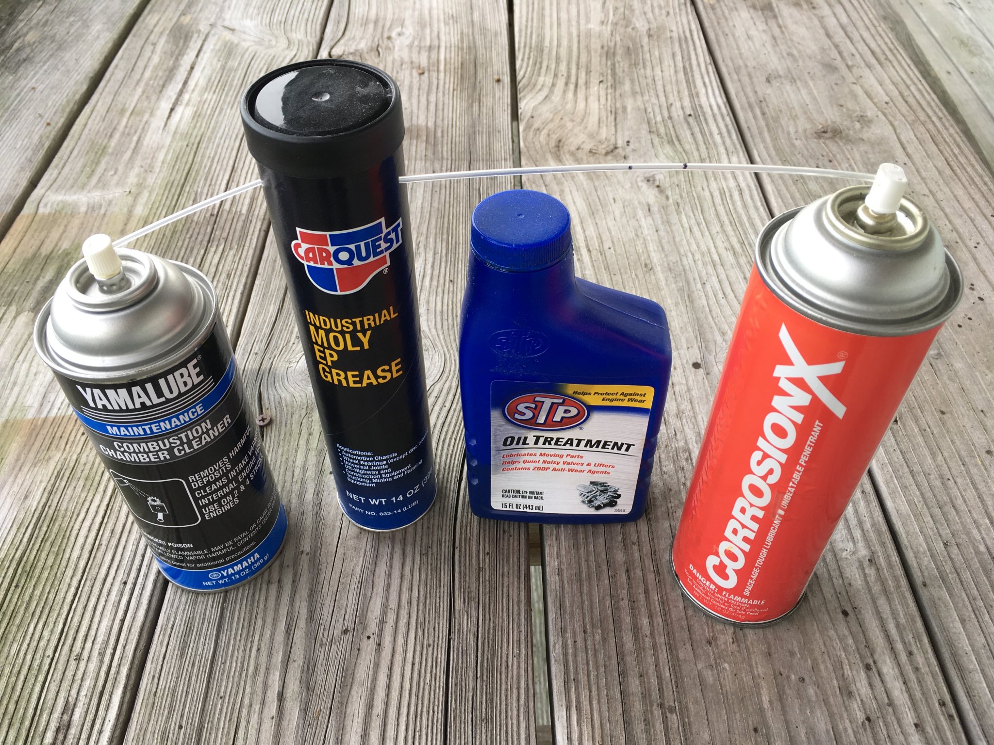

    Over 45 years of gun care and many firearms, my choice of products has evolved to these main 4.
    Left to right, there purposes are cleaner/degreaser, high pressure lube (50/50 grease and oil treatment), high speed lube.
    The STP is also great for treatment of contact points in a safe which touch blued steel.
    I also fog gun safes and cases with Corrosion-X for long term storage. Not pictured, I use Ballistol as a cleaner for plastics and finished wooden parts.
