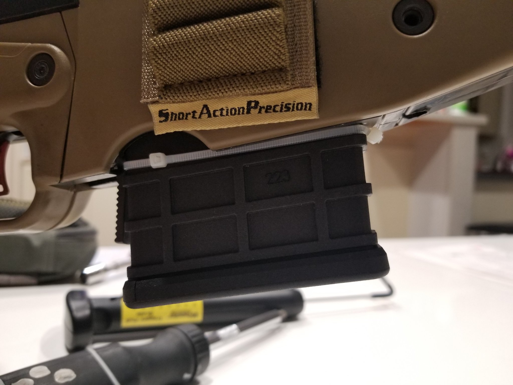

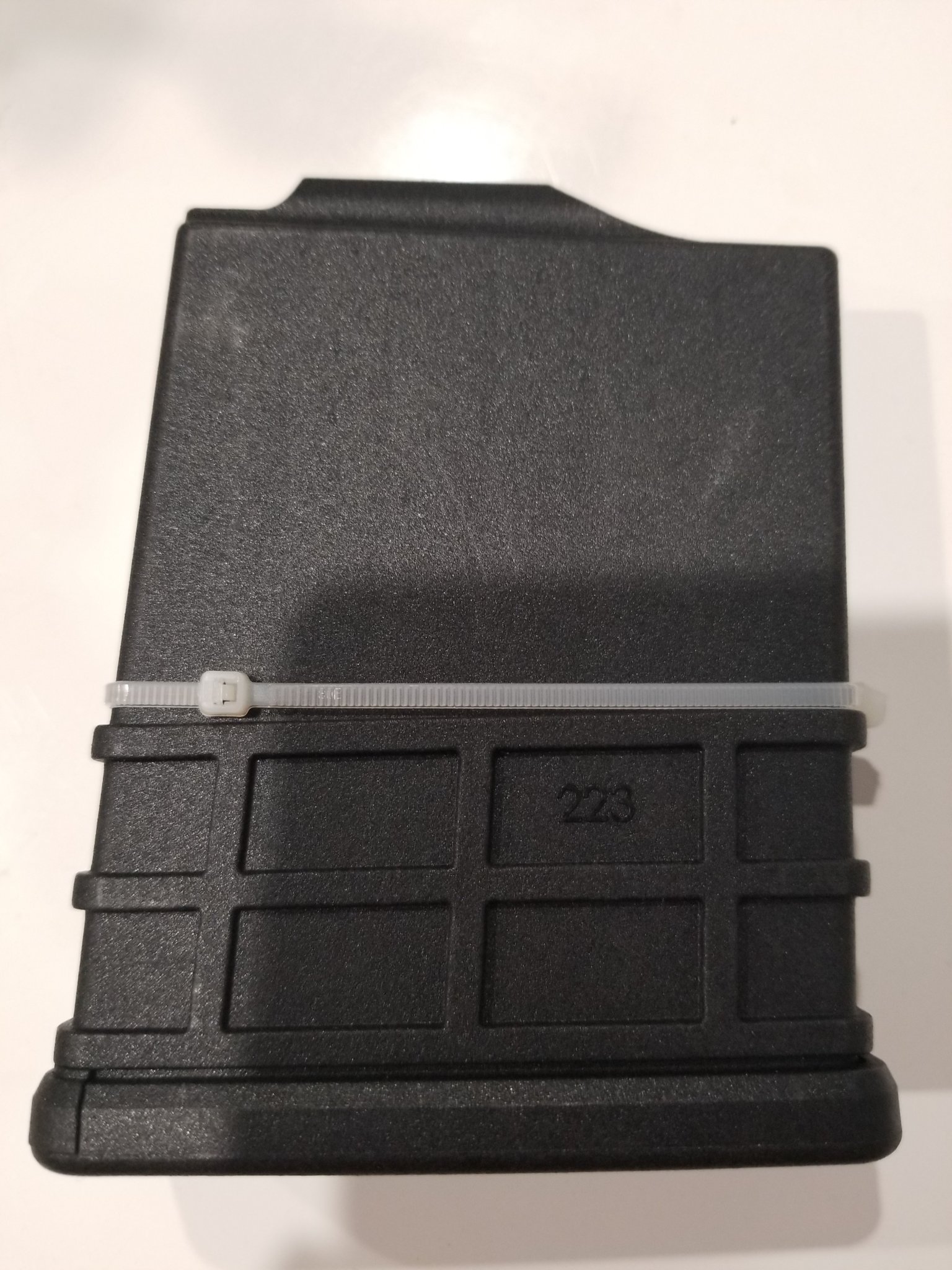

I have two of the mdt mags. It goes too far in an AICS and stops the bolt from moving forward. Didn't want to mess with modding the mag so used some tactical zip ties to fix the issue. It's been working so far.
My head just exploded.

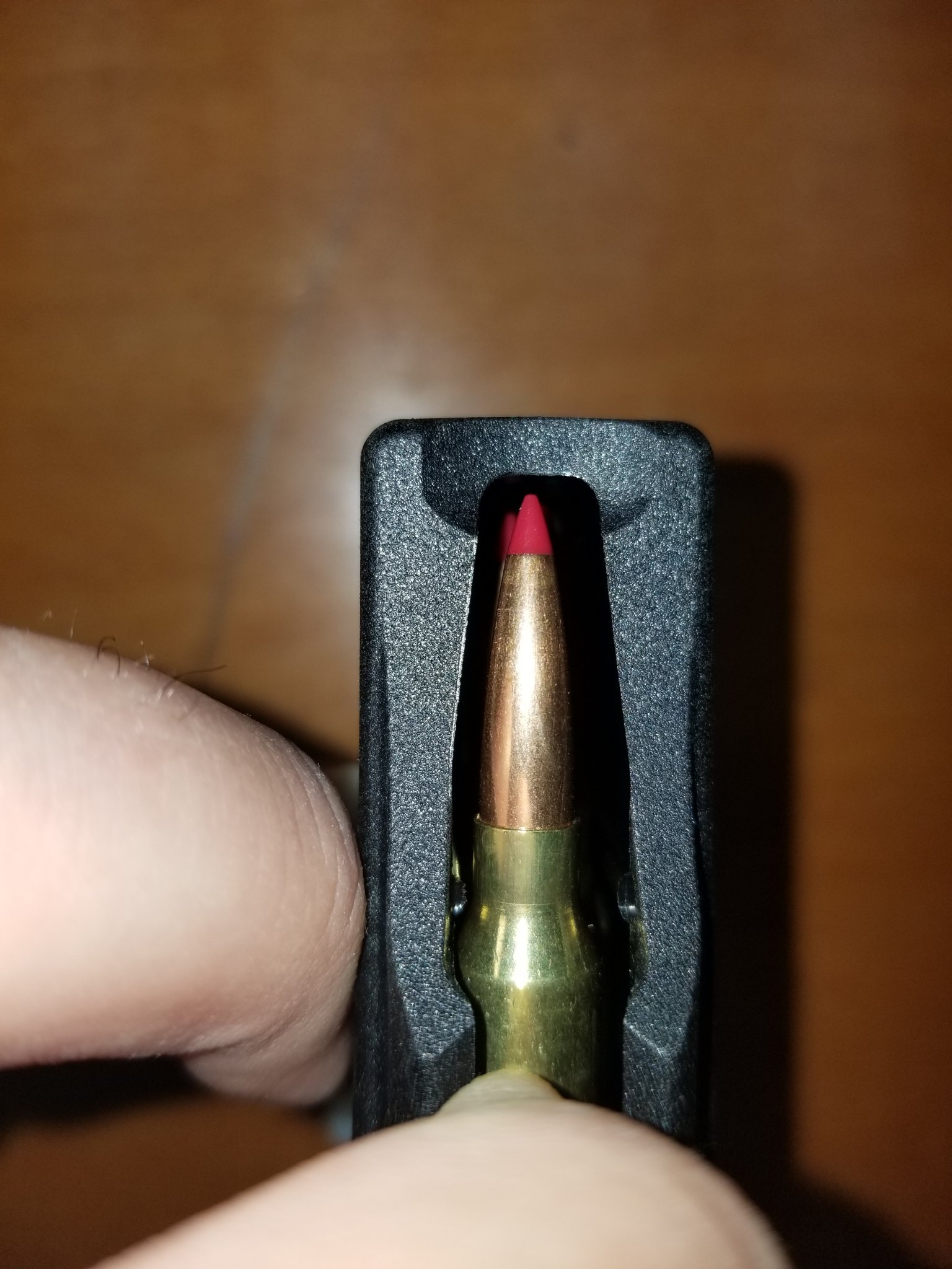

Anyone able to load the heavies 80+ in the MDT mags and fit them? I've got a 700 223 action that I want to build another rifle with, but if I can't load the heavier .224 projectiles and fit the COAL then I would rather open the bolt face and make it 6mm whatever.
Not sure about 85gr. This is 80eld @2.505 coal. Max is about 2.565 for the mag

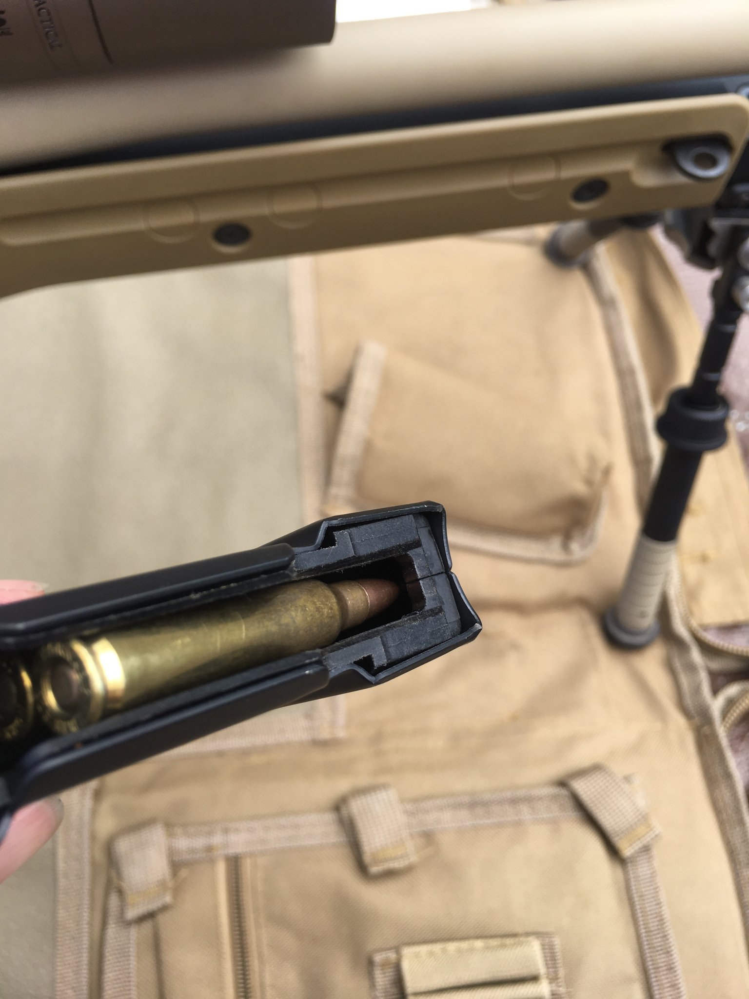

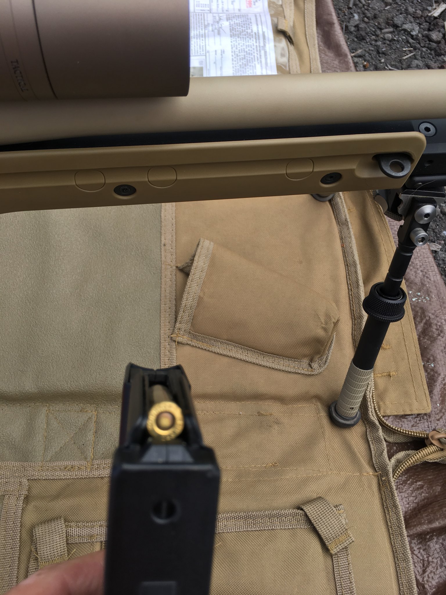

My brand new Accurate mag ended up doing this for at least 3 rounds out of every full 10 round mag today, pretty shitty for a brand new mag that’s expensive. Looks like it’s adjustment time.
Not sure why Accurate makes the inserts like that with the "lip" up front, just use a rat tail file or a round burr bit on a dremel and remove the lip at the front of the inserts until it's even with the rest of the insert body. No more snagging the bullet tip and gives you a little more OAL capacity too.
