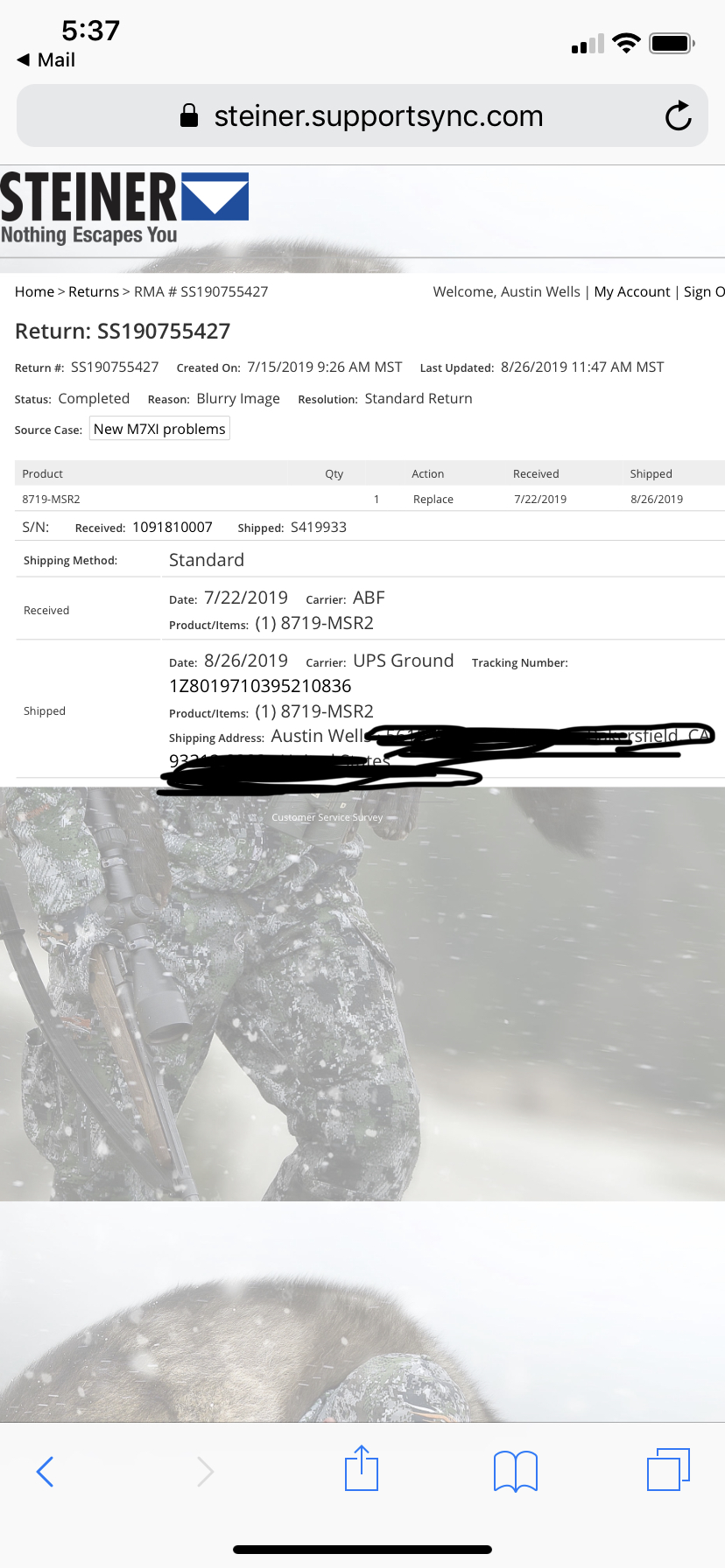

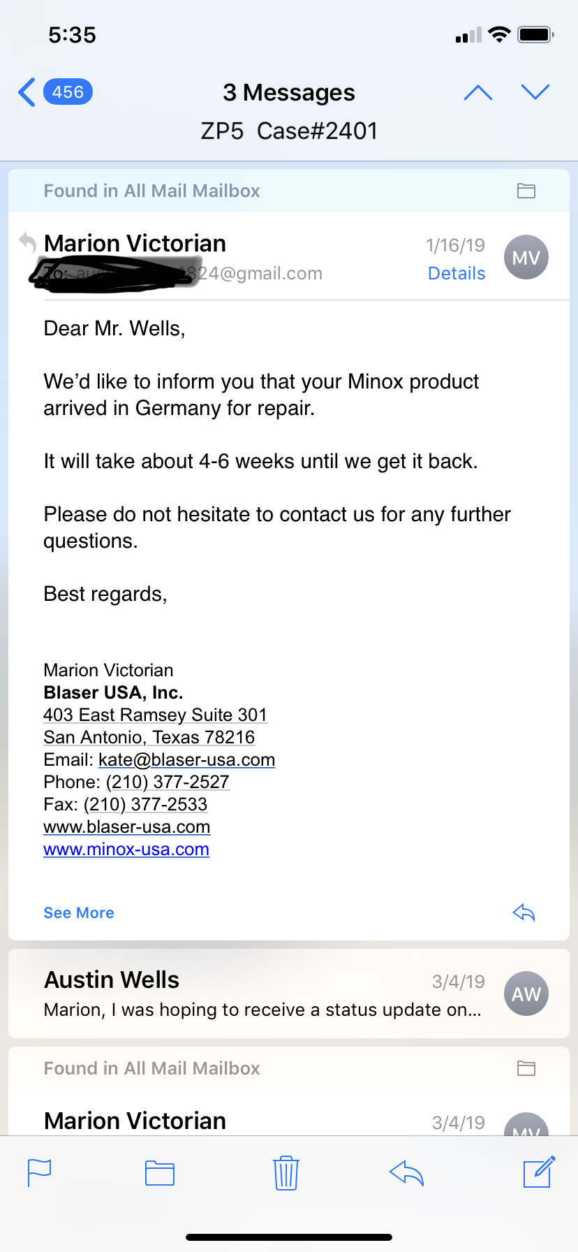

@Threadcutter308 It was three different brands of scopes that I had arrived defective. Might not be clear, but it was in my post.
The Minox ZP5 arrived defective and the vendor wouldn't let me return it so I sent it back to Minox. Minox quoted 10-12 weeks, scope went out mid November to go out with the December shipment and didn't get returned to me until mid April, repaired not replaced.
That scope was then sold and replaced with another scope from a different vendor and different manufacturer and arrived looking like dog shit. That scope was then sent back to the manufacturer because the new vendor wanted 15% restocking fee on a fucked up scope. This time I wised up and disputed the charge with my CC and won.
When the money was returned to me I bought another new scope, from a different manufacturer and vendor which arrived defective. The last vendor had a no return policy and this scope was quoted with a 2-4 week turned around, which I decided to just suck it up for since I just did the CC dispute on another vendor. Took six weeks and a replacement was sent.
Three scopes, one after another, all from different manufacturers had arrived defective. There was also another that had arrived defective from another manufacturer and vendor but I *think* there was one good one that snuck in before the rest of the three.

Did you miss the part where I have written communication from all three different manufactures deeming their scopes defective and will be repaired or replaced?
Parallax on the Minox was defective so that whole unit including the illumination got replaced. There was also an erecter spring and some other stuff that got replaced and the scope was sent back to me repaired.
The Leupold was a complete cluster fuck, was replaced with a new, sealed unit, and returned to the vendor.
The Steiner had terrible CA and wouldn't resolve images on the higher end of the magnification range. Replaced with a new, sealed unit.
I see that you contacted the company's for return but when you opened the box to those scopes what was the discrepancy with the scope that initiated the returns to begin?
Example scope one would not hold zero....
