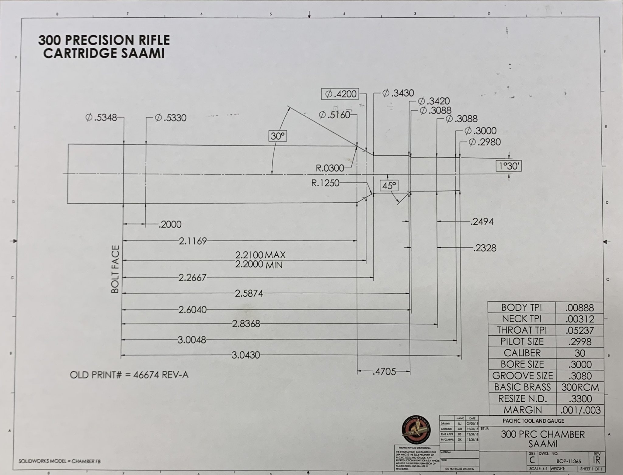

Back to business. Here’s a saami 300 PRC reamer. Note the tapered neck, and long freebore.
As a point of comparison, a 300 Norma has a virtually identical neck length(.325 vs .321 for PRC), but .017 less freebore than the PRC. Hornady really wanted to get the heavies out of the powder space with the PRC. Buy a box of brass, pick two bullets, pick your intended magazine, and make some dummies. Then tinker.
As a point of comparison, a 300 Norma has a virtually an identical neck length, but .017 less freebore than the PRC. Hornady really wanted to get the heavies out of the powder space with the PRC. Buy a box of brass, pick two bullets, pick your intended magazine, and make some dummies. Then tinker.

Regarding the tapered neck, the neck wall thickness of the brass is tapered to match(6.5 PRC is the same). Unless you’re going to neck turn, don’t be inclined to make the neck cylindrical like most other match reamers are.
Tinker away, but you’re best suited I think with saami imo. You’ll be able to rent it to people easier that way as well.
