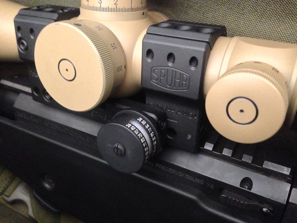

You forgot to mention SPUHR!!
I run Spuhr 34mm on both of my AI's. They are built like a brick shithouse, but excessively heavy. Also, don't expect to run any tube-mounted equipment (ADI, bubble-level) as they eat a vast amount of tube real-estate. Granted they do have a built-in level that is functional, I miss my Flatline tube levels.
There is also a Spuhr official adapter plate that will allow you to attach an ADI directly to the mount.
