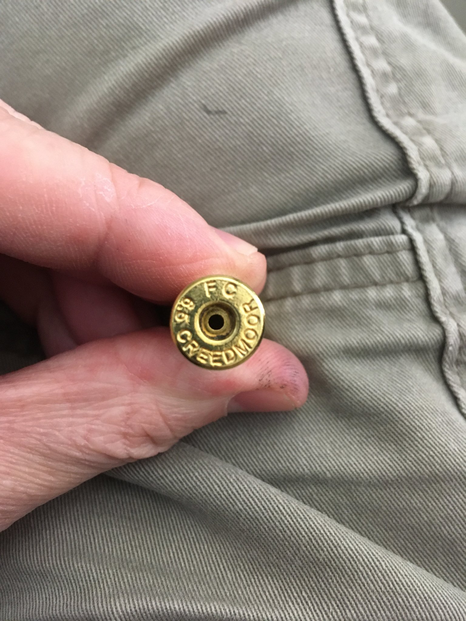

I've got 40 firings on my Lapua Brass. (Longest lasting and still going)
Starline craps out between 15 and 20.
Lost some yesterday at 17th Reloading.
Oddly, basic Federal Brass lasts the same as my Starline does... On average...
