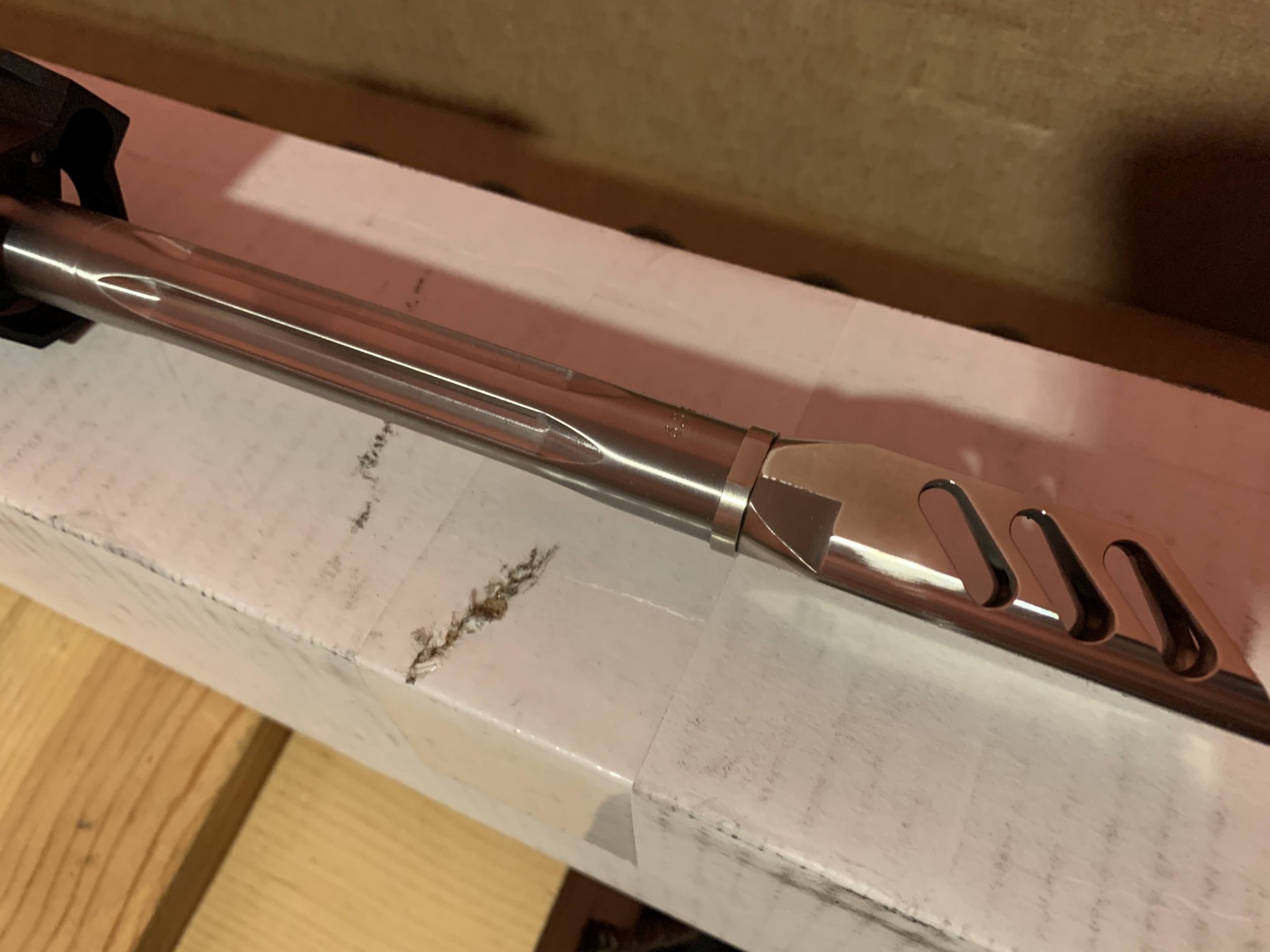

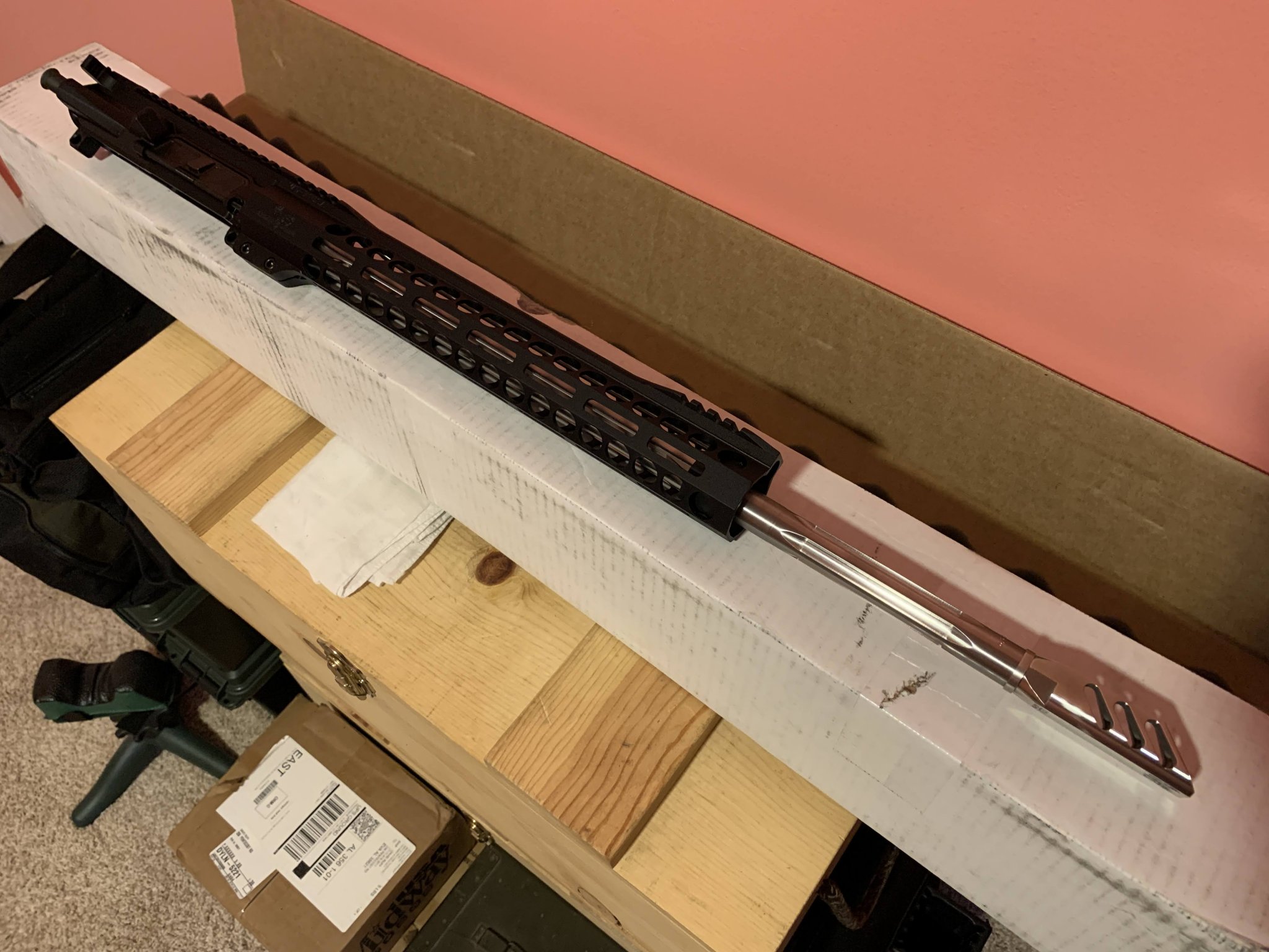

Received my Grendel Hunter 20 inch upper yesterday. It is a beauty.
Slapped on a Midwest Industries Picatinny rail section on the bottom for a bipod and a MI sling adapter on the left.

View attachment 7344560View attachment 7344561

The upper is pretty light.
That’s why the GH uppers caught my eye, I did a bunch of math and I could get a 18” 6.5 grendel to weigh around 7.5-8lbs with a 3-9 scope and the AR platform for kids with very short LOP
The secret is their handguards. Lightweight but very sturdy, long, steel barrel nut. Somehow they still keep a 15.5 inch handguard ~12oz including barrel nut and mounting hardware.
