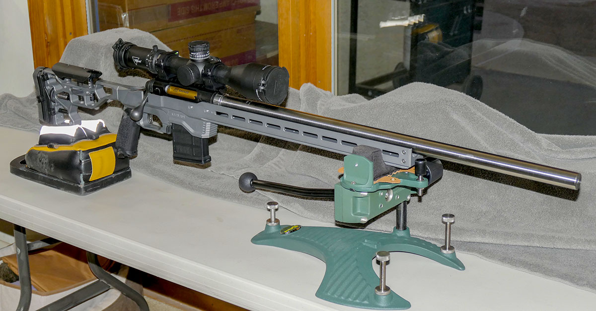

I vote--with my money, many times--on the Savage system.. All mine have been large-shank, and all of my barrels are Criterions from Northland.
Here's my newest, in 6XC.
