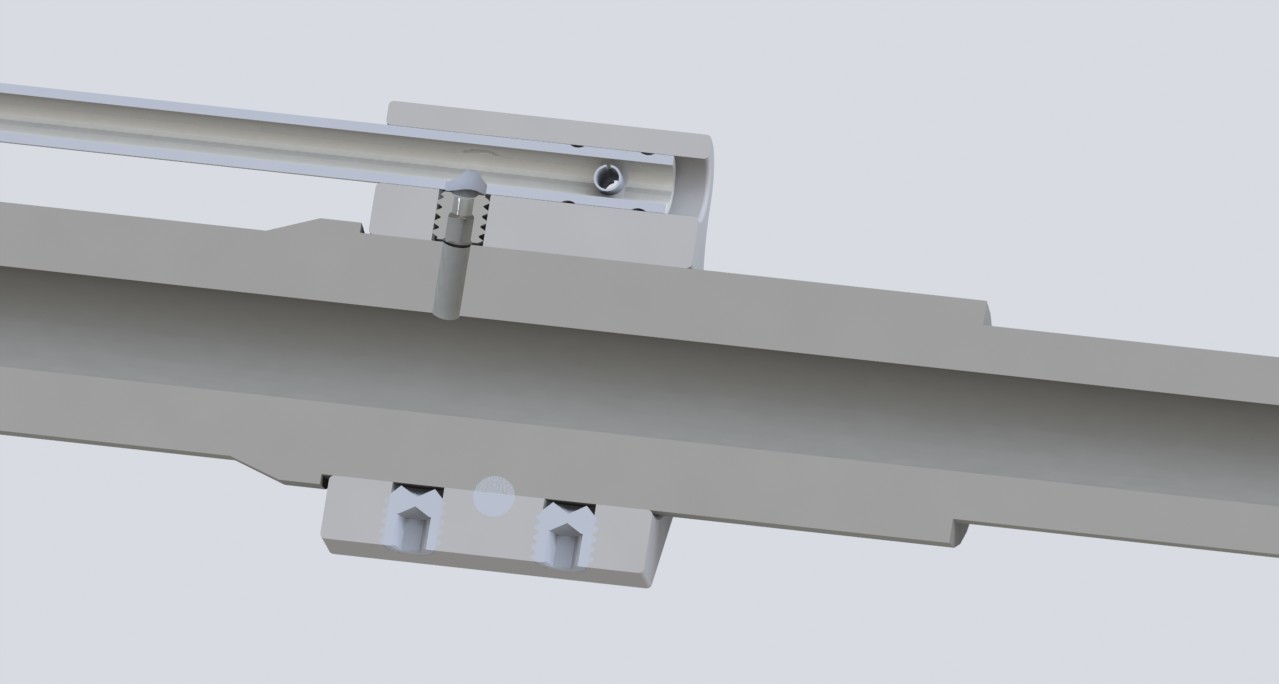

So, that leaves this... a simple insert GB... no real moving parts, just a insert restricting port size.
http://www.blackrivertactical.com/c...le-Gas-Block-750/p/102156493/category=6464009
If you have some basic skills with hand tools, you can do this with any gas block. For the low profile style pictured, all you need is a tap the same size as the lower set screws, one extra set screw, and various size drill bits. Everything you need is available from McMaster-Carr for under $30. I've done a handful like this with both low profile and A2 sight post gas blocks.
