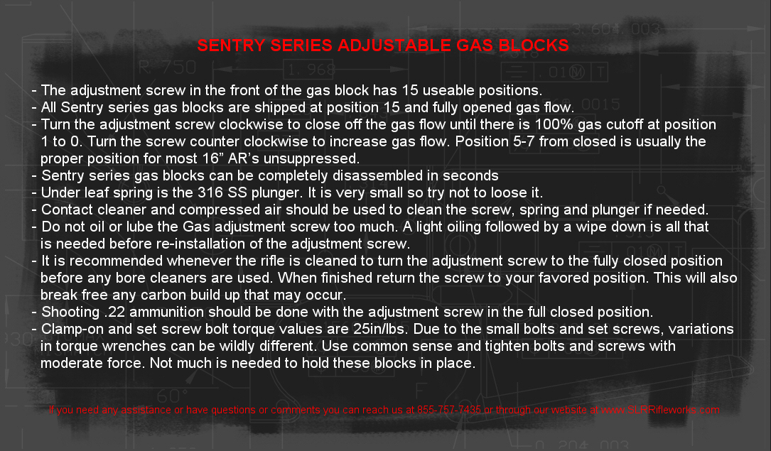

They are designed to be able to be taken apart easily & it's a patented design, so I just use their recommended procedure every 1,000 rounds or so. Only takes a few minutes.............takes longer to remove the rail & put it back on.

SLR is the only one I have seen that works when actually used heavily. There are too many things to go wrong with an AGB. With the bootleg adjustable carriers now on the market, that would be my recommendation if it fits what you need to do. They need to come out with a large frame carrier.
I've broken two SLR Sentry 7's. I broke the detents. Now, to be both clear and fair, it was on the same 7.5" 556 gun with an Echo trigger... but the detent broke twice nonetheless. SLR was incredibly responsive both times and made every effort to make it right.
If it tells you anything, despite these issues, I still run a Sentry 7 on my 18 inch SPR and it has been 100% with limited rounds. I like the company's products (fantastic rails) and that they will stand behind what they sell. Just be aware that not all applications may be good fits.
Yes, SLR is great to deal with..............I've used a lot of their rails as well, & they are as good as anything else available, including Geiselle, IMO. They have a long barrel nut for stability & are easy to get on & off & the finish is unsurpassed.
MM
