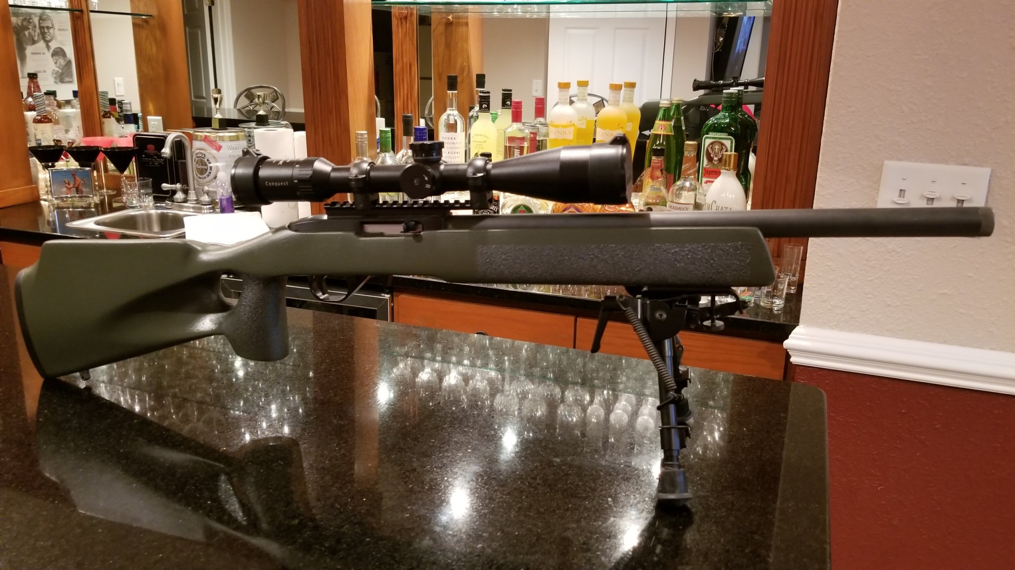

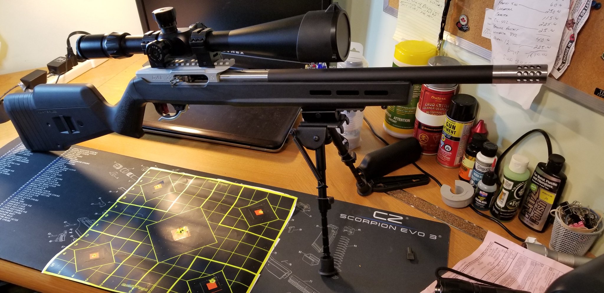

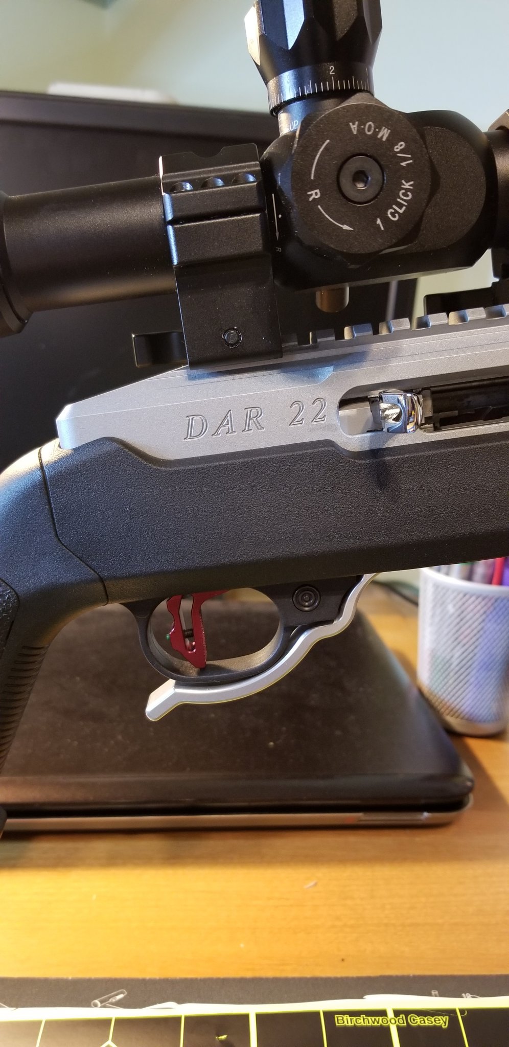

This is my custom 10/22 Ruger. I think he only Ruger parts left on the rifle is the name. lol.
Volquertson match THM tension barrel with 32 hole compensator.
Volquertson extractor.
Dlask Arms DAR22 receiver with integrated picatinny rail machined from 7075 T6 hard anodized aluminum
custom Dlask V block
free floated barrel
assembled and tested by Dlask...guaranted 1/4" accuracy at 50 yards
Kidd bolt, titanium firing pin, bolt bumper, chrome skeleton extended bolt handle, auto bolt release
BX trigger group with Tandem Kross Brimstone Tier 2 upgrade...1.8 pound pull
Tandem Kross extended mag release
Magpul X-22 hunter stock
NOTE: DLASK is a Canadian company in Vancouver...check out their website

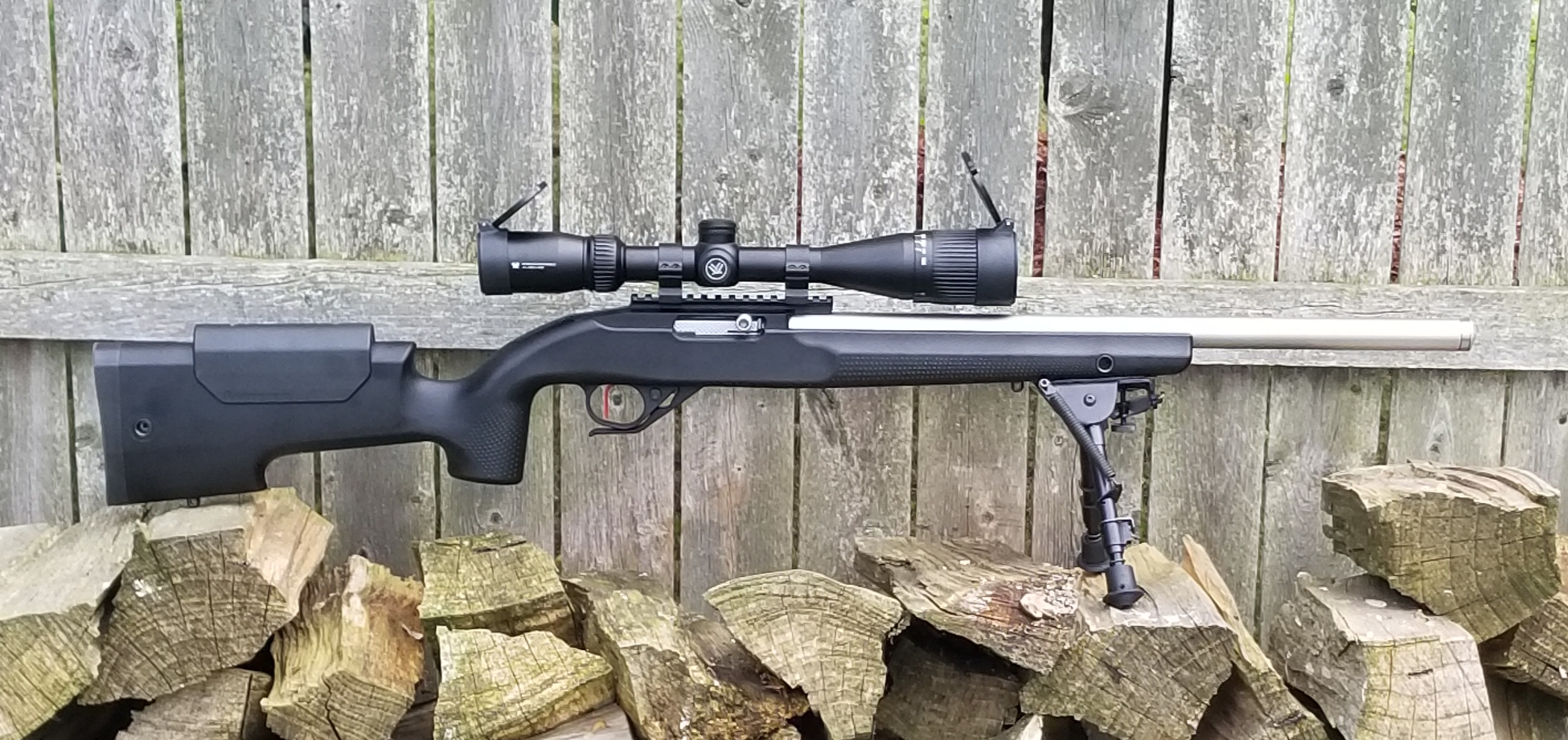

I have to say I think a Kidd barrel is hard to beat.. I have a 20" stainless bull barrel in a all Kidd build..receiver, bolt, two stage trigger, all in a Victor Titan stock..under 1/2 inch groups @50 yrds..likes Federal Auto Match. SK Rifle match, and CCI SV..
Reactions: Westcoast308
Thanks !! The receiver is a Kidd and the rail is actually screwed into it..it's very well machined.. I'm currently running a Vortex Crossfire II 4-12x40.. soon to be replaced with an Athlon Argos.. I building a CZ 457 right now so the Kidd/Titan is on hold for the moment..lol

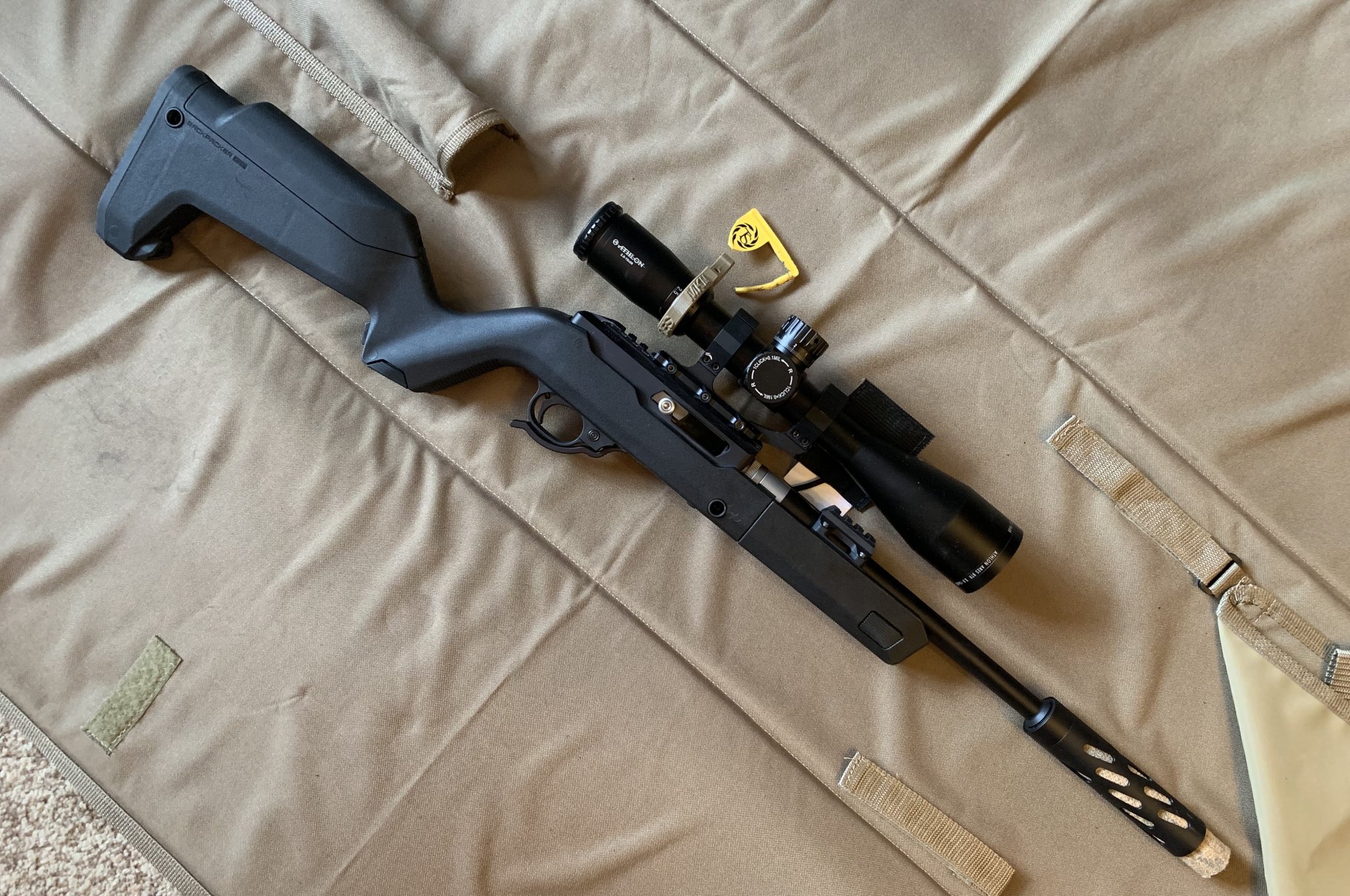

Another satisfied SBX customer here. May not be good enough for everybody but it's good enough for me.
Immediately below is maybe 5 shots? (maybe more but I usually do 5 shots when sighting) @~45yds using a red dot with a SBX barrel sporting an ancient Spectre II saddled in a T/CR22 receiver with the factory trigger, bolt and stock.

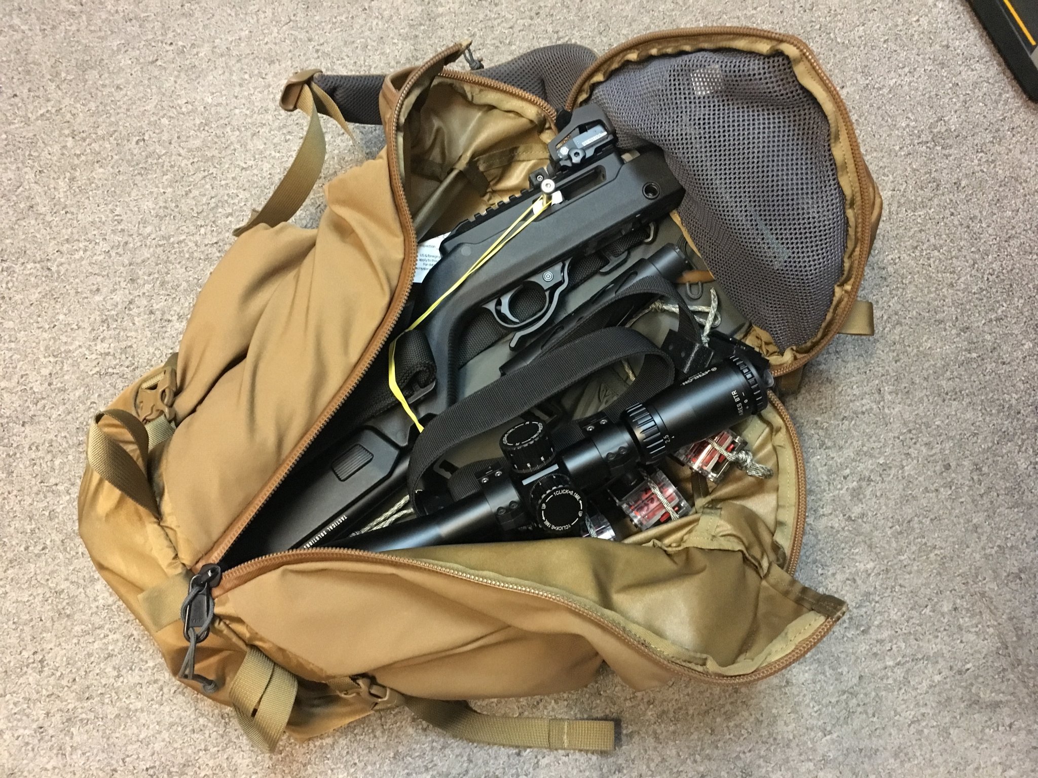

I have another one, also with a red dot, built out with another SBX barrel, another T/CR22 receiver/FCG/bolt and another Spectre but with a Hogue rubber stock instead of the T/CR22 stock ... second picture.

The gun that corresponds to the first target in the previous post. The only difference in the gun for the second target is the stock is a Hogue rubber overmold.
It's not exceptionally pretty because the stock barrel was tapered and I removed the insert from the forestock to allow the TS bull profile barrel to free float.
