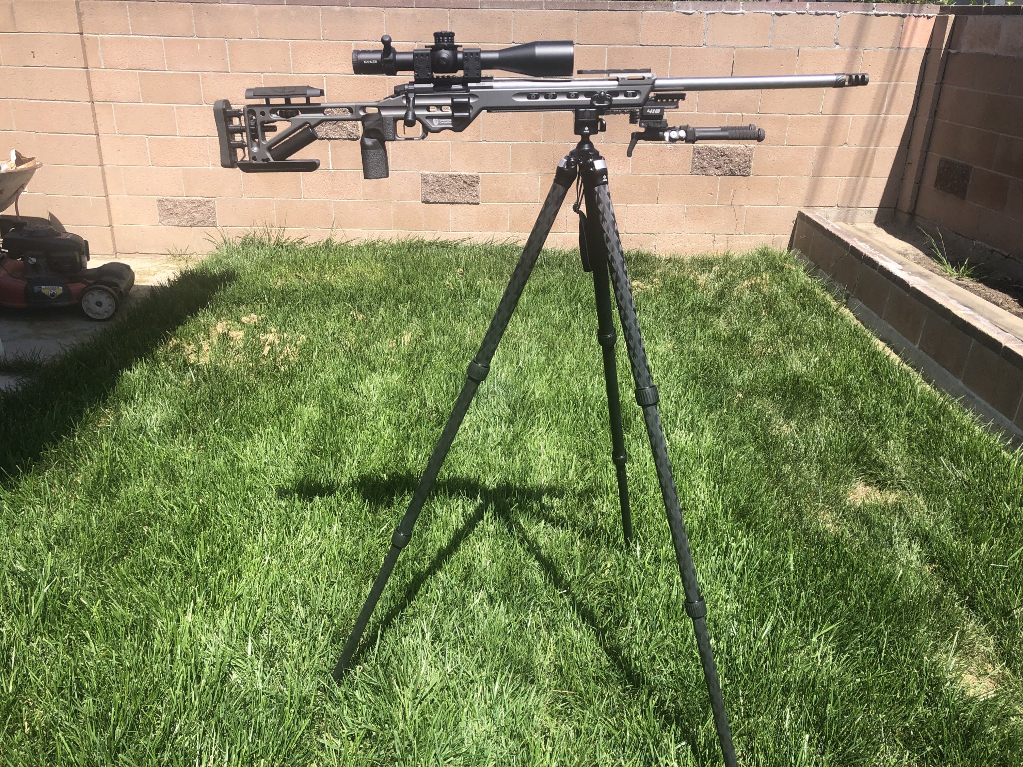

ive coughed up big money on a a few things but to this day the single best most versatile piece of kit Ive purchased has been my RRS TVC-24 and Anvil 30.
my Zeiss Victory 10x42 RF Binos comes in a 2nd and not a close 2nd either .

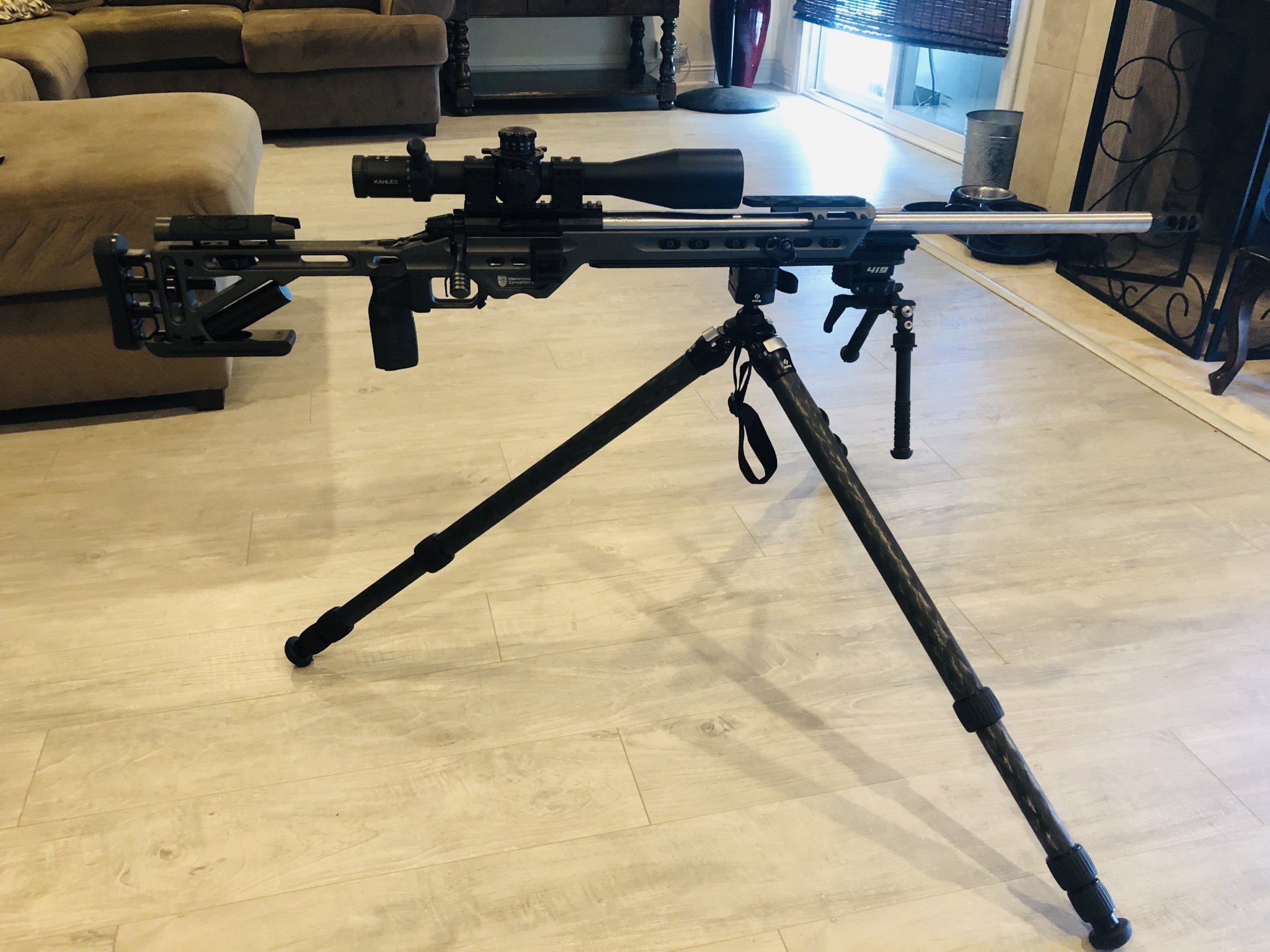

I went with the TVC-24 (bit smaller leg diameter than the 33’s) dto the weight savings for hunting. That said, I’ve had my 26lb comp gun clipped into it and it’s stupid stable, and then you also have a great tripod for glassing as well.
It also makes it really easy to snap in, get used to different positions right there in your living room. Helped me a lot working with my daughter on her positional as well.
Point: save pennies, sell what you have to, and get you ur hands on that RRS. You’ll love it.

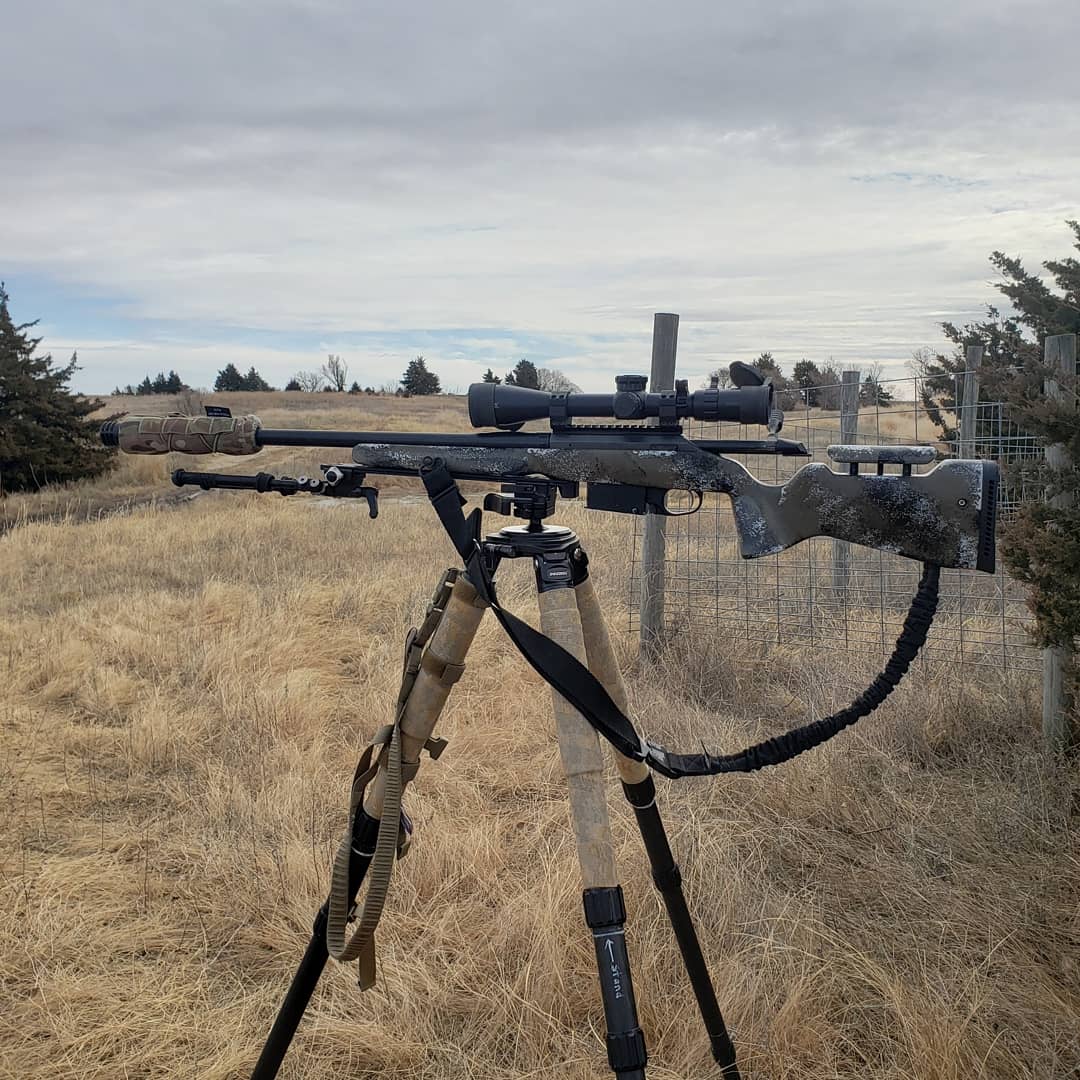

I’m still liking this one:
