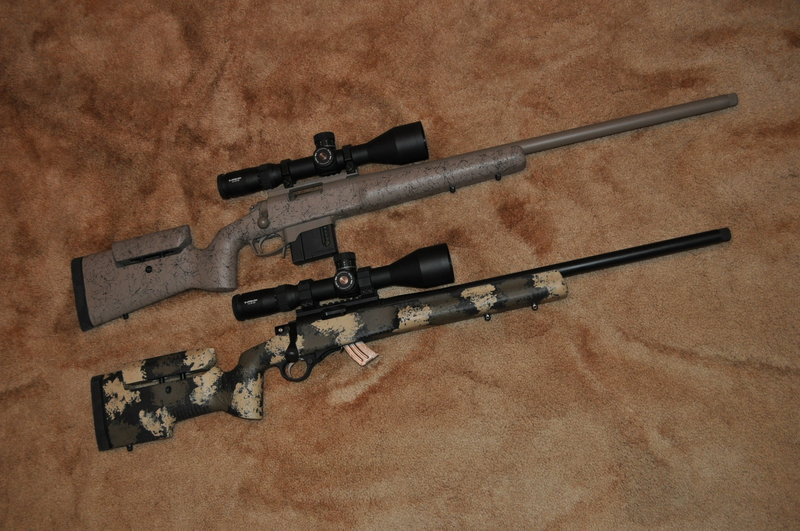

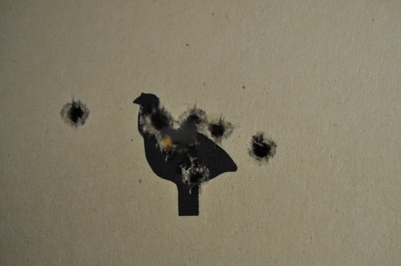

This is representative of what I get out of SK Rifle Match at 100yds, shot on an afternoon with quick drop-offs & build-ups in a 6-7 mph wind from 4:30-5:00. Nothing to brag about, but I feel it's not at all bad for ammo that costs $4/box less than Center-X. I shot this out of the 40XB's Krieger, single-loaded, as I haven't sent it to jelrod1 for the repeater conversion yet. Right now, I've got it in a Manners T4A painted woodland camo, with a DBM mini-chassis, Athlon Cronus 4.5-29x56 in TPS TSR rings. I finished the Krieger at 24", threaded the muzzle as per the drawing on Silencerco's website for the Spectre II. All the accuracy testing I've done with both 40Xs has been with the can mounted. Love shooting these 40X rifles, and can hardly wait to get the 2nd one converted into a repeater.

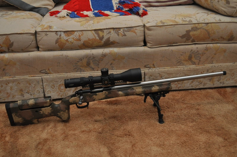

You mean this Stiller Lloyd? I liked that Manners T4A Elite in GAP camo so much that I ordered another one for the 40XB. Not a thing in the world wrong with the B&C #2015 on the 40X above the Stiller, I just really like the molded-in GAP on the Elite stocks with the carbon fiber showing in the black spots. I weighed those two stocks on the same set of scales - the Elite was only 1/2lb lighter than the B&C with its aluminum bedding block. I'm guessing it's gonna be the usual 6 months before I see that Manners; the 40XB bbl'd action is headed to jelrod1 next week. I won't have the finished bbl'd action repeater sitting in the closet for those 6mo, waiting on the stock. Will probably try to get another #2015 & get old 'Picasso with a rattle-can" Ben to paint it for me.
Yeah that's the Stiller. Ain't she purdy? Going to get to shoot it some tomorrow. I'm not ready for the match. I haven't practiced for several months but gotta shoot.
