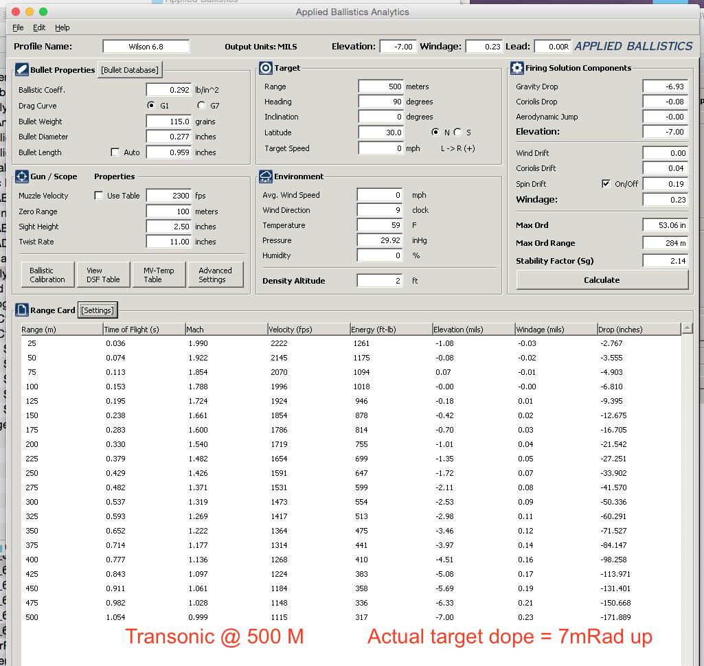

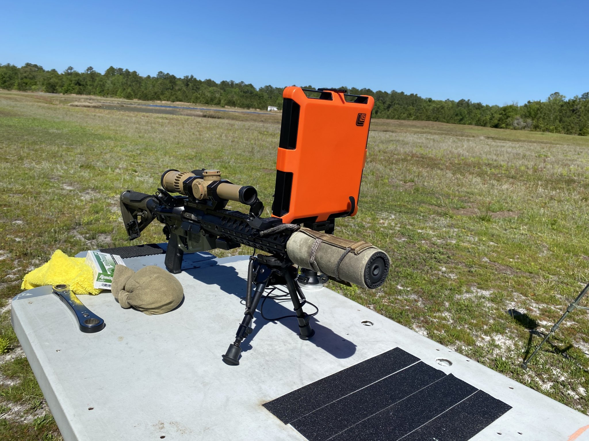

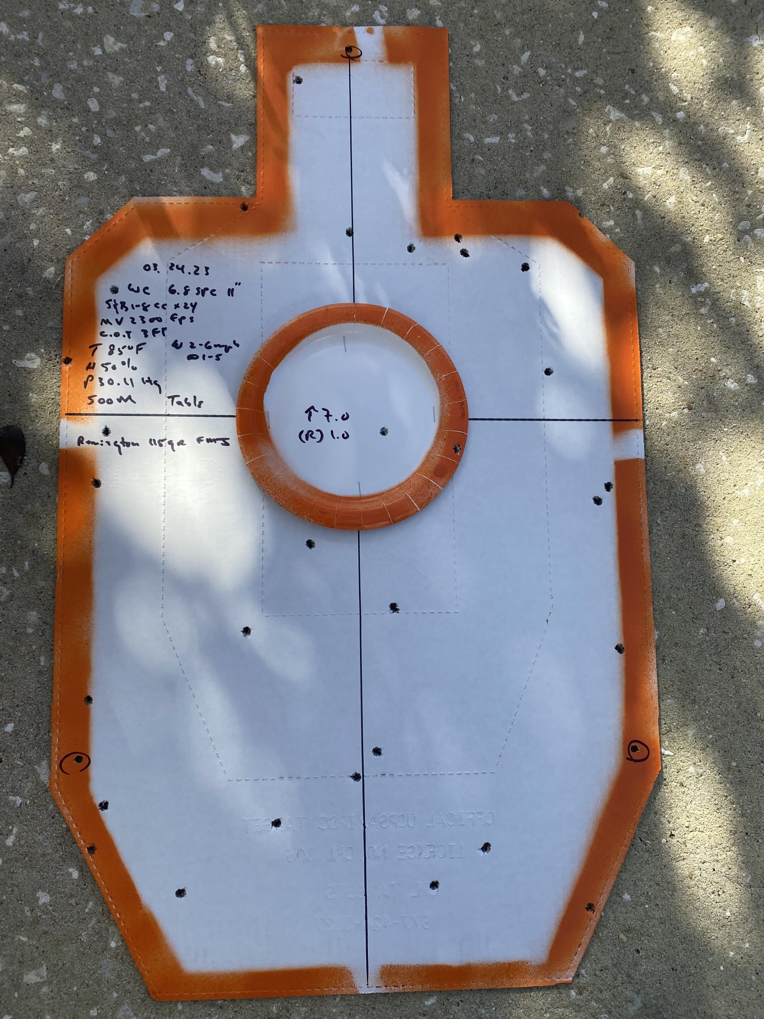

I use this 6.8 for Florida hogs inside 200 meters. It is pretty good for paper punching @ 500 meters with simple box ammunition.
IMG_3690REALLY RIGHT STUFF CT-34 WITH ANVIL 30 POOLSIDE RIFLES 07.17.22WILSON COMBAT 6.8 SPC 2...jpg
Wilson Combat 6.8 SPC II 11.3%22 Complete Upper Test Target CROPPED copy.JPG
IMG_6744Wilson Combat 6.8 SPC Applied Ballistics Calculations 500 Meters  copy.png
