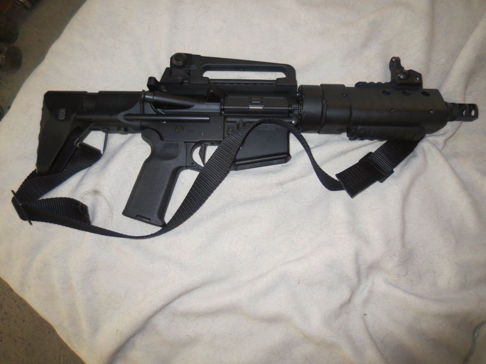

For uber short, add a LAW Tactical folder to it. The darn thing will fold up into a regular back pack if the can is off of it.

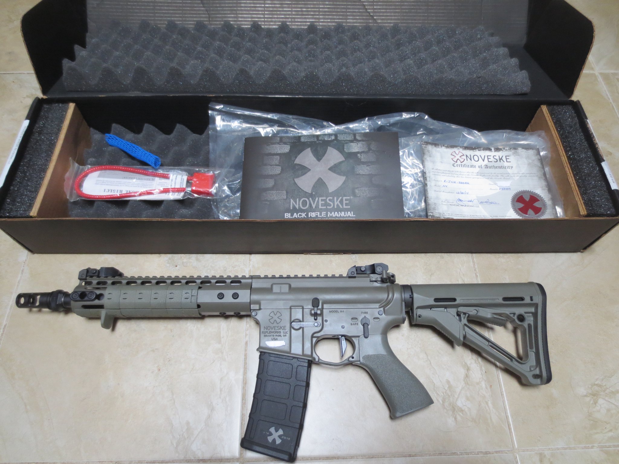

Noveske makes a really good one. They're my goto for SBR barrels. Accurate and they function suppressed or not, supers or subs. May as well go with 8.5" or whatever (most suppressor mfg.'s will say not to go shorter, bullet may not stabilize well).

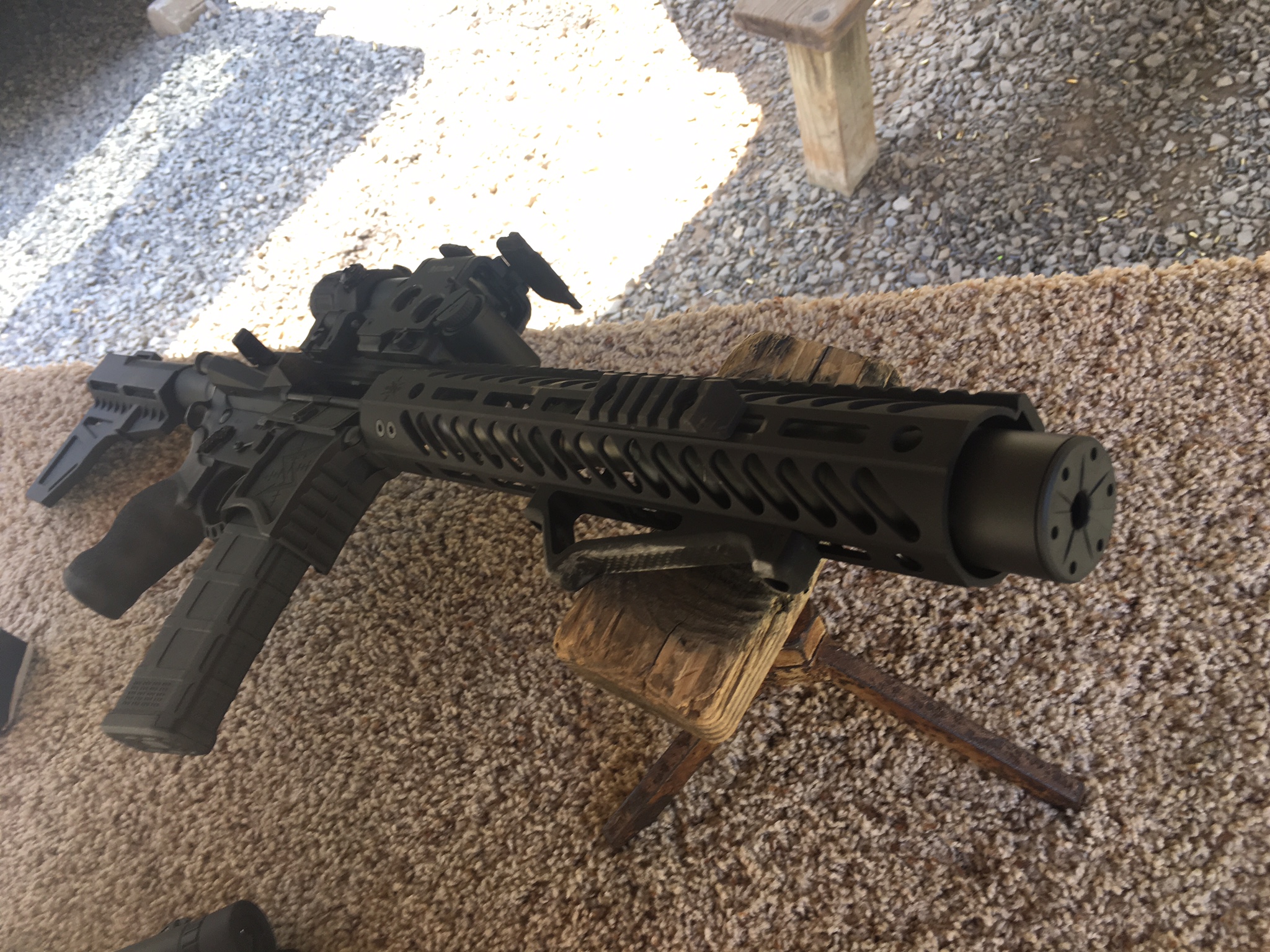

Factory rifle with 10.5":
My PDW w/8.2":

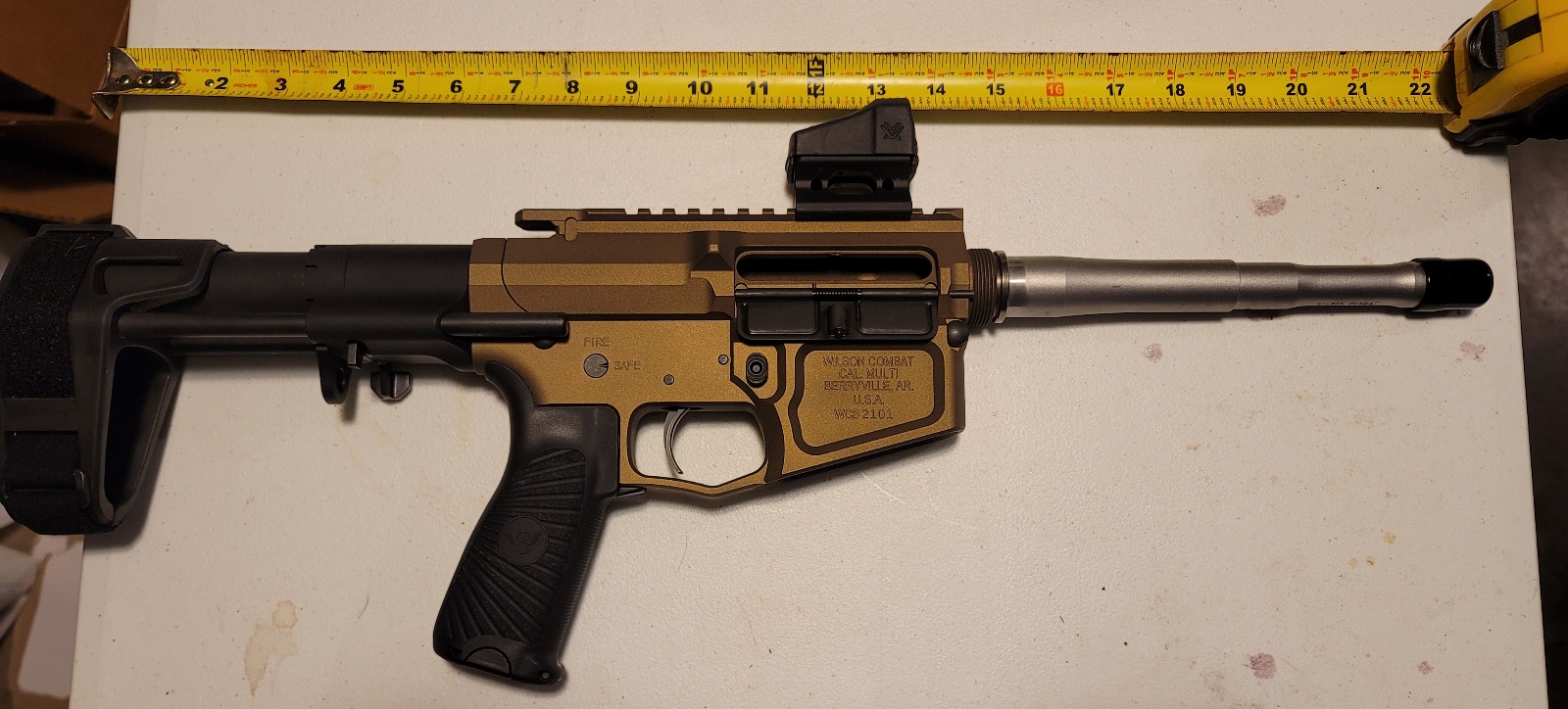

The parts list is complete. I'll post pics once she's Assembled. I waited til today to hopefully scoop up some black Friday deals:
WC billet upper and lower bronze
Wc stainless 1-7 8" stainless barrel
WC lower build kit
WC Oversize trigger guard
WC dust cover and parts
WC BCM Grip
SB Tactical SBPDW Pistol Stabilizing Brace
WC TTU single stage 3.5# trigger
Gas Block Wilson low profile
Gas tube pistol length
Midwest Industries SP series 12" handguard
Noveske Buffer H2 and carbine spring
Fail zero BiN BCG
Wc 7.65 Whisper titanium can.
Got about $1700 in parts invested aside from the can I've had for damn near a decade I never shot. That includes a few tools I bought because I've lost over the decade: I needed the receiver rod anyways because the Billit receiver. Those armorers blocks won't tighten down and scratch the finish.

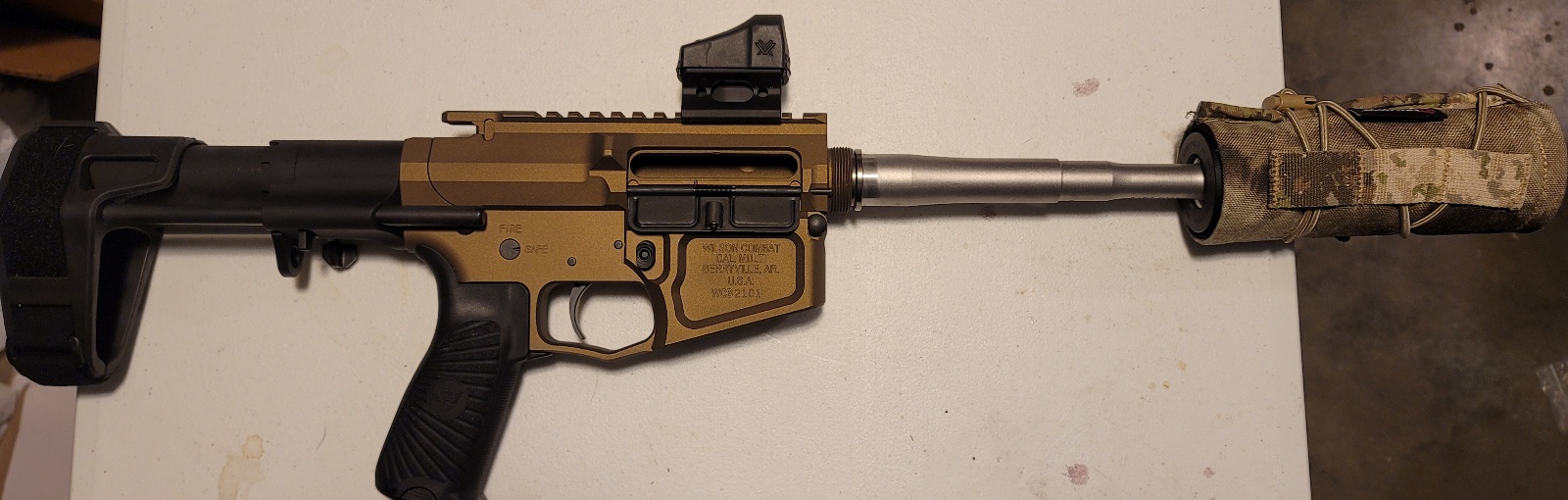

Thanks for your comments, recommendations, and opinions guys. I will post this bad boy once its done. I realize this is snipers hide and we are all about 1 hole 5 shot groups, but this is not the purpose of this build. I just trust you all more than anyone else on the internet for advice even though accuracy is not the key here. Wilson Combat builds are no slouches though in this department! I can easily see this being a 1noa gun even with an 8" barrel... to 100 only.... lol

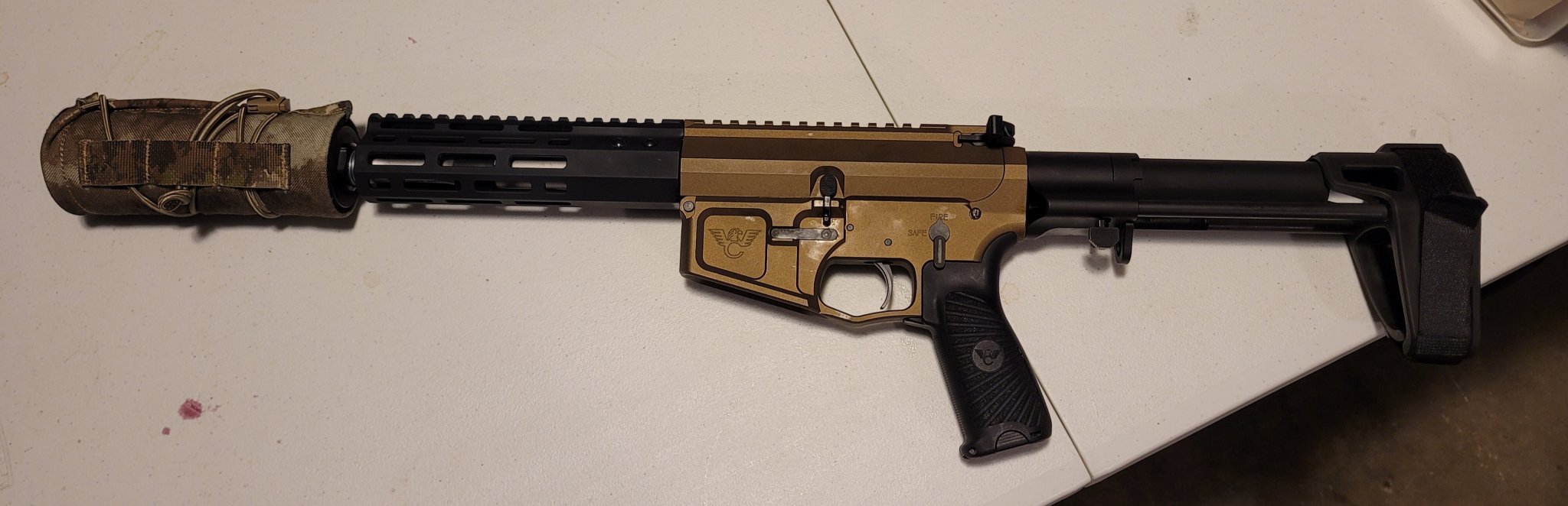

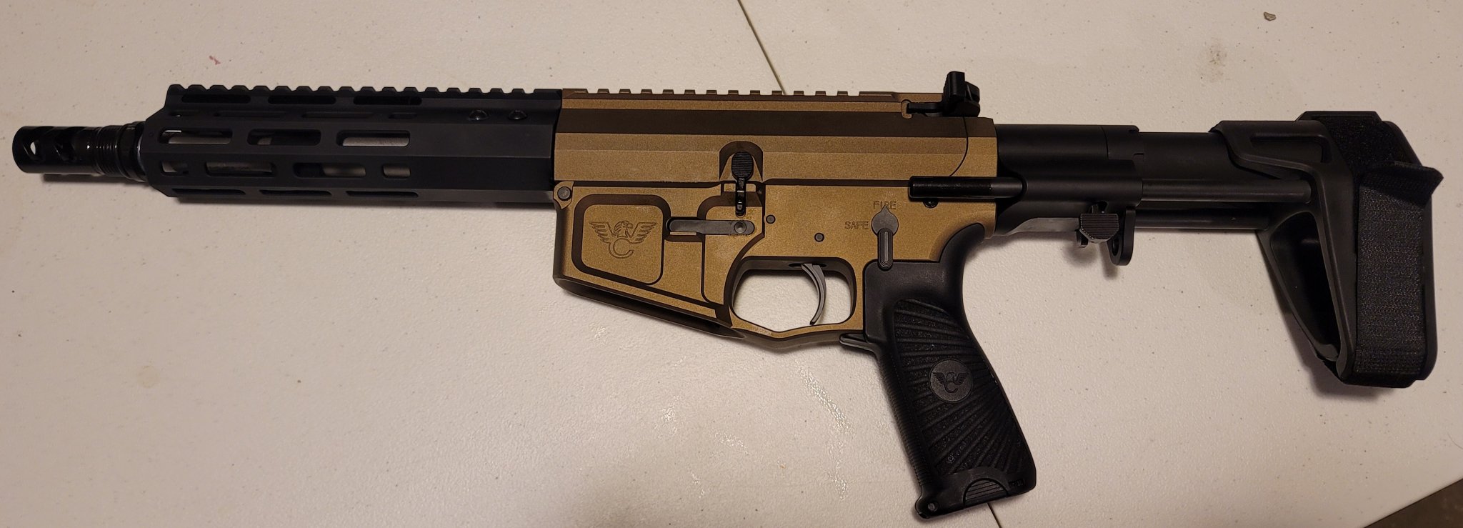

She's coming along nicely. Waiting on the gas block, tube and handguard. I'm not sure if I want to go with a flashlight or buis yet. I'll probably do buis because that tiny Vortex is just that.... tiny. I may slap an eotech on there.
Reactions: darkfader
What makes you say that a can does nothing for a 223? No, it’s not going to make it movie quiet, but it will surely make it more pleasant to shoot. And, that 300 black out isn’t going to be movie quiet either. Dropping the bolt/cycling isn’t exactly quiet, discounting blast flowing back through the opening action...

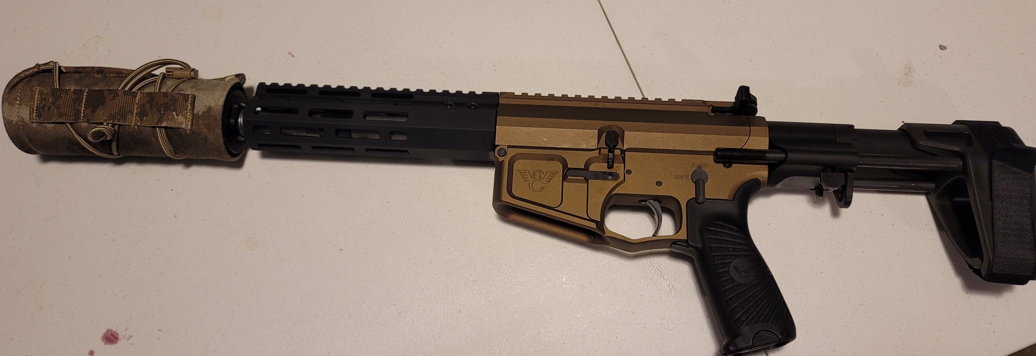

She will fit in my rush 72 with no can and compressed Brace. I'm still deciding on a small Vortex reddot or eotech. I'm still waiting on the failsafe coated TiN bcg as well. I threw one I had laying around in there. She has great action. That 4# WC TTU trigger feels a little heavy. I am gonna swap it with a 3# WC 3gun I have in another build. I'm happy. I'll probably get the handguard armor tuffed to match the sheen of the Upper and Lower. I'm looking forward to some range time with her to see if she will cycle in all 4 modes. I don't ever see the can coming off though... she's really balanced with it. I appreciate all the help guys!
