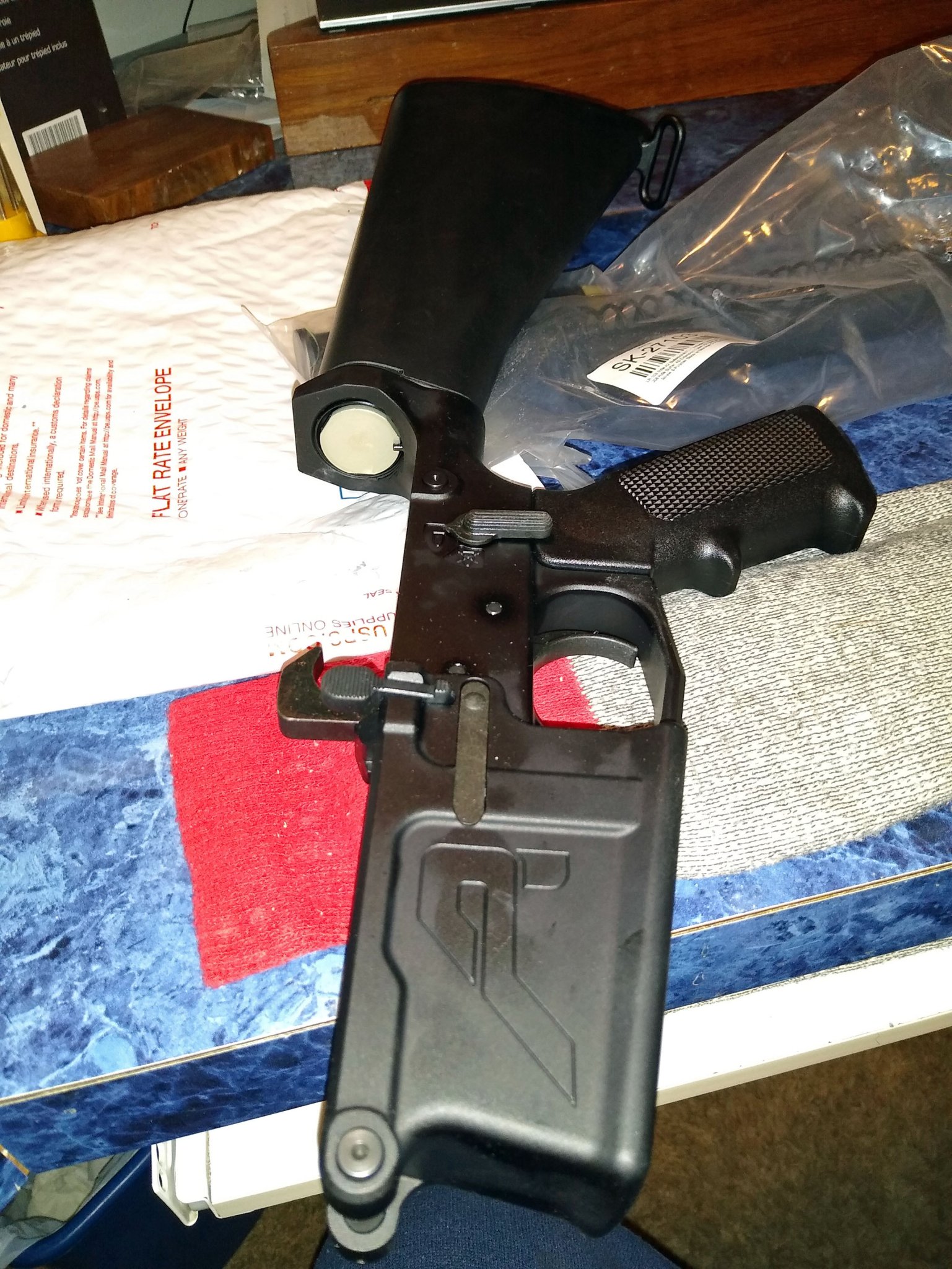

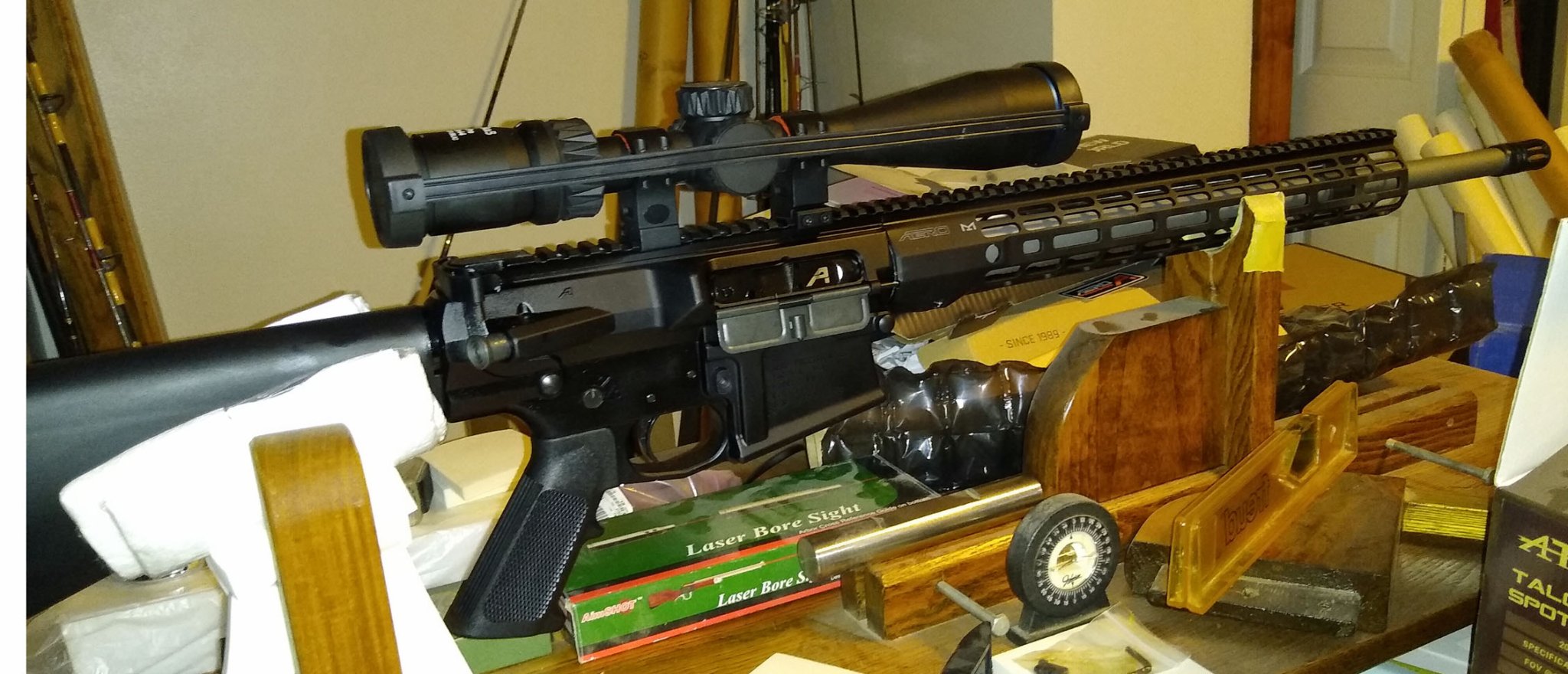

I put together a Dandy 1K+ yd. using a 22" Ballistics barrel Aero platform and it has not disappointed . Personally if I hunted with this Rifle ,I'd limit MYself to 550 Yd. for ethical Kills . Based on cartridge characteristics Not Rifle's abilities . Large Bull Elk or Moose ,I'd stay within 400 Yd. using a Quality 168 Gr. expanding bullet Nosler ,Berger ,Barnes or something similar . BOL .
