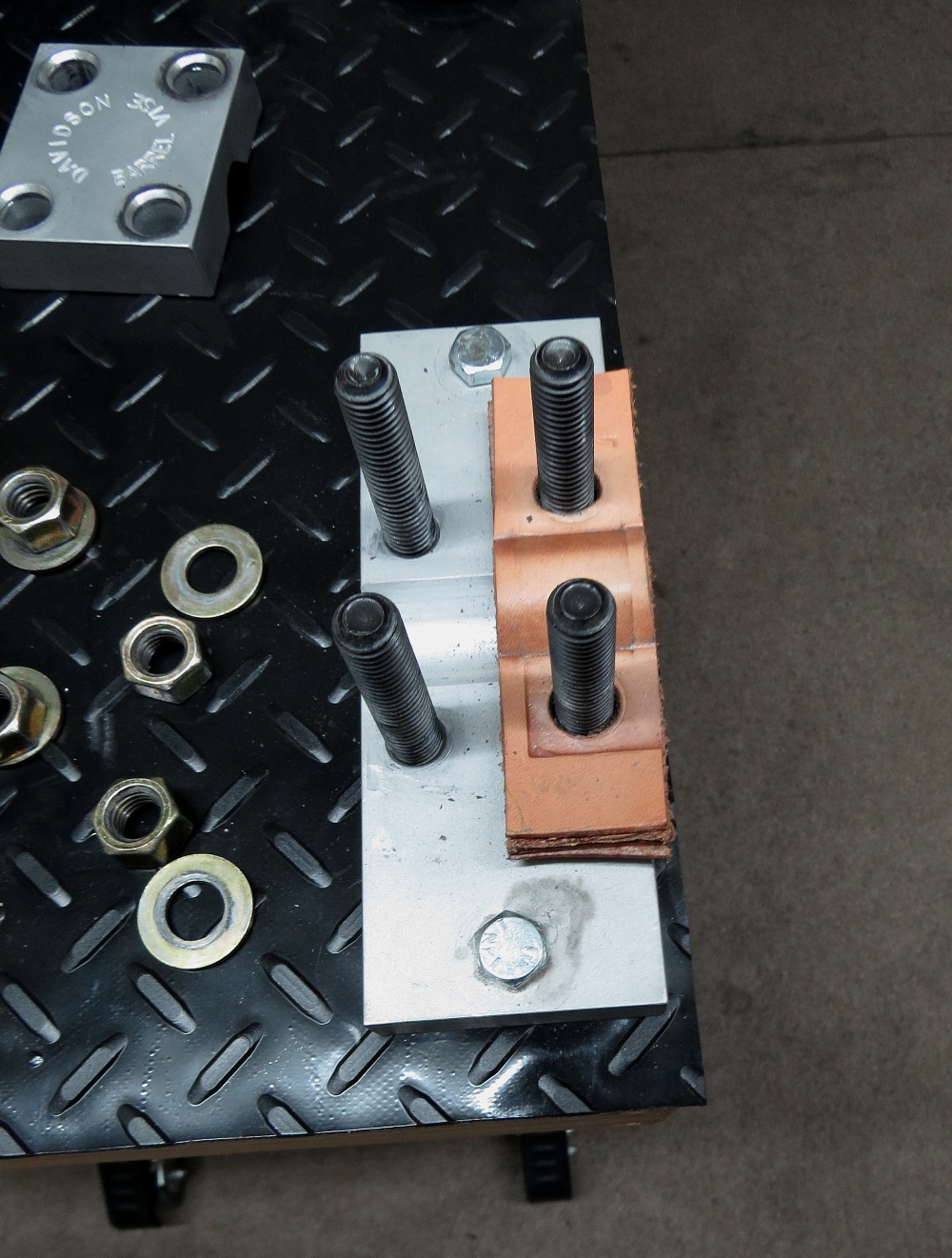

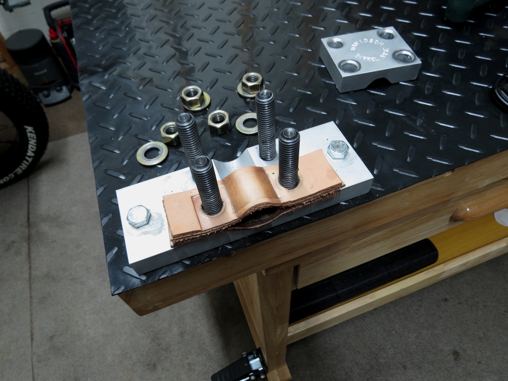

This is what I did with my 4 bolt vise to keep off the carbon fiber.
2 straps of leather stacked for spacers top and bottom and use the front bolts only.
