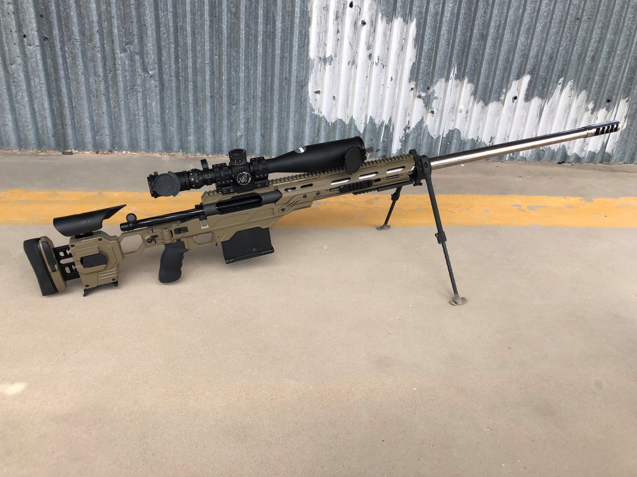

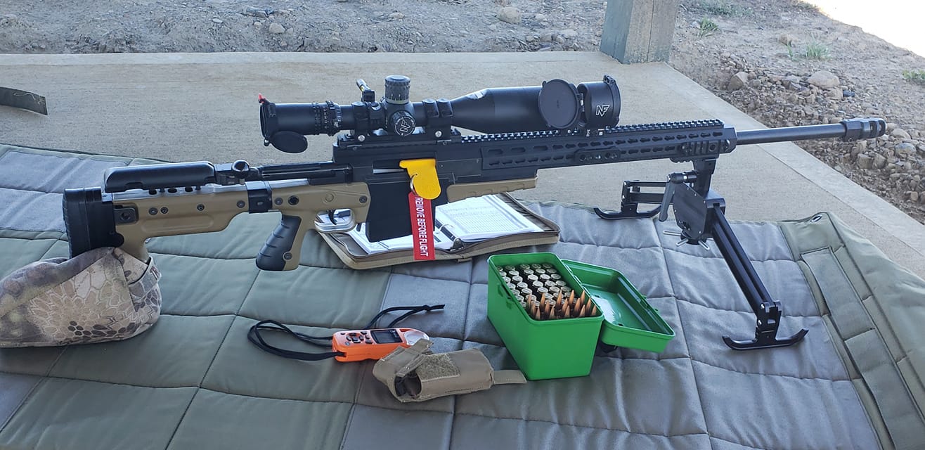

You can order these with Arca. I use one on my 375. It’s solid.
Who sells that Arca rail you installed?
My gun builder fabricated it.
One thing to consider is the amount of torque generated when firing large calibers with heavy bullets. I prefer having the apex of the bi-pod above the barrel since it eliminates a hinge point.

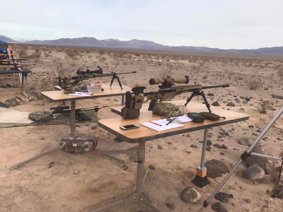

Those are DOA Shooting Bench. The are made in St George UT. We use them for matches and just fun shooting.
The bench in the picture are special order as the are much larger then the stock tops they sell.
I'm in Utah and I need one of those. There's not a single photo like yours on their website or IG account. I emailed them. The 375s and 50s need some extra room for sure. Thanks for the pic --> idea!
