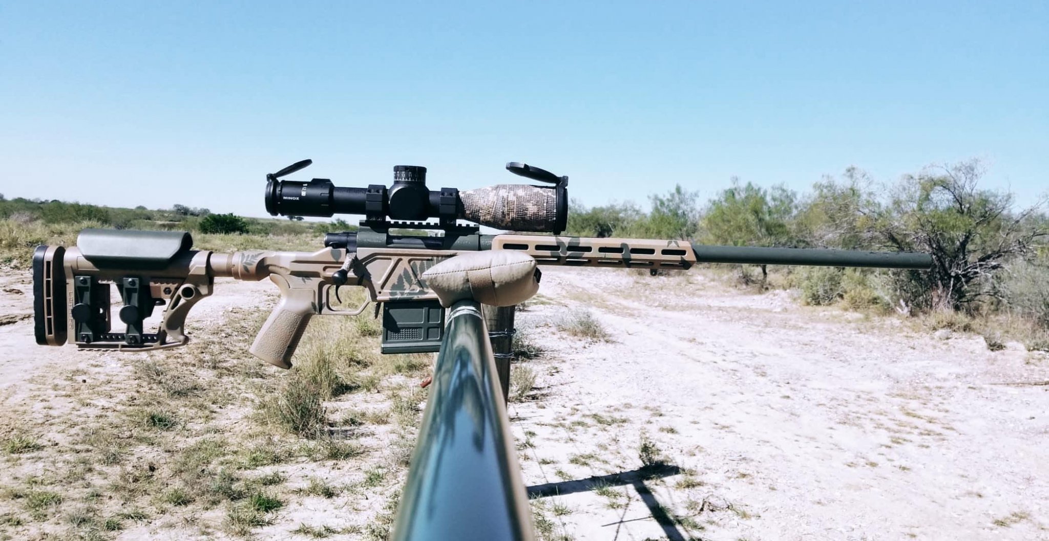

This one is mine...

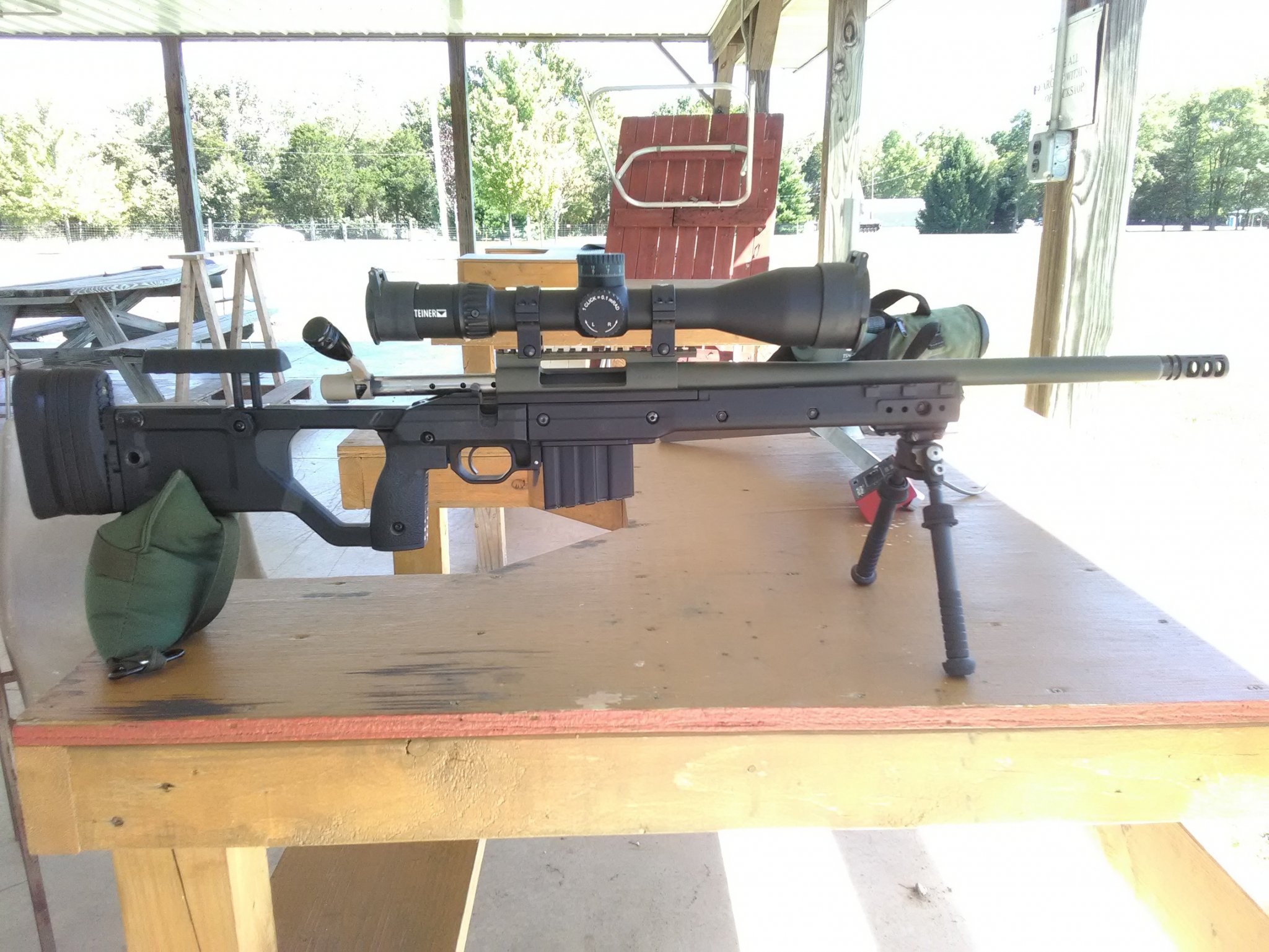

Here is the model of one of the Tikkas in my circle:
My friend has one in 308, and it shoots absolute circles around my Howa/KRG. Easy .5MOA with the same FGGM 175 or 168 (my Howa doesn't like the 168s). Last time we were shooting long range, he hit an IPSC torso target 8 in a row from 830 meters in a decent wind once he walked in the dope. My Howa was doing good to connect 30-40% of the hits. There is just no comparison between the two guns.
