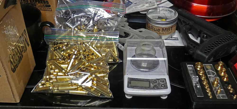

I just got finished 'sorting' out 100 brand new Dogtown 22 Nosler cases to prep.
Just dug them out of the box, got a run of 109 grain cases so I started there.
109 +/- 0.3 into the loading blocks. Ended up with a block of 108.5 +/- 0.3 and a few outside that.
Wouldn't normally sort to 1/2 grain but that's how they fell.
Took no more time than sorting out the extremes.
Bagged and tagged the 108.5 ones for next time.
Now to sort me out some 88 ELDs and some 90 SMKs to do some load work with SB6.5 powder.
With a cheap digital scale, and posted on SH no less :)
