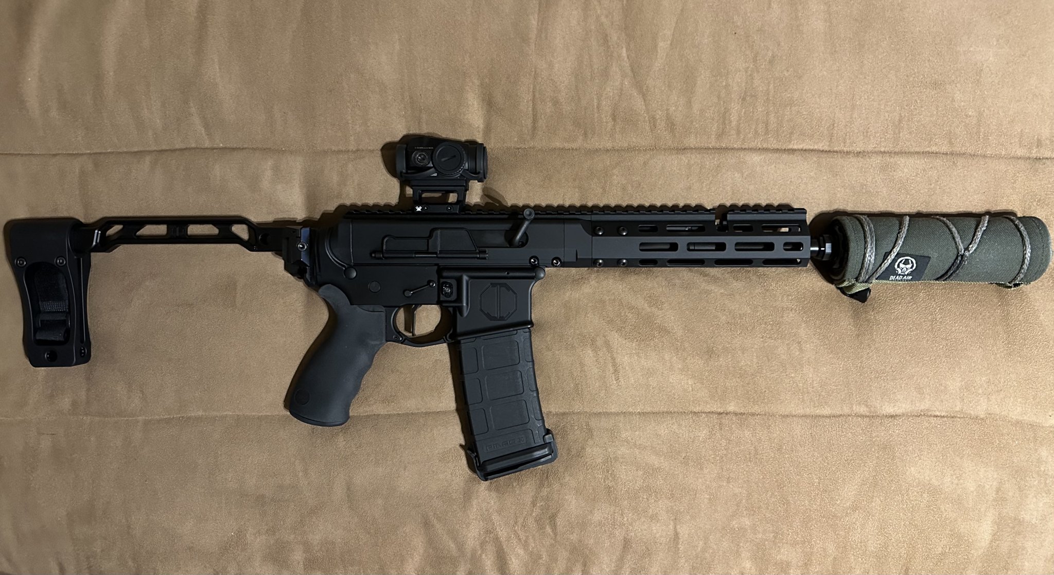

The MCX isn’t as bad as you’d think at all. Mine with a Dead air primal (high backpressure) doesn’t gas me in the face anywhere near as much as my adjustable gas AR does even with a charging handle designed to minimize gas outflow from the CH
