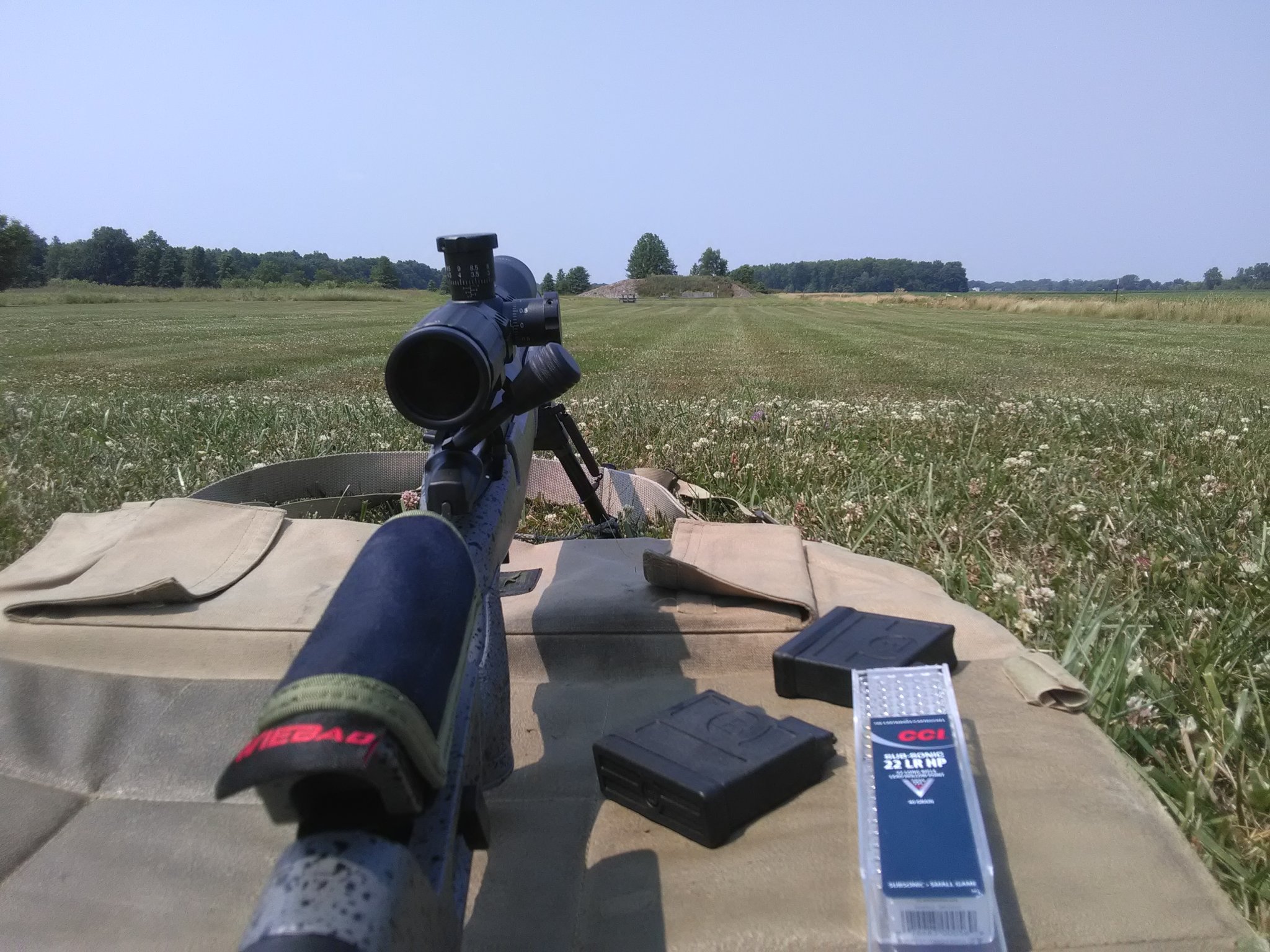

Just bought a B14R to start training on. Actually more excited to get this rig going than many of the center fires I’ve done
6.5 creedmoor
“Abundant” (relative to unicorn farts and unobtainium widget gaskets) factory ammunition and decent barrel life (~2,500 rds)
Less recoil than a 308 Winchester therefore better for spotting trace and impacts.
Most fun rifle I've ever had
At my home range's 300 yard line
I've had it to 400 yards at Thunder Valley Precision but couldn't tell hits from misses because the paint on the plate what shot completely off.
You need the Magnetospeed target flashers at 400+. Even with a dedicated spotter on a scope.
546 yards (500 meters) is my longest hit w/ .22lr. Flashers are a must have at 500. It's incredibly difficult to spot hits that far unless the paint is fresh.
Reactions: Randy Fox

I also agree that shooting longrange 22 rimfire is great practice that many overlook. It's all the same whether shooting 22s at 200, 300 even 500 yards or shooting to 1000 yards or shooting a mile target or really stretching it out to 2 or 3 miles. All use the same techniques and learning to use proper equipment to accomplish the same task. It usually just keeps getting more expensive the farther you shoot but it's still the Indian behind the arrow that makes it all happen.
