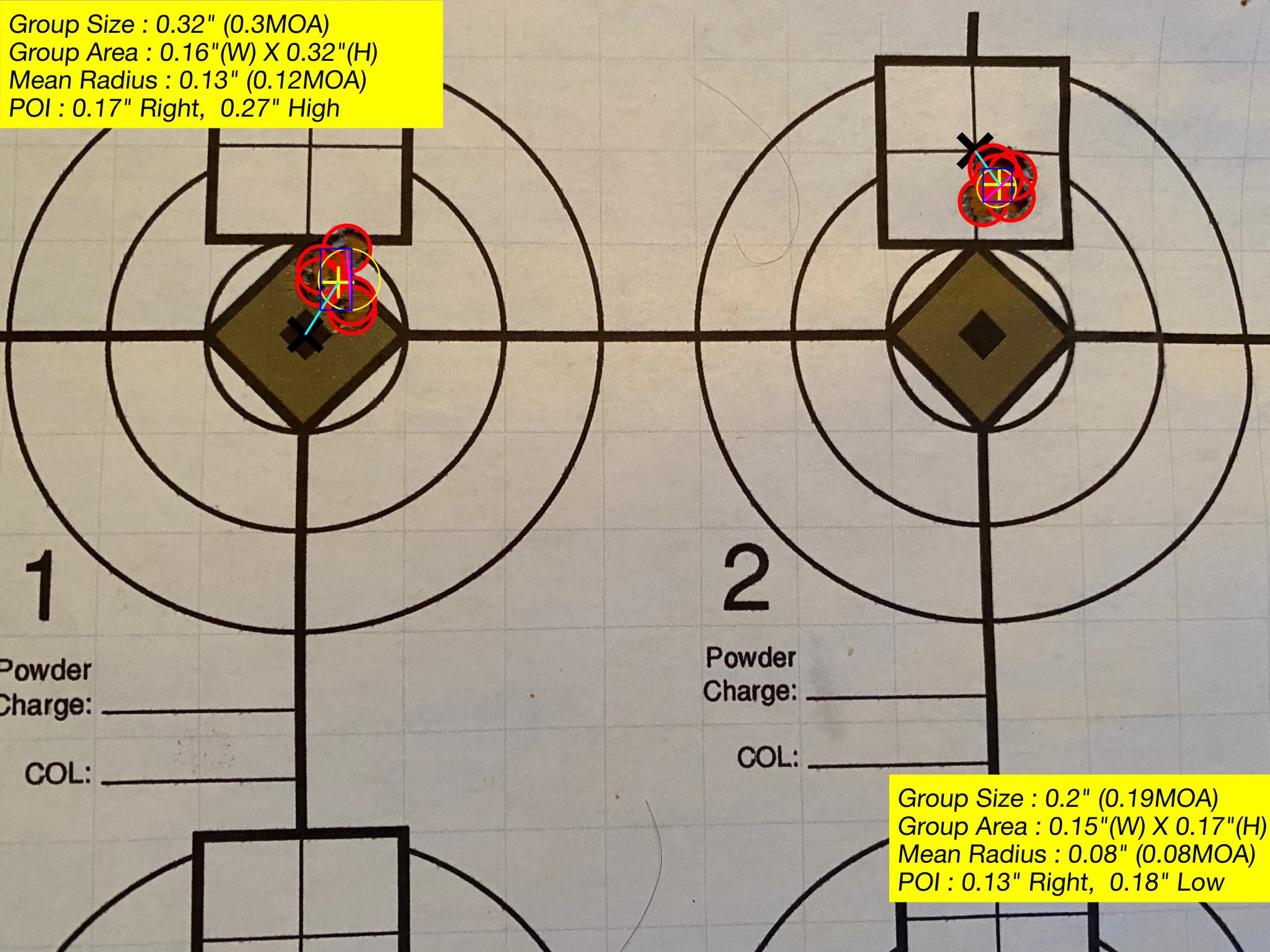

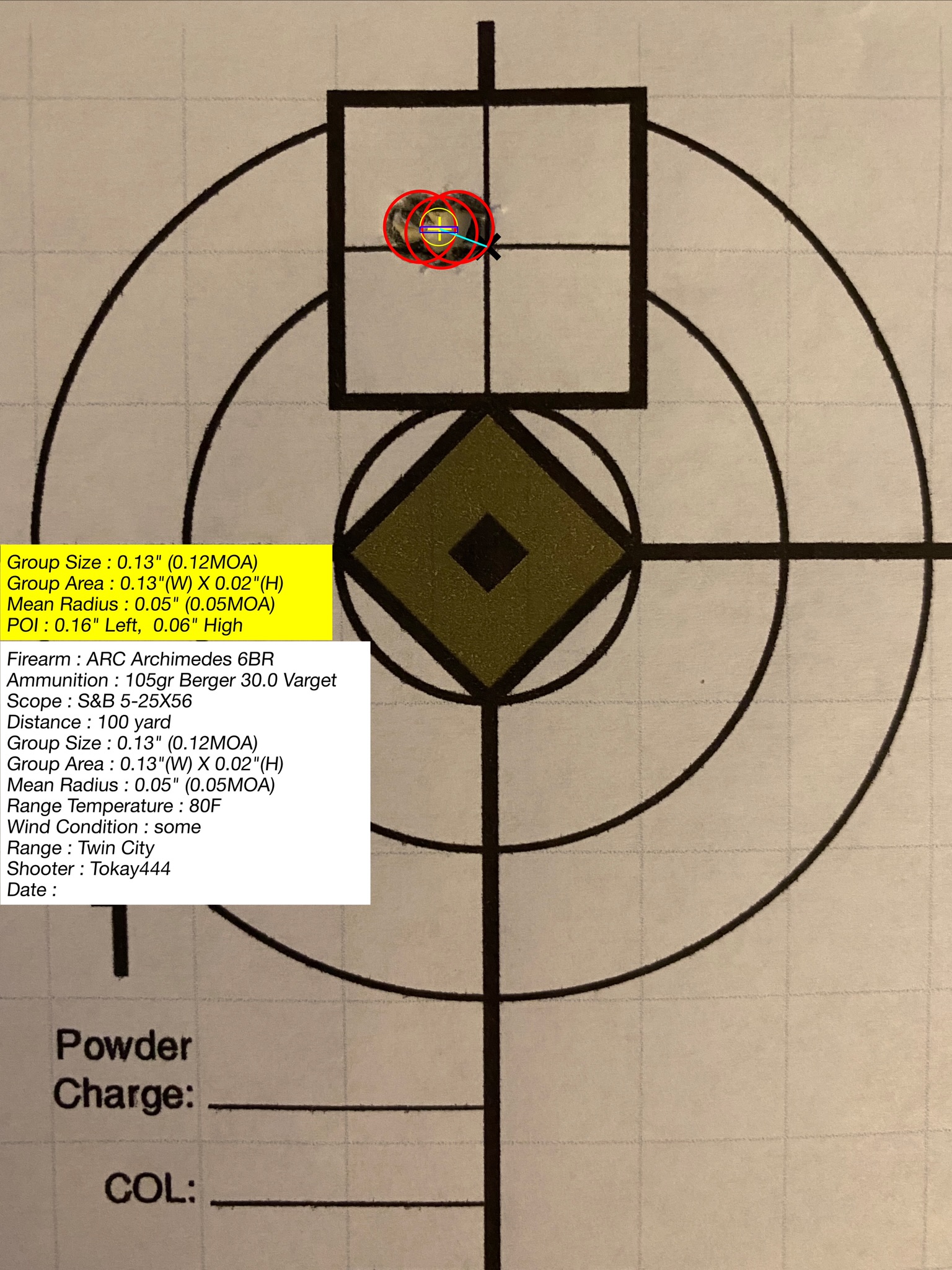

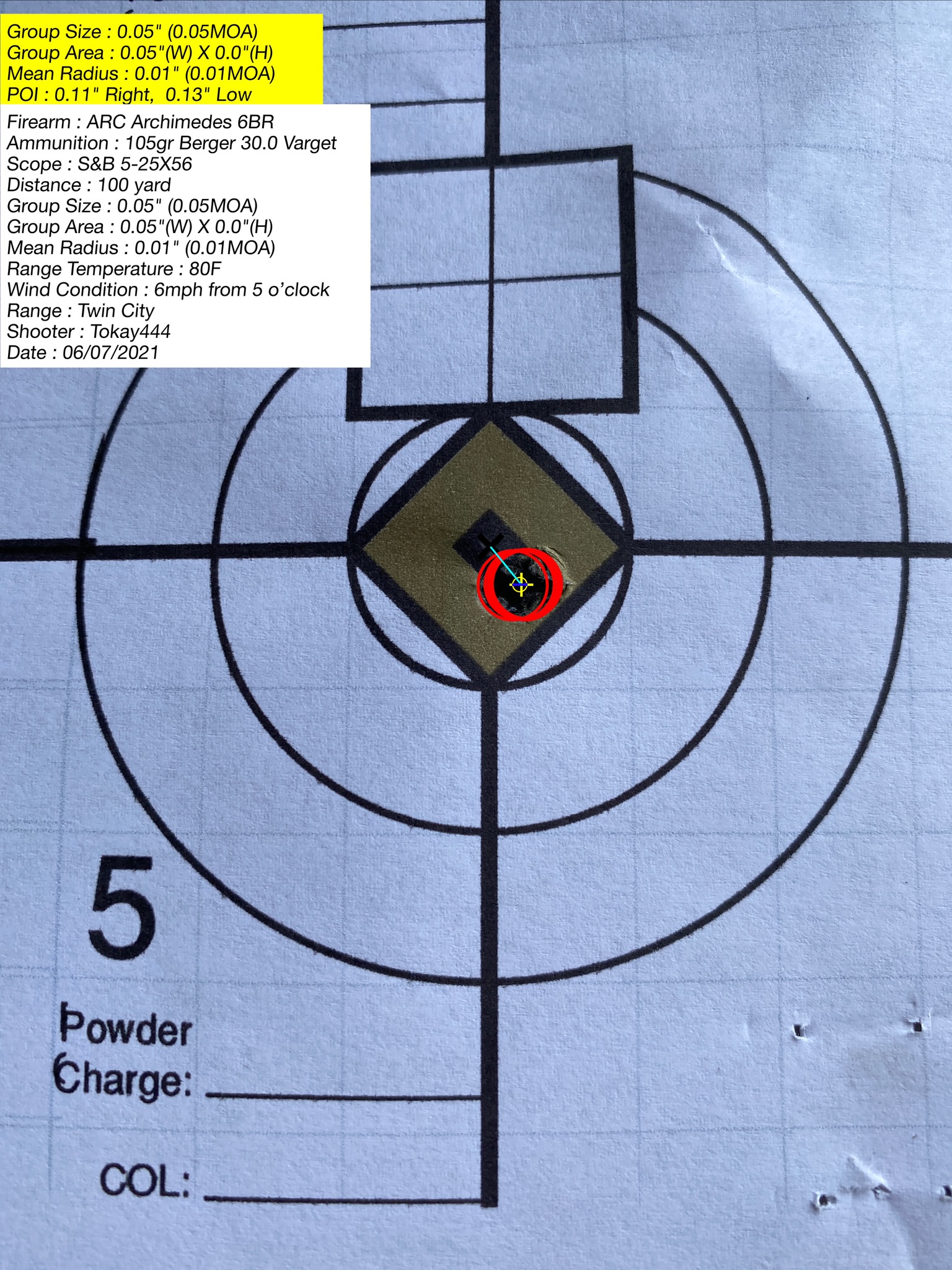

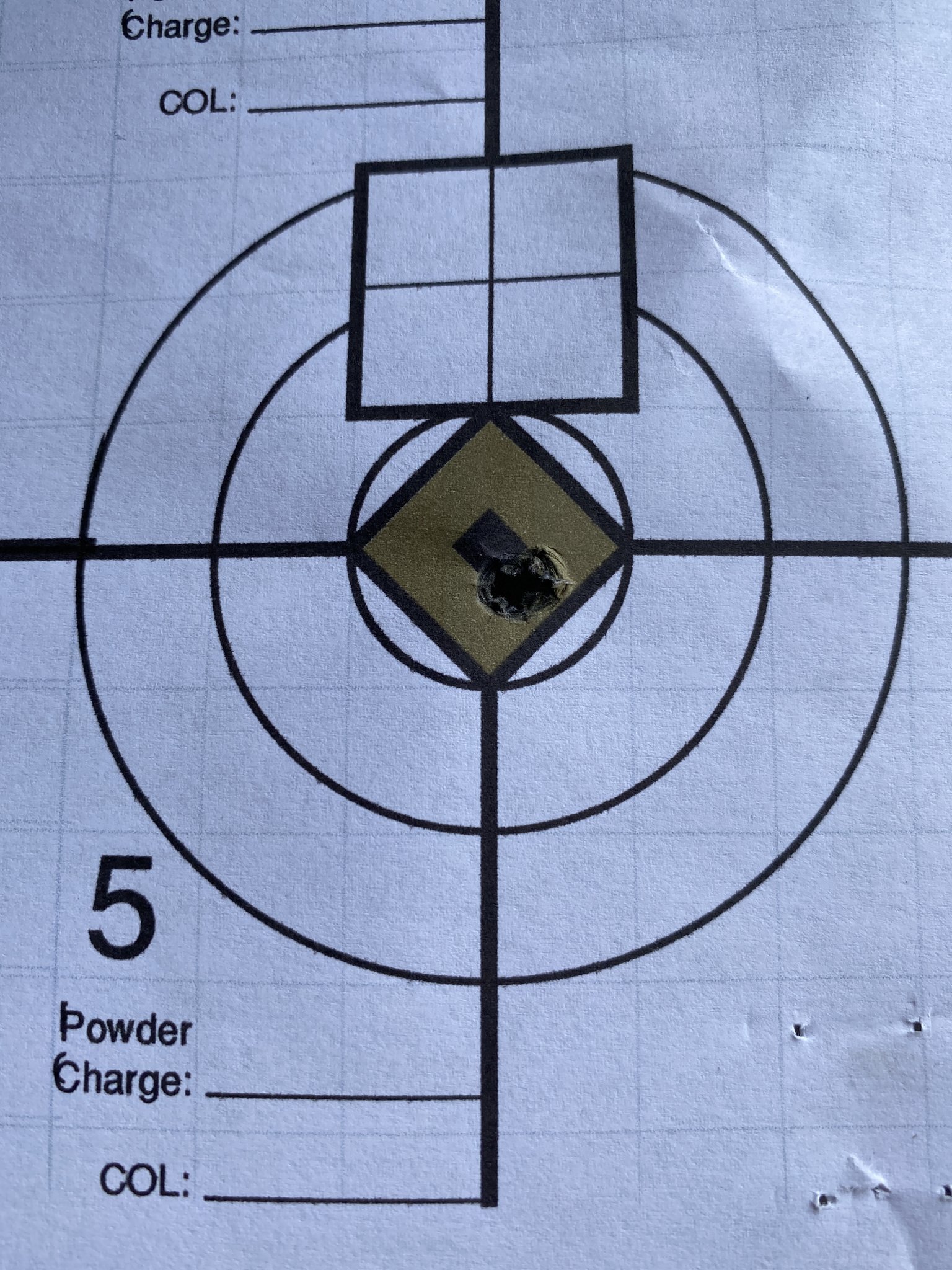

I had KS Arms cut, cut-rifle gain twist, profile, and chamber a prefit for my Archimedes from the ARC tenon print, and it’s an absolute hammer. They make their own actions as well, and sponsor the Canadian F-Class team.
