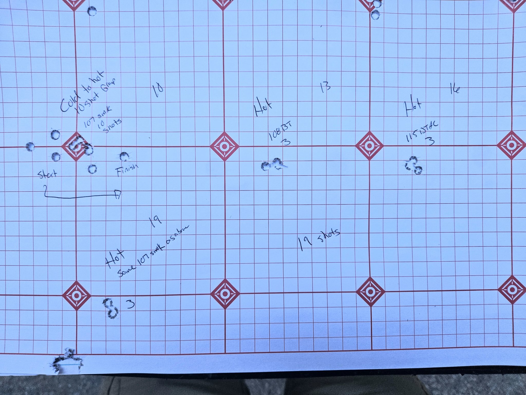

Yeah, this was my issue, ran a 10 shot warm up, shots 4-8 look good, but 9-10 walked more. Then shot 3 more 3 shots groups, 2 of which are a different load, the the last 3 shot was the original ammo used to do the heat up. I repeated this test two more times alternating the heat up load, and the results were the same every time. I think I did a more thorough evaluation than the other guys I know that had walking poi, but I had to know it was truly the barrel and not something else.
Yeah, that’s pretty significant. Did Bartlein comment? How old are these blanks?
All within last 12 months. 224, pair of 6mms, and a 6.5, their comments were they're too busy to get to them at the moment. Ukrainian Jews are taking all their QC time up. Literally said the stuff going on oversees has them too busy to check their bad barrel. I've already replaced the barrel, I'll never touch a Bart barrel again.
That's too bad. It's a little surprising that they won't at least start working with you now to get you squared away, even if it takes them a while.
I have the CFW & a steel blank that they produced in the last 6 months... fingers crossed.

Proof and carbon 6 are close IME, but I've had more proofs than c6. The Bartleins tend to shoot more consistently but are much thicker steel under the carbon and are likewise much heavier for the same contour.
Spot on w my experience… if you are looking for carbon because of weight I’d go w C6 if you don’t care about weight and are just looking for the asstetics, go Bartlein..
