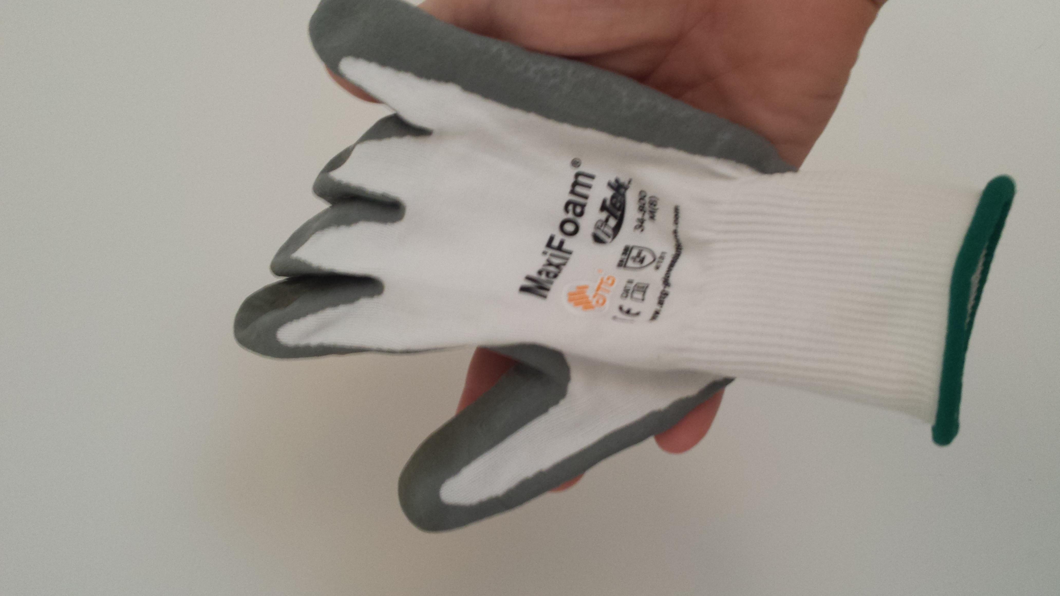

for the price point and what it can do, I'm impressed. I'm using a glove to hold the cases, had this one with the rubber coating and it helps.
