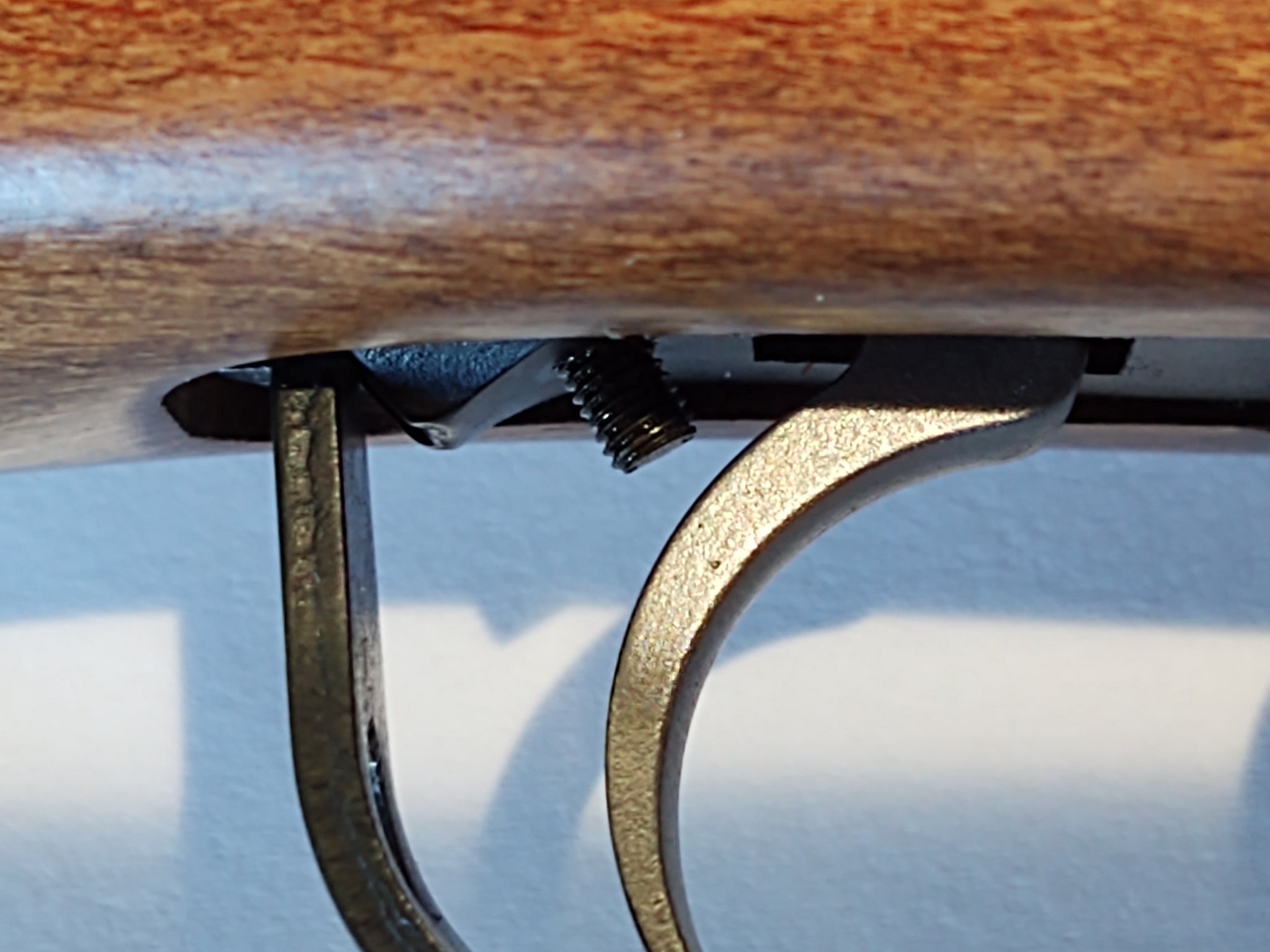

Best thing you can do to the Mini 14 is get a trigger job done to it. Factory trigger is crap. Not much more you can do with the newer 580 series rifles that makes much difference of what it is. This trigger job net me a 5-1/2 lb. then 3-1/2 lb. trigger pulls on its two stage trigger, trigger stop helped a bit too. It shoots 1-1/2 to 2 MOA at best for me and good enough to plink with.
Pic of trigger stop.
