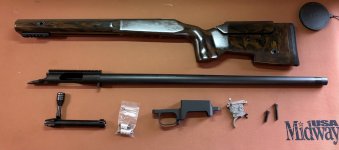

My next build is decided except for choice of calibers. It will be a Tenacity action, mag feed, on the folding version of Manners EH1A stock. The barrel will be 16” - 20”. This rifle will be a paper, crow, coyote, & possible whitetail deer killer. It’s mostly for fun and being VERY accurate. I started looking at the 6mm BR Norma, but have heard of feeding issues. In addition to it I’m looking at the 6mm dasher, & 6mm XC. Quality brass availability is a must. Everything fired in it will be a hand load, but I have no desire to form my own brass. 6mm GT gets some attention, but lack of quality brass is a serious drawback.
I did a search looking at these calibers, but almost everything I found was on a long barrel. I’m hoping several of you have experience loading and shooting these through a short barrel. Thanks for feedback.

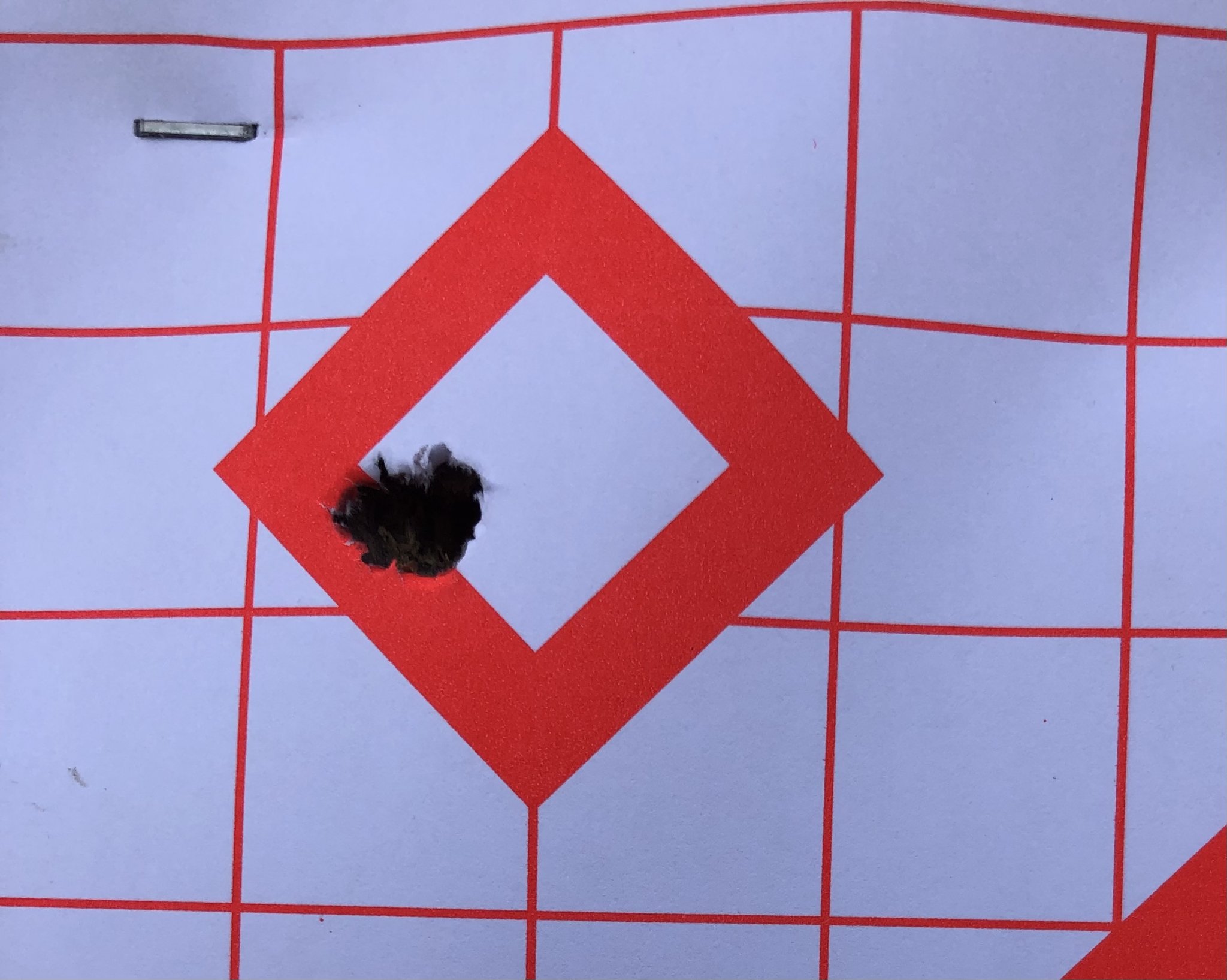

Accuracy is excellent. I don't consider myself a great group shooter and typically shoot less than 400rd centerfire per year due to time constraints reloading, but the rifle is capable of far better accuracy than I am most of the time - sub-half MOA five-shot groups are the norm and on occasion I keep it steady enough to be down into the upper .2s or low .3s. My reloading process is simple - Chargemaster throws 32.4gr Varget, I put it in fireformed Lapua brass, seat a 107SMK or 108 ELD-M to 1.788" BTO, go shoot. Now I never have to worry about the rifle or the ammo causing accuracy issues, only me. Isaac built hammers...

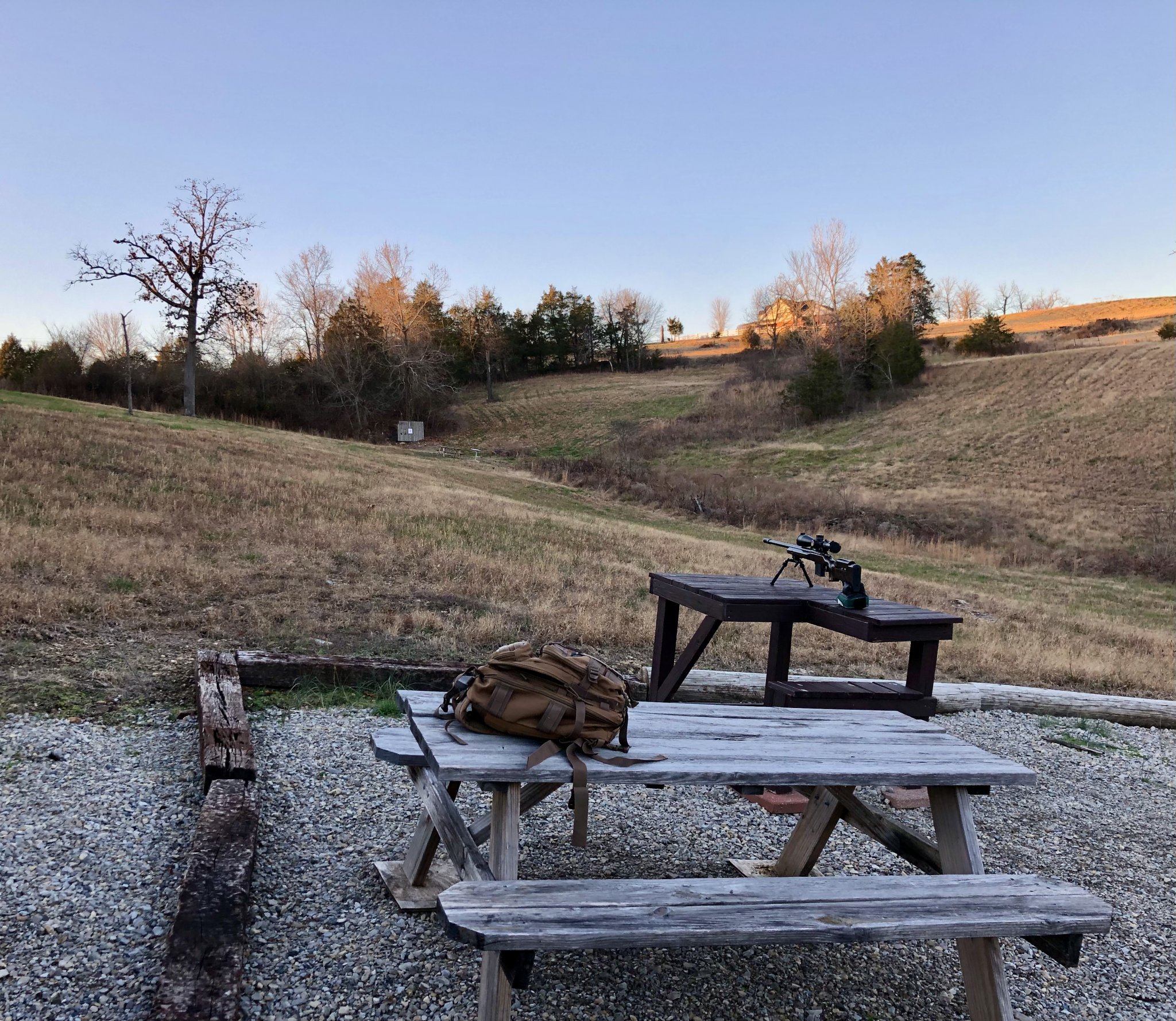

Well since were here anyway....how did it turn out??? @Lynn313
Im looking to build a dasher here soon and velocities on the short barrel and general thoughts on the build by the OP sound intruiging to me now. Would you please share?
The short barrel decision turned into a 24” Bartlein Carbon Fiber MTU. It should be ready within a couple of weeks. It also changed from a Dasher to a 6 GT. After all that I built a heavy PRS type rifle 1st and went with 6 GT. For years I’ve wanted a Dasher because of the inherent accuracy & ease to load for. I had been reading a lot and seen claims of the 6 GT being the same with accuracy & ease to load. It’s a pre-fit Impact action/barrel so if it didn’t work out I could just change barrels. It has turned out to be the most accurate rifle I own. I’m about to start load development. I’ve never done a prolonged barrel break-in, but George Gardner who developed the round with Tom Jacobs recommends 170-200 rounds at a light load 1st. I don’t know why, but I’ve shot 130 at 32.5 Varget. With the light break-in loads I can consistently shoot .2 moa 10 round groups off of a bipod at 104 yds. With 32.5 I’m getting 2840 with 105 Berger. I expect to shoot at ~ 33.5 - 33.8 which is pretty gentle and should run ~ 2950
That rifle weighs 18+ lbs so still wanted a lightweight. With the pre-fit barrels the selection is pretty limited if you want Bartlein. Brian Allen is chambering the CF barrel & putting everything together on the lightweight- CF eh1 stock. I still wanted a dasher, but have extra brass, already have dies , giraud case holder, amp case holder, etc for the 6 GT so the lightweight will be 6 GT also. If I get same accuracy as with the heavy rifle I will be very happy.
pics are from 1 build. 10 shot group

How did you decide to go 24 instead of keep it short? Was it suppressor related? That rifle looks like it shoots like a dream
i didn’t want to give up the velocity. I’m thinking about buying a can for 22lr & 1 big bore one day, but I don’t own a suppressor now. There’s bluffs along river around here where you can set up and see vermin 500-1000 yds off. Also, got to thinking the 24” CF with the eh1 cf stock wouldn’t weigh much more, if any, than the 16” SS.
In all honesty it’s probably being a retired old man changing his mind as much as a kid in a candy store. There’s probably not a lot of logic that went into it. I am happy with my choice of the 6 GT. I used to think I would never compete, but now have joined a range and planning on some local comps just for fun. The heavy 6 GT will do for prs & I have a lightweight 65 PRC that will do for the hunter series.
I wish I could have given you a better answer. Maybe since where I’m at having an extremely compact truck gun wouldnt see much use. If we see a coyote while driving, it’s gone before you can stop and get out. So I can probably do everything with the 24” that I can with the shorter one and have more hp. It’s been awhile since I bought the blank. It might be a 22”. When Brian Allen finishes I’ll post pictures.
I missed you were referring to the rifle in the pics. Yep……it absolutely crazy accurate. It’s what’s led me to wonder if “any” gunsmith can build better than the pre-fits by Impact Precision. There will always be a need for good competent gunsmiths like I used Brian for my lightweight. They keep their tolerances so tight & I’m guessing thier business model is based on just producing the barrels / cartridges in high demand. That way they can program their machines and run a “batch” before reprogramming. If they have what a person is looking for I don’t think thier quality can be surpassed. The group in that pic is 10 rounds shot off a bipod with me in a hurry. They were just break-in loads. I took this time to pass it on because I’ve never seen anything shoot like that. If I had been shooting a developed load off a rest it would be entirely different.
