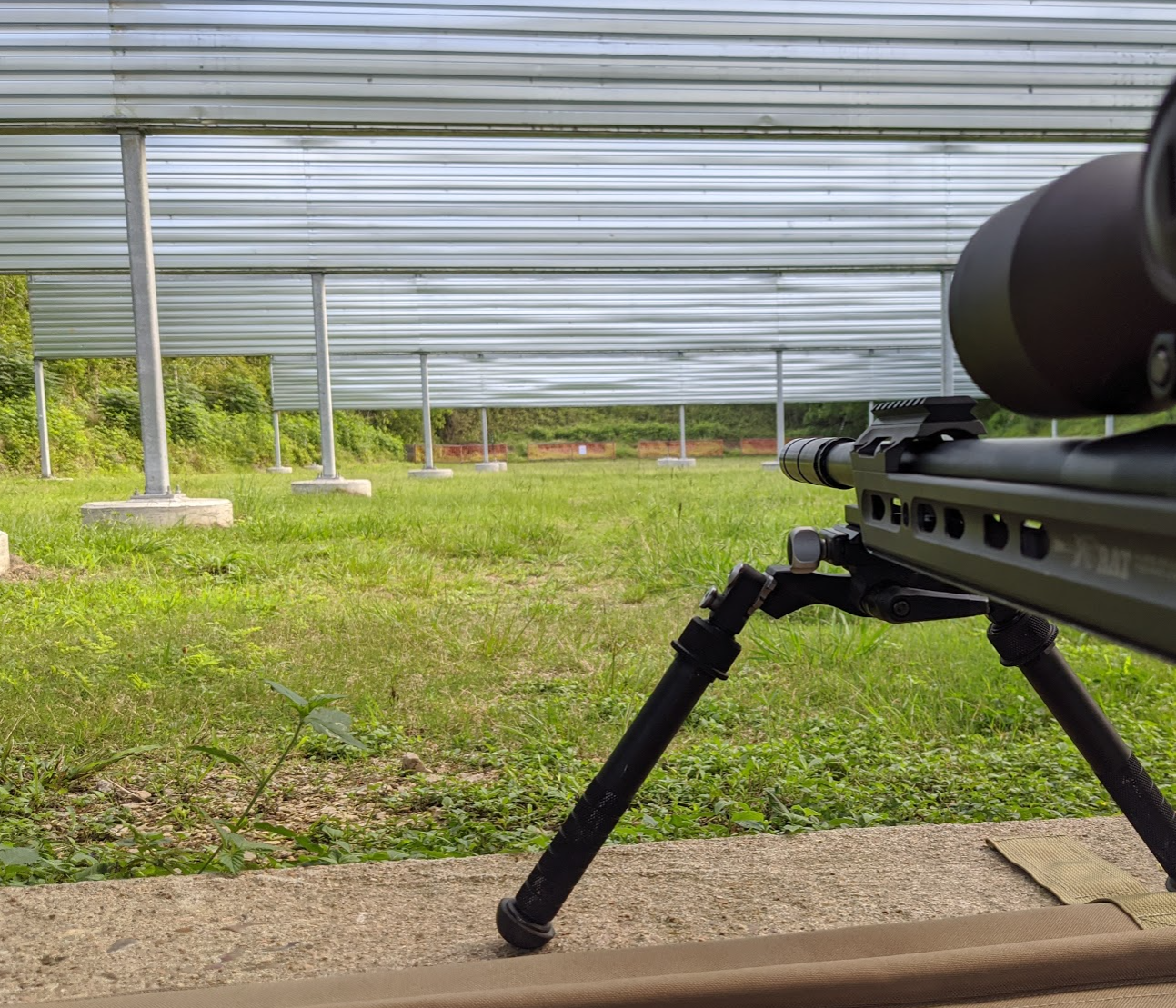

Trees about 100ft away from me on both sides. No clutter otherwise.
Labradar is mounted on a strong tripod with the external trigger on the pict. rail. I've used the straw for aiming, placed the device close to the barrel in positions both behind the muzzle brake and in front. Sometimes it will be working, then just stop taking readings with no change in location of the device. It's been a real frustrating thing to use.

Sounds like you are doing the right things, especially aiming. Does the unit give a failed to track error or just no response at all when it stops reading?
Yes to both of you questions 6.5. (I should also add that there is an MRAD muzzle brake that directs the blast to the rear, and I am shooting paper target on plywood. No steel for tests). I can shoot the first round and it will record most of the time, maybe even get it to record some other shots. All of a sudden, it will either stop recording with the screen no longer highlighted, or it will give failed to track error.
I've even seen it recording 2 or 3 successive shots, then I go to move the gun after recoil (to the same spot on the bench) and it will generate some totally b.s. number without a shot being fired.

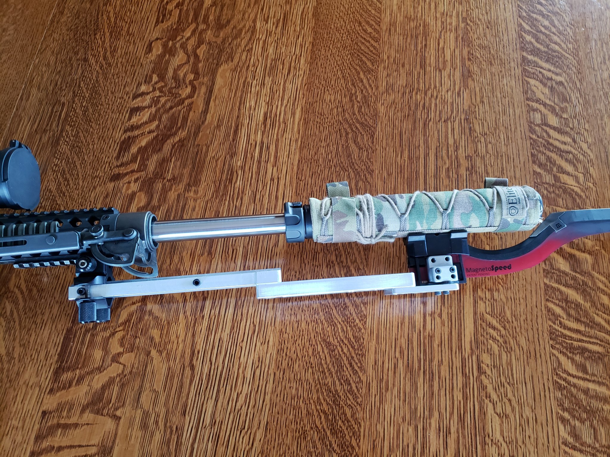

Hear is my solution to the issues people have with the Magnetospeed. I use this with and without the suppressor, and on multiple guns. It is solid and does not touch the barrel or suppressor. The Magnetospeed is much simpler to use and extremely reliable with this setup. It does not shoot loose like it did with the strap. Lab radar is an extremely nice tool, but is more difficult to use, has it's own quirks, and is not as easy to carry with you as the Magnetospeed.

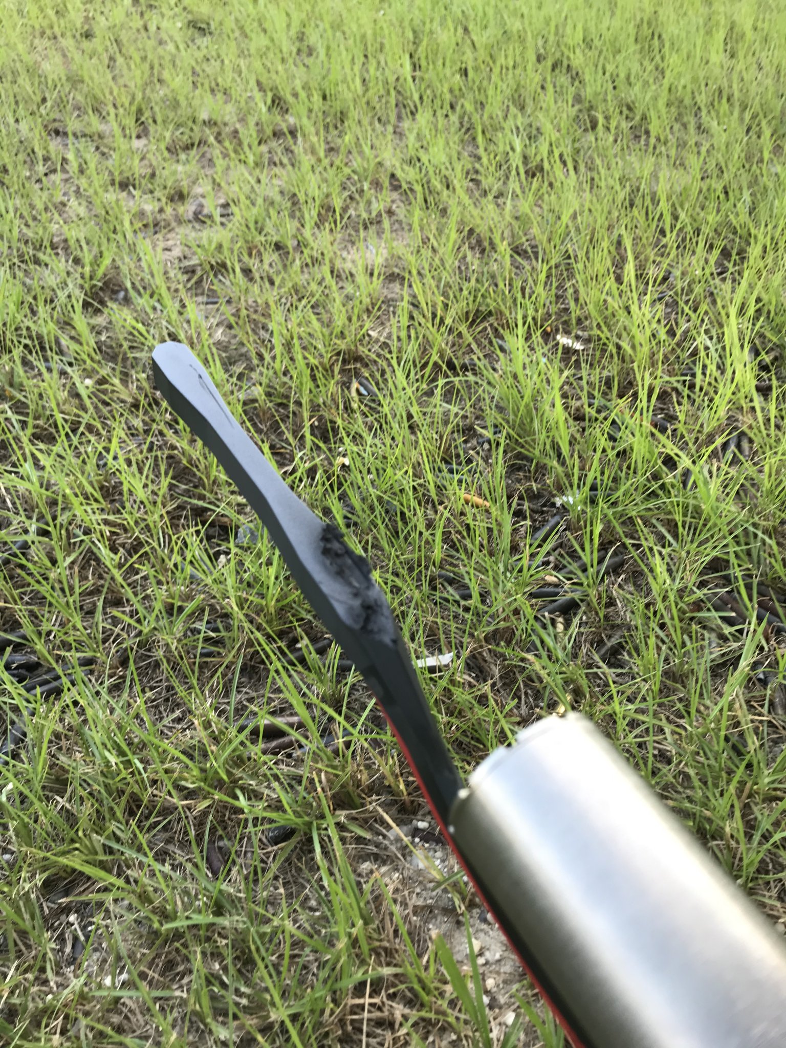

I'm on my second Magnetospeed and am very happy with the brand and performance. But......tried strapping my first one to the monster brake on my RPR 338 Lapua (brake's too long to overlap it), and the recoil blew the thing apart. Probably my bad, ya think? So I'm using book speeds for my Strelok until I figure out where to chrono the thing. Good luck!
Yikes! I'd say you need the Wiser adapter or something similar to get the bayonet out in front.
