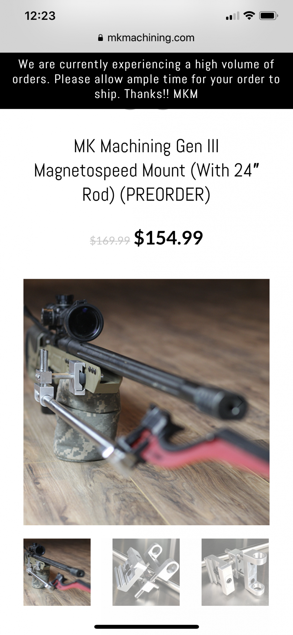

Magnetospeed all the way. If you're a load development Nazi get the off barrel mount MKM makes.

I love my Magneto Speed "Sporter" it is great. I am wanting to find an off barrel mount. Problem is that it is for an old Remington mod 700 3006. No Pik rail, only the forearm bolt for the sling.. Currently has a bi-pod attached... Any suggestions??
