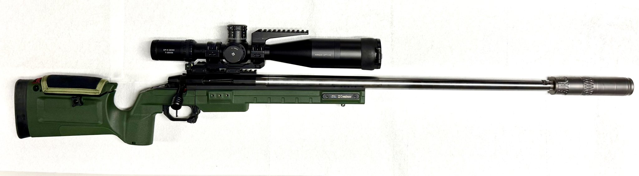

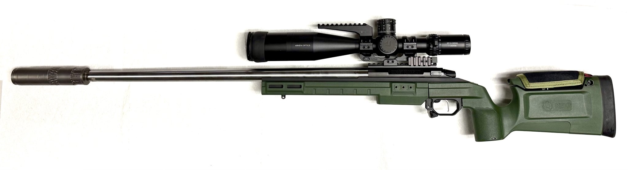

I built a custom 22 Creedmoor on an Impact Precision 737R action, housed in a KRG Bravo chassis in Sako green. Features a 26-inch 1:7.5 twist MTU stainless 5R hand-lapped barrel from Preferred Barrel Blanks (probably should have gone with a 22 or 24-inch barrel). Suppressed with a Rugged Alaskan 360 Ti. Equipped with a TriggerTech Diamond trigger and an Area 419 Cantilevered Tactical One-Piece Scope Mount. Optics include a ARKEN EP-5 GEN II 7-35X56 FFP - Illuminated VPR/MIL reticle.
