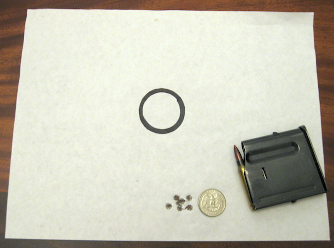

CZ 527 is 1:9 twist. Steel detachable mags (5-round). No plastic anywhere (unless you get the synthetic one). Good fit-and-finish and a fully adjustable trigger with a set-function too. Groups well enough for me. The group below was the first 7 rounds out of a new gun using 69SMK blems and random milsurp brass load I threw together:
The 527's magazine doesn't allow much more length than 2.335" if you're thinking of using less-stubby projectiles.
The Howa's metallic parts are actually a great deal for the money. The plastic stuff is a turn off to me. The aftermaket has better stocks and accessories though (magazines are 10-round but plastic).

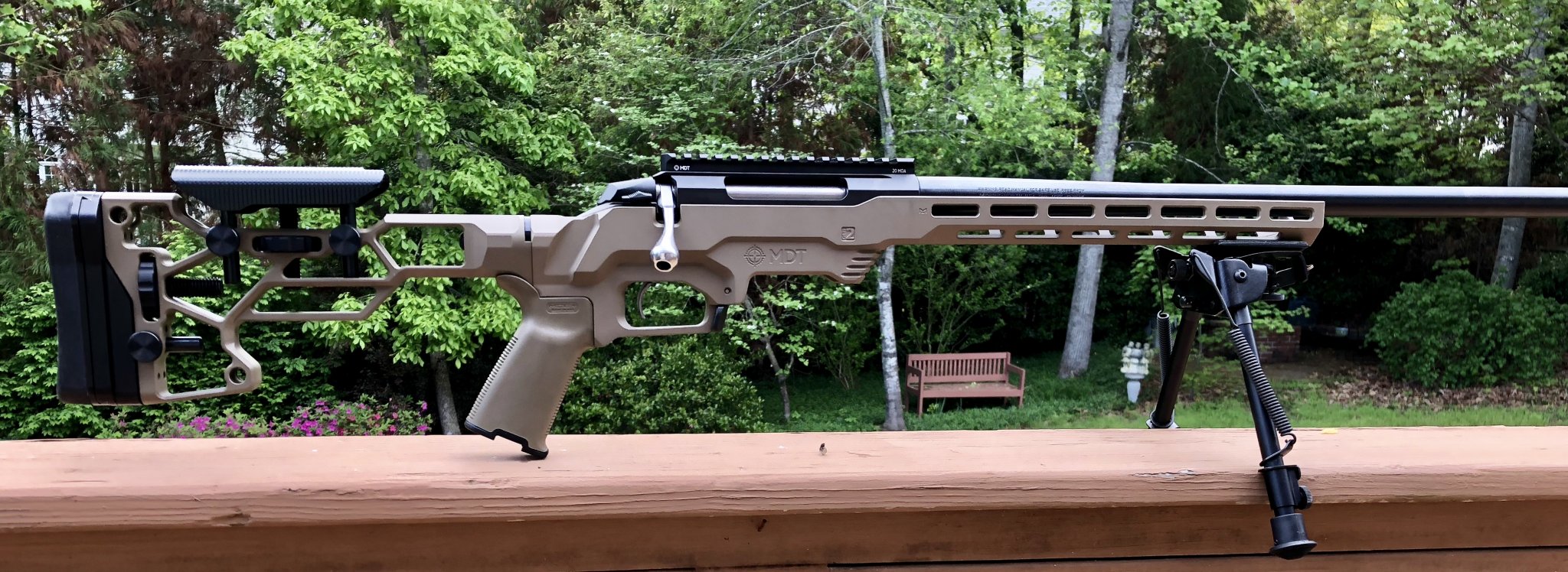

A vote here for Tikka T3X Varmint. Mine is in an MDT LSS Gen-2 chassis with the MDT Skeleton stock and 20MOA rail., using MDT polymer mags. I shot a lot of Defender .223 69gr SMK ammo out of it until I discovered that Defender 5.56x45 77gr SMKs (Mk 262 clone) work better. Of course, liability and lawyers being what they are, it has to be said that 5.56x45 ammo is loaded to higher pressure than .223 and may not be safe in a given .223 rifle. I don't handload .223/5.56x45 yet... but even with the short-loaded, mild factory ammo, it's a 3/4-MOA rifle. I'm also considering selling it... it's a year old, after all... but if I don't I'm sure handloads will make it a 3/8"@100 rifle without much effort.

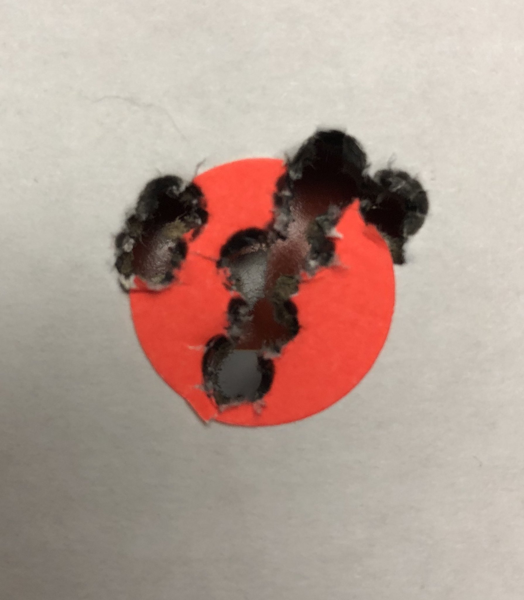

The 10-shot group below is typical of the Defender 69gr SMK on a 3/4" dot at 100 yards. The 77s do about the same but hold velocity farther out. Interestingly, the 75-grain Hornady Steel Match ammo mentioned above does not do well in it at all... surprising given how well it did in my now-gone DMR-variant AR...

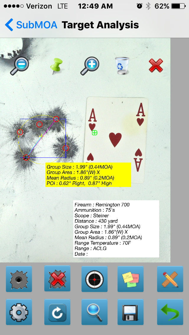

20" factory 1-9 twist shooting 75's, it's even the rr prefix Rem 700 that everyone loves to hate. Here's 5 @430

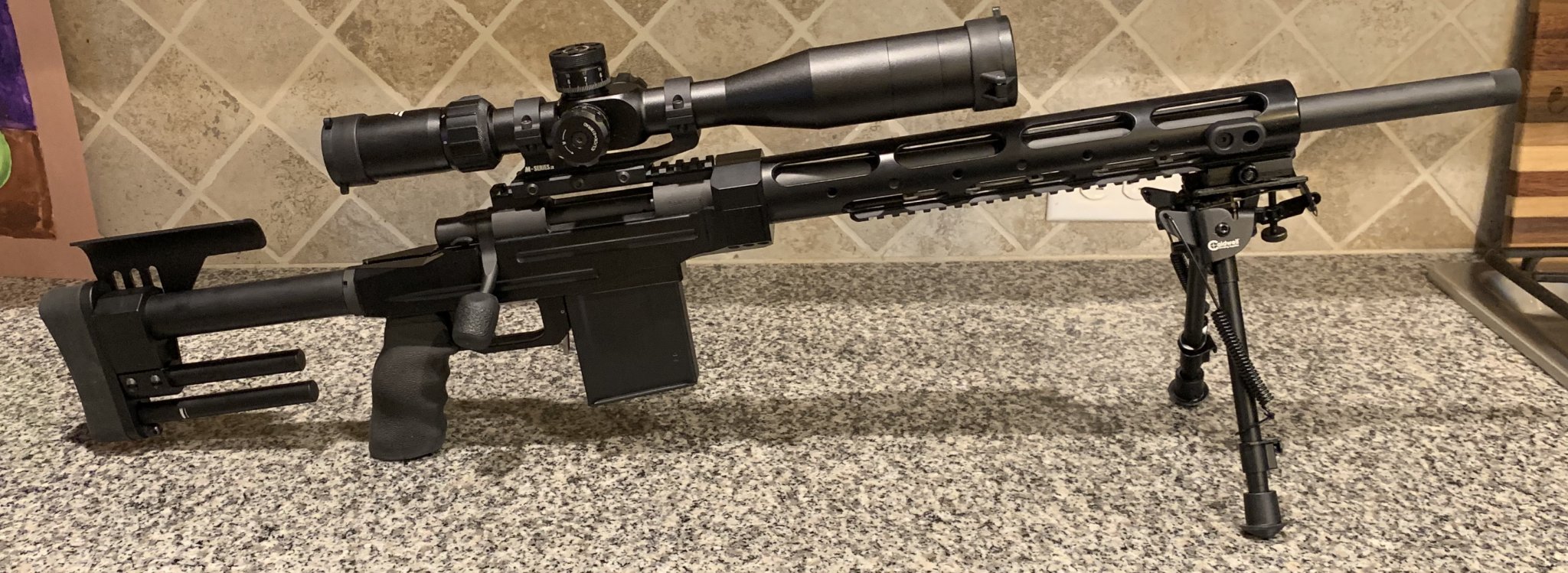

Just got this put together for the wife. It’s a 20” Howa short action (not the mini) in .223. It’s wearing an XLR Evo chassis that I picked up off the PX. If I hadn’t come across the XLR, it would likely be wearing a KRG Bravo.
7073454
ETA: that rigged up Caldwell bipod B.S. is outta there as soon as I can get an Atlas CAL ordered up.
